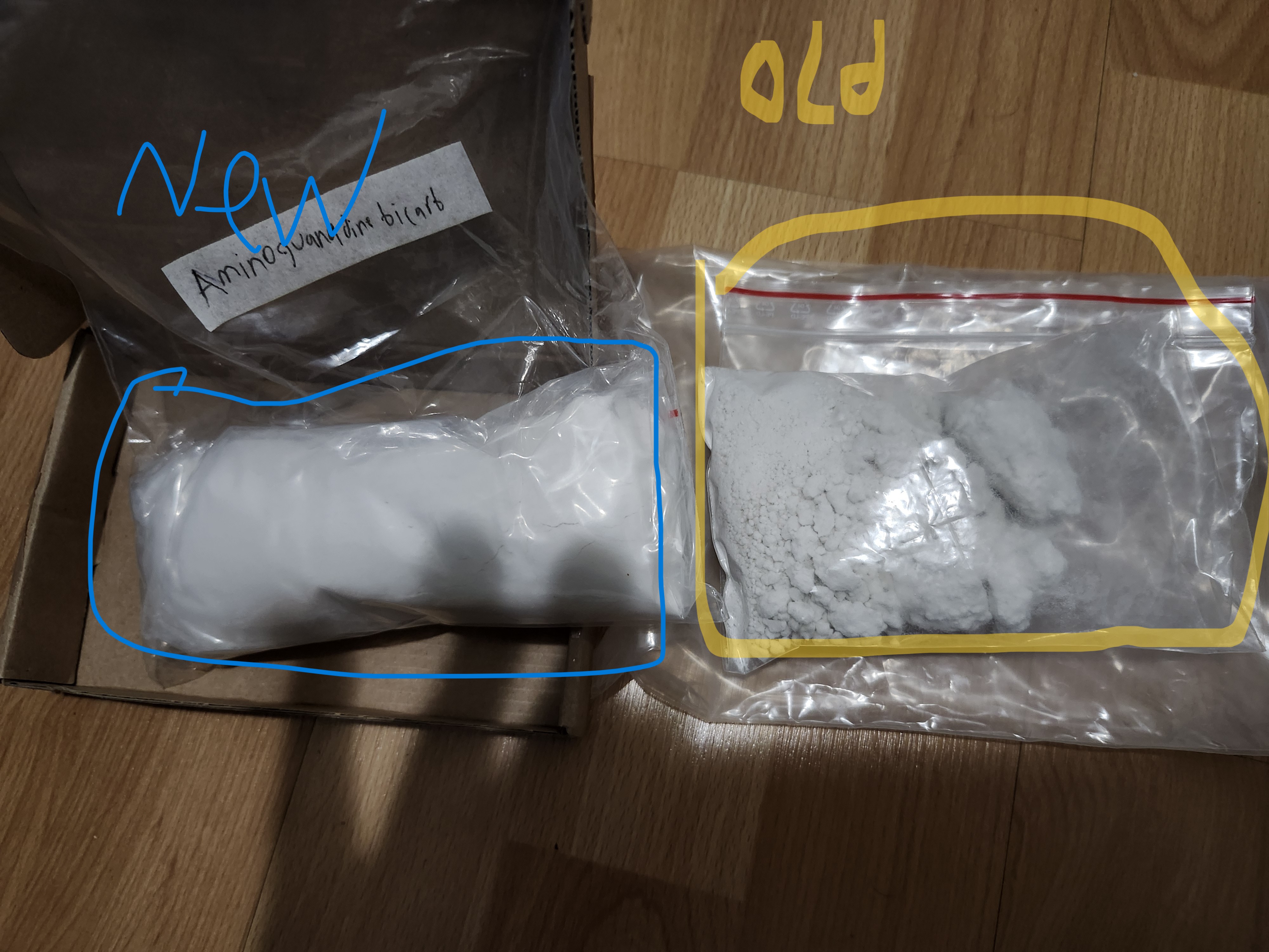

ManyInterests
Posts: 1038
Registered: 19-5-2019
[*] posted on 29-1-2025 at 14:18
I decided to buy more aminoguanadine bicarbonate and... I noticed something. There is a significant difference in texture and color between my old purchase (which as far as I know has not changed since I got it some 2 and a half years ago) and the new one.
I pictured my stuff below and marked them. The fine white powder is the new purchase, while the one to its right is the old, it is chunky and not necessarily entirely white.
I won't be able to make another synth for another week or so, but if I make another synth and it all works out fine then I will be one very unhappy mad scientist... I almost bought from my original supplier, but I am glad I didn't. If it works I will buy another from the same guy I got this batch from and it should be happy, if a little poorer.
I hope the original ammonium perchlorate supply I have is good. Or maybe I will just use some of my lithium perchlorate (I don't think I'll be making Lithex, LL. sorry...) to make more confirmed ultra pure stuff.

Axt
Posts: 979
Registered: 28-1-2003
[*] posted on 29-1-2025 at 22:06
My aminoguanidine is a buff coloured clumped fine powder that's spent 20 years in a hot tin shed. It works fine. Your problem is almost certainly your perchlorate.
Bis(aminoguanidine)nickel(II) bromate (NAB) is not stable. The two week old crystalline sample is now an inert brown powder. NAP stored the same, is fine after over a month.

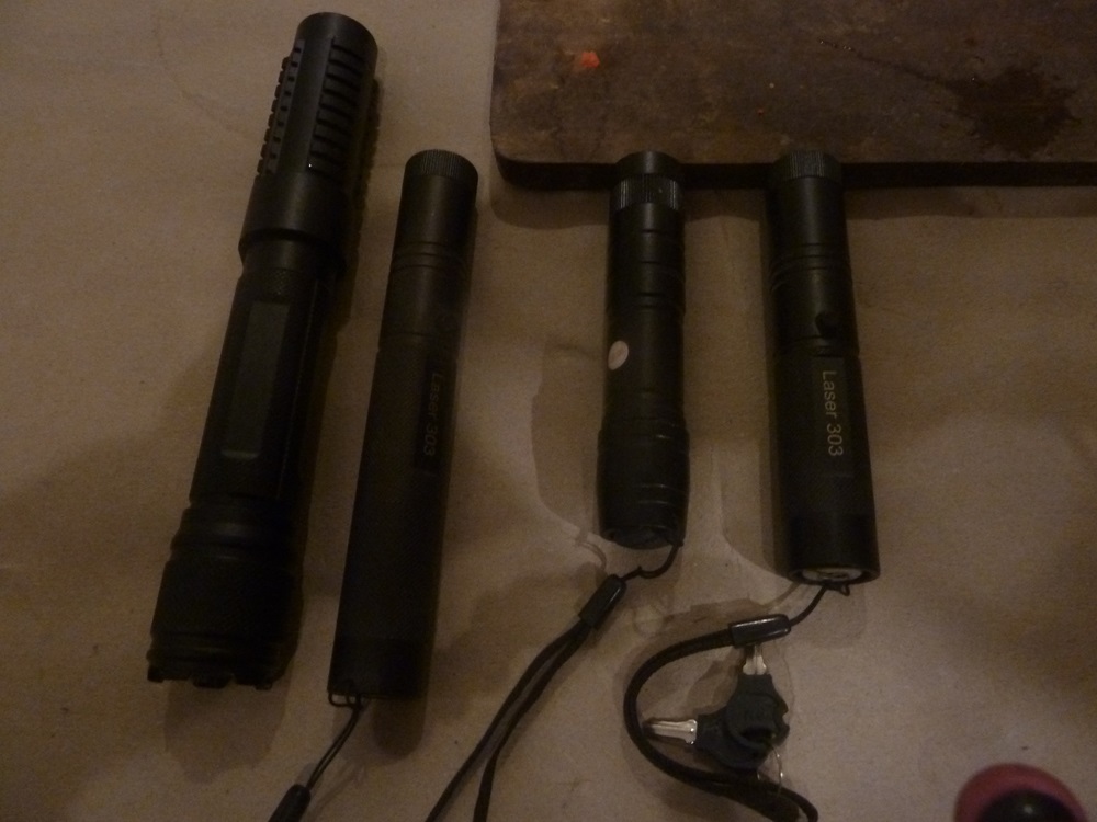

[*] posted on 31-1-2025 at 03:13
NAP laser initiation
According to the German patent, NAP is laser sensitive. I´ve done some testing and would like to share my first results with you.
The laser pointers were bought from chinese suppliers. The three small are rated with 200 milliwatt , whereas the big (strong) blue is rated with 2000 milliwatt output. Beam diameter between 3 and 5 millimeter, beam not focussed.
Only the strong blue was able to initiate my NAP samples. I want to emphazise that this is just a preliminary result with two NAP samples irradiated out of my wrist. Surely more and better testing is necessary to get reliable results.
Laser equipment.jpg - 165kB
Attachment: Laser red.mp4 (2.9MB)
This file has been downloaded 167 times
Attachment: Laser green.mp4 (2.4MB)
This file has been downloaded 185 times
Attachment: Laser blue weak.mp4 (2.8MB)
This file has been downloaded 166 times
Attachment: Laser blue strong.mp4 (1.3MB)
This file has been downloaded 220 times
Microtek
Posts: 993
Registered: 23-9-2002
[*] posted on 31-1-2025 at 08:39
I think the term "laser sensitive primary" is a little strange. If a laser is strong enough to burn things, it should obviously be able to set off most primaries eventually. I would guess that the term involves another, faster mechanism than simple radiative heating...
Nemo_Tenetur
Posts: 79
Registered: 13-12-2023
Location: Germany
[*] posted on 31-1-2025 at 09:00
I guess that the initiation of my NAP sample isn´t just thermal heating, if you compare the initiation velocity with the thermal ignition of a piece blackmatch/quickmatch:

Microtek
Posts: 993
[*] posted on 31-1-2025 at 14:52
From what I've read in the papers that talk of laser sensitive primaries, it seems to be micro- or nano second response times. To me, this indicates direct excitation of the chemical bonds as when a compound selectively absorbs only some wave lengths and therefore appears coloured. I haven't read any theoretical papers on this, it is simply inferred from the remarks in experimental works.

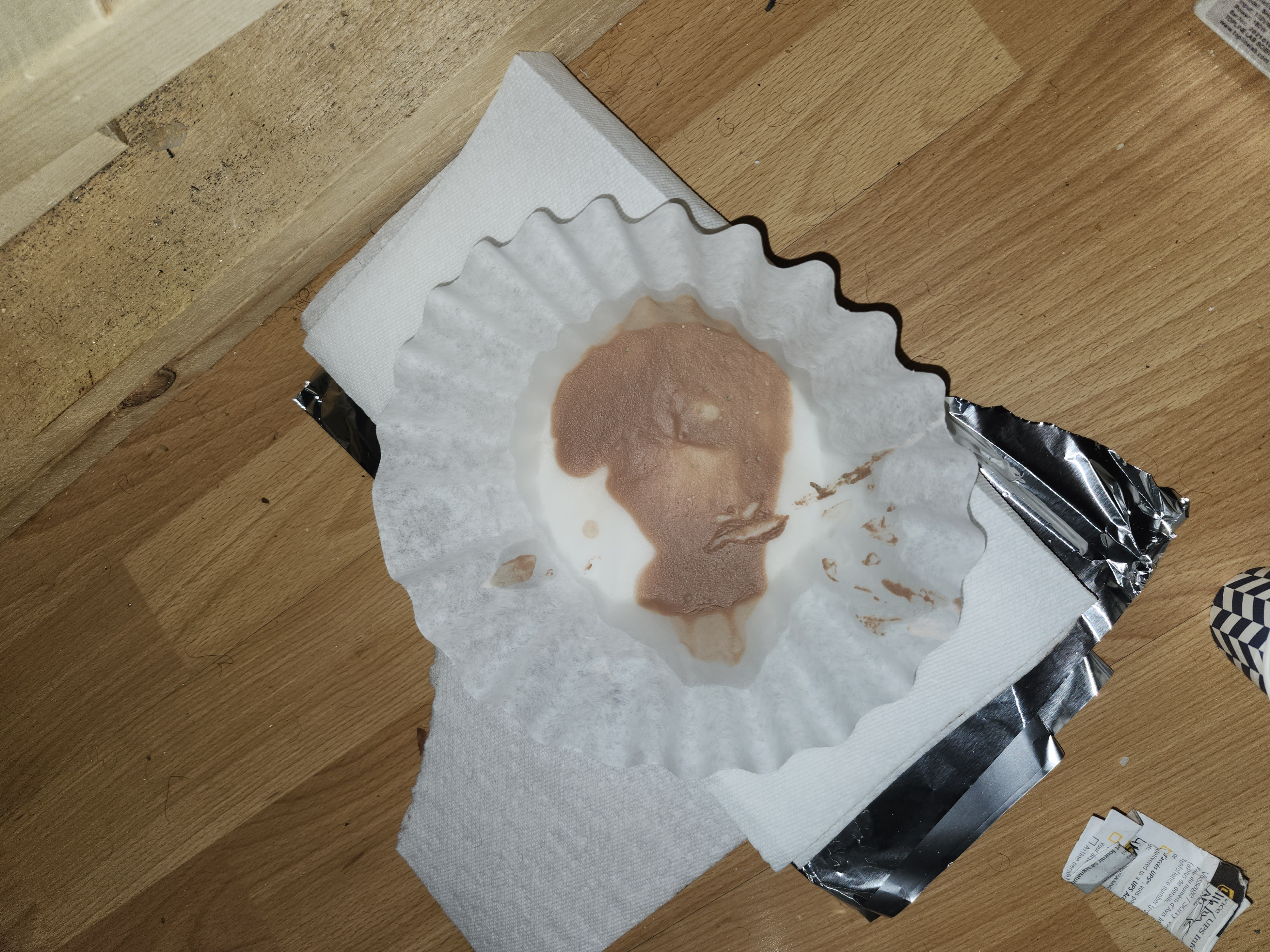

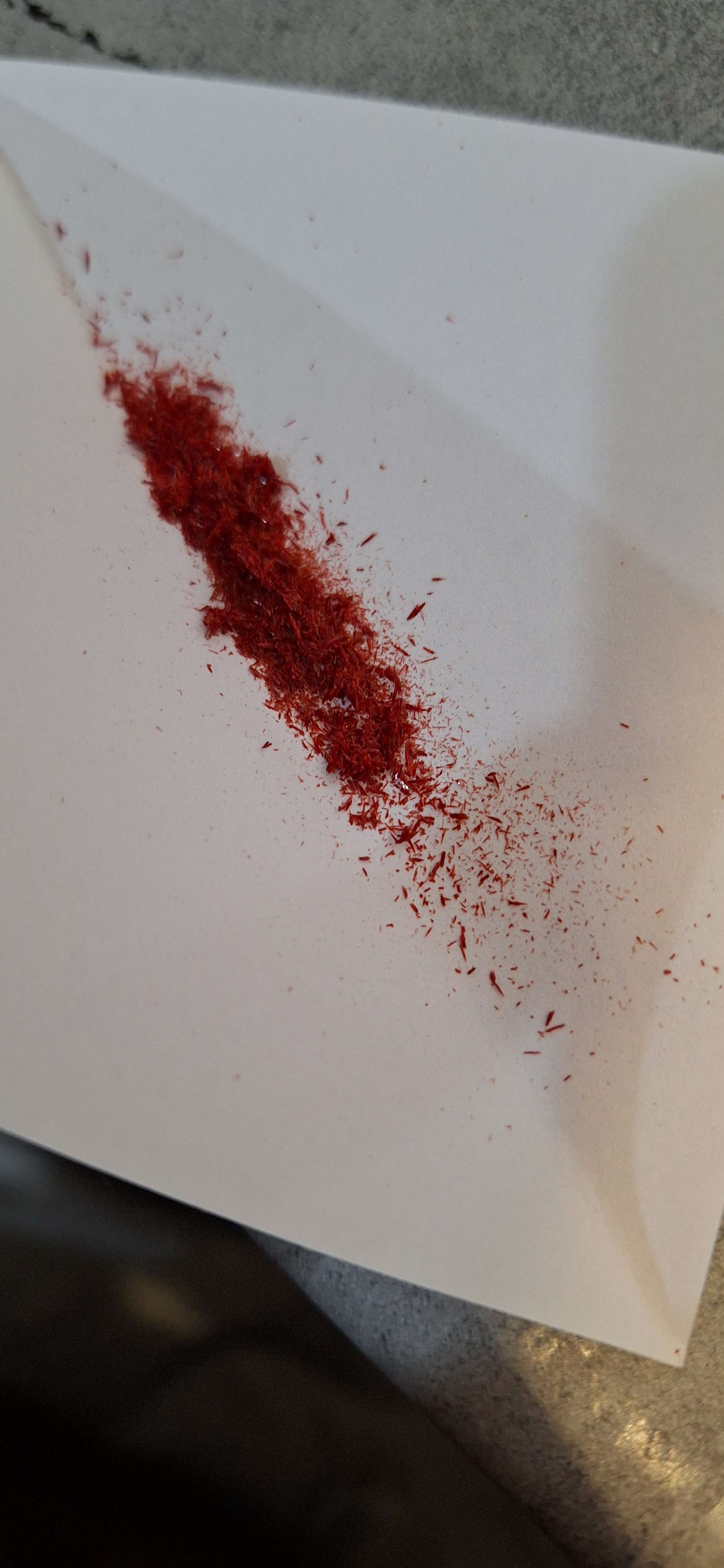

ManyInterests
Posts: 1038
[*] posted on 16-2-2025 at 06:42

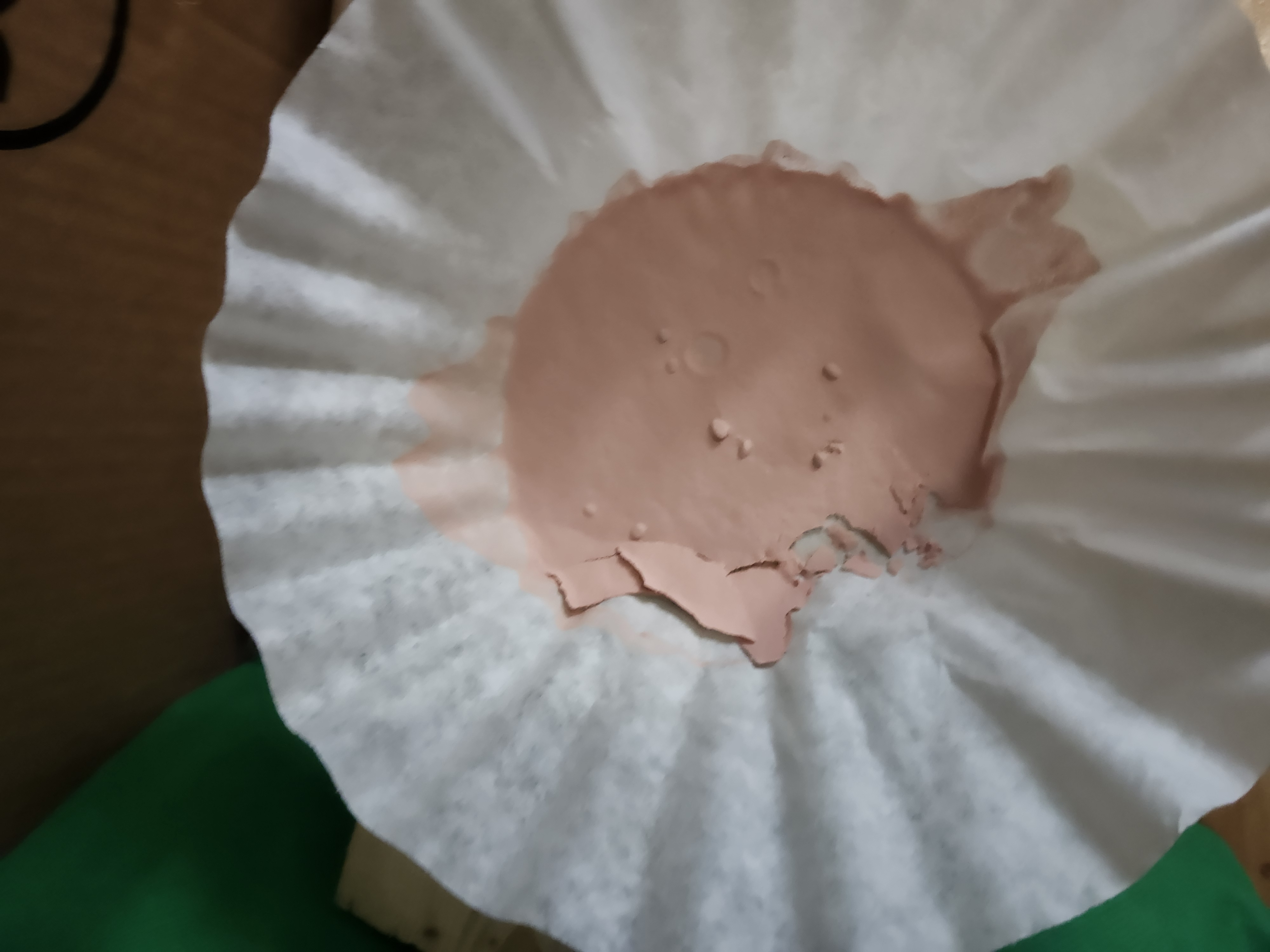

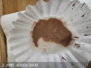

IT WORKS!
I was probably swindled on my original aminoguandine bicarb! :D The iNAP pops like a motherfucker! :D YES! IT WORKS! :D
Edit: I made a 2nd synth. The first picture (lighter colored stuff) is the first synth and it works. I got around 1.22g of yield. The 2nd synth is the second one and it is currently drying. It reacted a little differently... it took 20 minutes to do it instead of 17.5 minutes. I think it is because I kept the doors and windows opened that lowered the temp, but I almost ran out of solvent and I did see some of the rose colored stuff starting to form. I hope it works just as well.
[Edited on 16-2-2025 by ManyInterests]
20250216_144950 - Copy.jpg - 1.6MB20250216_144953 - Copy.jpg - 2.6MB

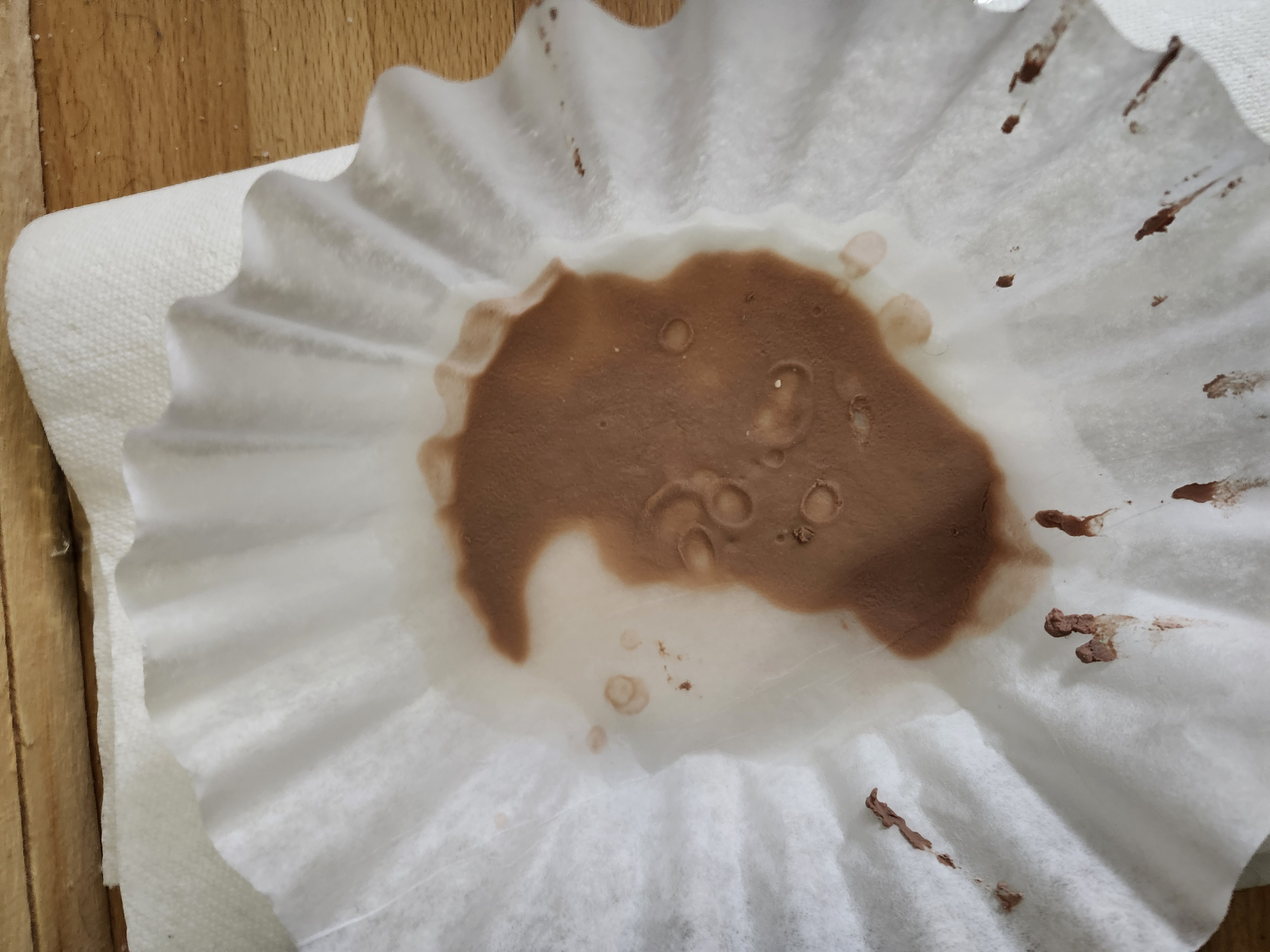

ManyInterests
Posts: 1038
[*] posted on 16-2-2025 at 15:58

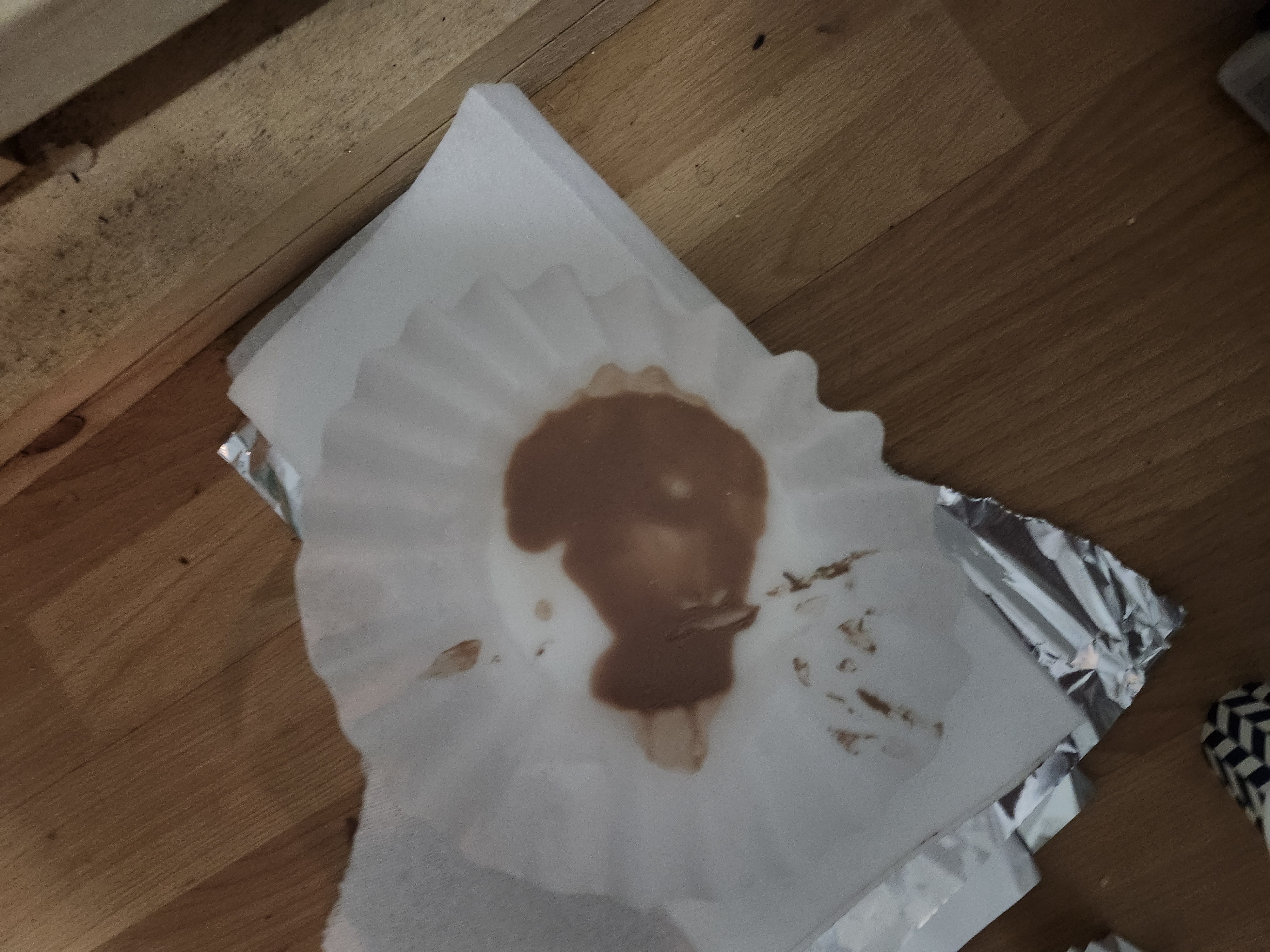

Decided to do it a third time (because why not?) The 2nd time after it dried up was not as effective as the first, but it still popped. I am glad I am starting to get some results. I used 100ml of 91% IPA, but I think I used too much. The run time was a little over 20 minutes since something was up with the heating. I noticed that the reaction doesn't really start to kick in until the solvent is starting to run lower, so perhaps using too much of an excess is what caused it to get a little weaker.
This one was almost (and I mean almost) 20 minutes, but I had to let it out since it was almost fully dry. the color only started to get to the reddish/salmon rose towards the absolute end, which is concerning to me. but at any rate, I will wait for it to dry before trying some more. I will wait until tomorrow because I don't want to wake up any neighbors.
20250216_184249 - Copy.jpg - 3.9MB20250216_184255 - Copy.jpg - 3.8MB

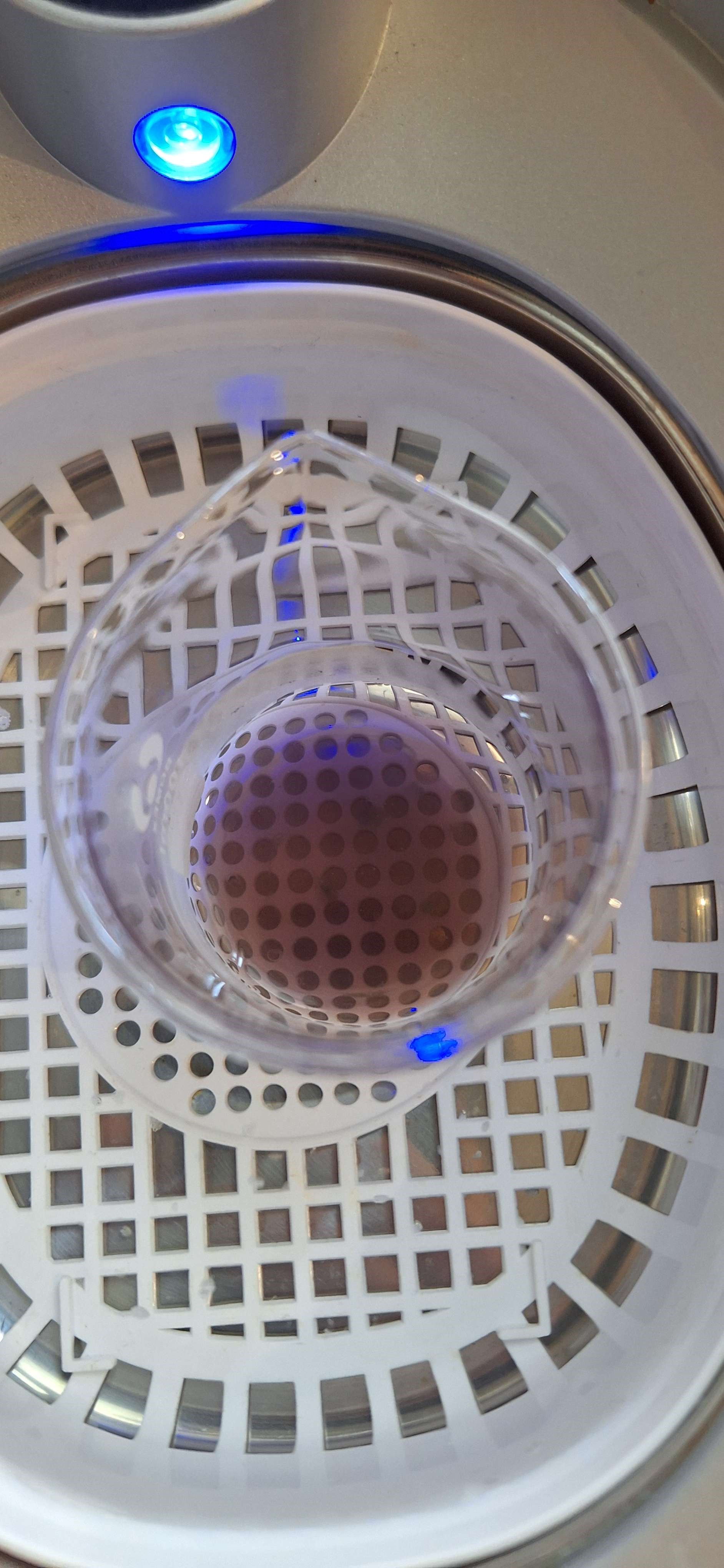

[*] posted on 14-4-2025 at 21:35

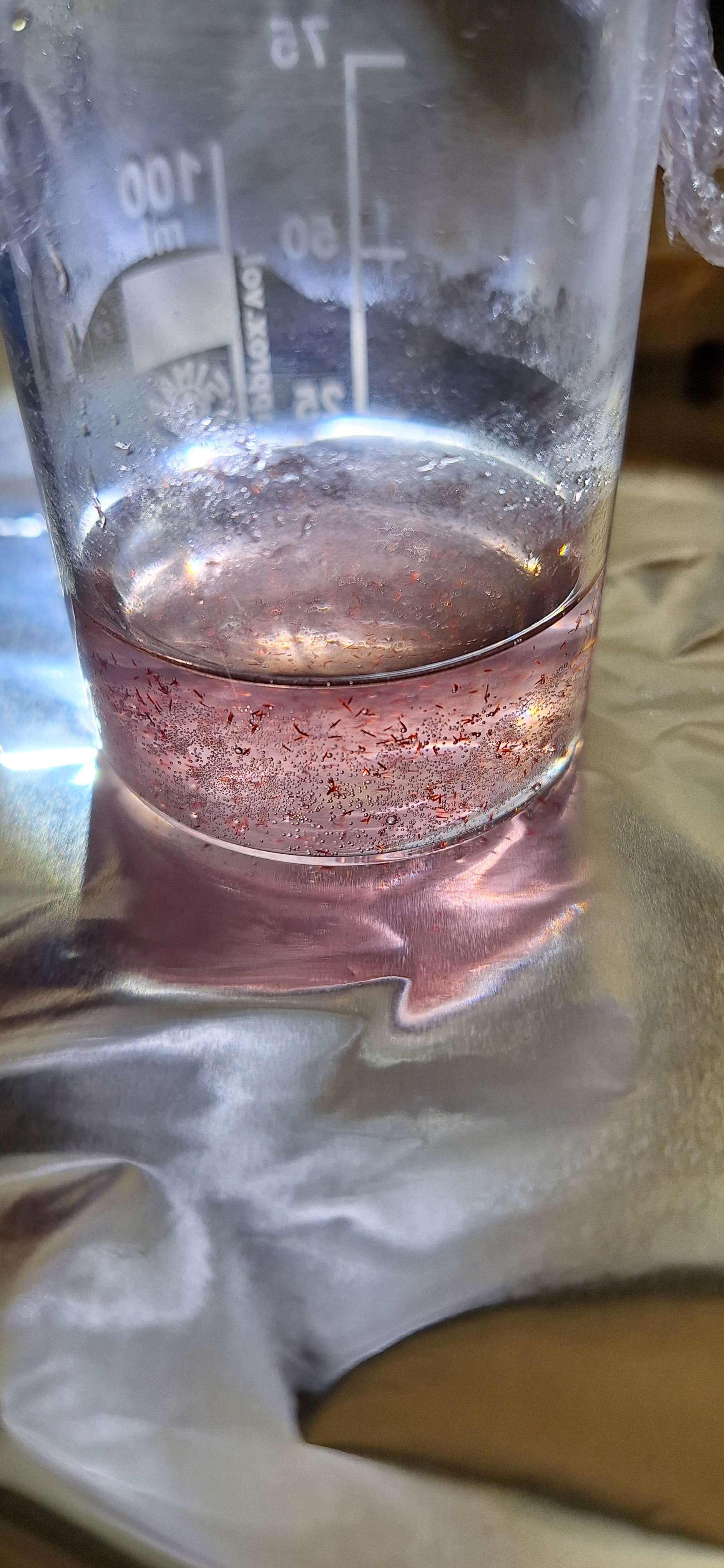

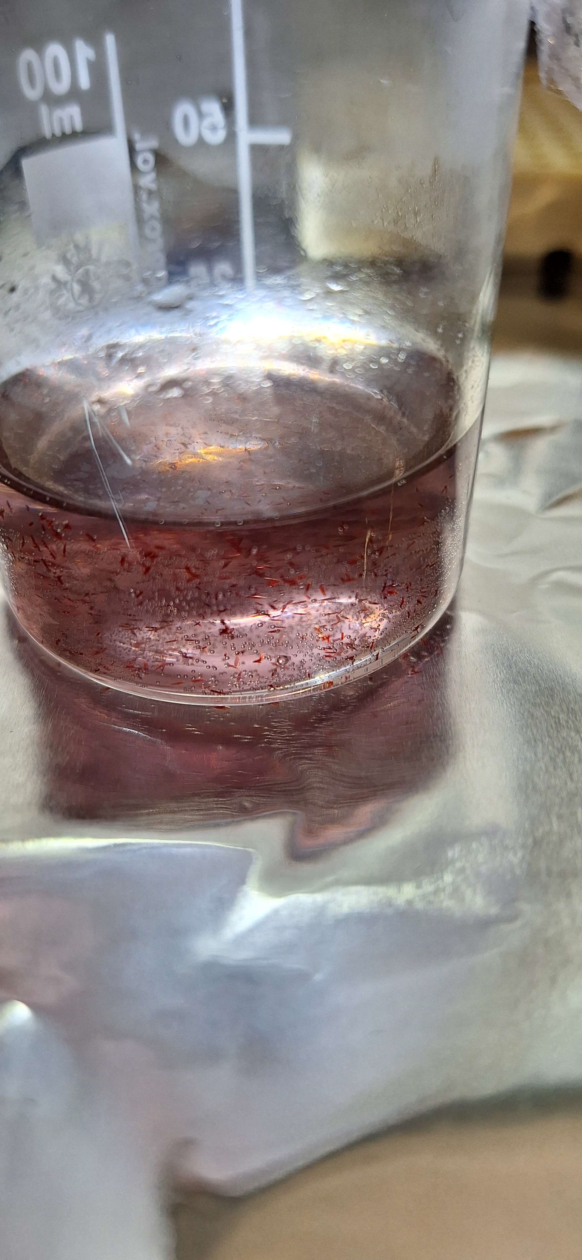

Write up of my first attempt at (u)NAP
I tried following Dug's method as seen in his videos on the matter.
Aminoguanidine bicarbonate - 1g - purchased from china. It has a slight/medium ammonia smell. Could anyone tell me if that's normal?
Ammonium perchlorate - 0.86g - Made by reacting perchloric acid with aq. ammonia 25% solution and recrystalized twice.
Nickel carbonate - 0.43g - chemical supply store grade
-reagents were mixed together in a vessel
-30ml water was boiled in tall form beaker with magnetic stirring, covered with watchglass for reflux
-reagents were dumped together into refluxing water
-Mixture was allowed to react and reflux for over 10 minutes. Initially the color was green and then very slightly muddy. I expected to only need to react it for abour 5-7 minutes but I ended up leaving it for perhaps close to 15.
-mixture was decanted into a new beaker and placed in a ultrasonic bath at ~20C for 10 minutes.
No crystals were precipitated. No change was observed. Slightly red/purple colored liquid.
Mixture was allowed to cool to room temp and left covered for an hour. No crystals were formed.
After 2-3+ hours very small needle like crystals were observed at the walls of the beaker.
The mixture was left to crystalize for further 6ish hours and then the crystals were broken loose from the walls of the beaker by hitting them with the ultrasonic bath. Crystals were filtered and dried.
Final yield was 162mg - way less than I originally expected.
Tests on a aluminum foil detonated with a pop but no foil perforation was noticed.
Any ideas on what went wrong?
Does the synthesis of ammonium perchlorate seem sound?
What would be a good way to purify the aminoguanidine bicarb if the ammonia smell is not supposed to be there? I see that the solubility in water isn't great.
[Edited on 15-4-2025 by ExcerptSix]
1.jpg - 734kB2.jpg - 913kB3.jpg - 1MB4.jpg - 688kB1.jpg - 734kB2.jpg - 913kB3.jpg - 1MB4.jpg - 688kB
Etanol
Posts: 244
Registered: 27-2-2012
[*] posted on 14-4-2025 at 23:44
Oh my god. NAP is water soluble. I'm tired of repeating this. The hot red solution should be evaporated until the first crystals appear, then cooled.
There is no need to recrystallize ammonium perchlorate prepared from pure reagents if you used indicator paper to measure pH.
There is no need to make ammonium perchlorate if you have perchloric acid. It would be more efficient to prepare aminoguanidine perchlorate and nickel perchlorate to prepare NAP from this with good purity and yield.
Ultrasonic is useful at this
and this stage:
Ultrasonic is useless at this stage
How much unreacted nickel carbonate was left in the precipitate before decantation?
[Edited on 15-4-2025 by Etanol]
ExcerptSix
Posts: 10
Registered: 13-4-2025
[*] posted on 15-4-2025 at 01:46
I have some ammonium perchlorate left so i'll try a few runs like that before giving the Nickel Perchlorate and Aminoguanidine perchlorate route a go.
The point of the ultrasonication after decantation(still hot solution) was to cool down the solution leading to precipitation and to affect the crystal morphology leading to micro crystals. At least that was my understanding.
I don't understand how I would be running an ultrasonic bath while heating to a boil and stirring the solution as your first quote suggested.
Very little nickel carbonate was left before decantation. I didn't measure it but it was in the form of a fine sludge/powder and it looked less than some of the videos i've seen.
Could you confirm that a slight ammonia smell is normal from the Aminoguanidine bicarb?

I'm usually getting around 350mg of uNAP for ever 1g AGu carbonate run with 25min of boiling.
My uNAP detonates with a loud crack when heated from below on aluminum foil and perforates the foil reliably.
When heated from above by either a blowtorch or an ember it detonates? with a pop with no foil perforation.
I've ran a few tests using a PETN det caps as they are outlined in Dugan Ashleys videos - namely a PT100 thermocouple casing OD 6mm ID 5.2mm. Progressively pressed with an arbor press 3x250mg PETN. With the last secondary interface layer being pressed by hand with about 1.5kg pressure. The primary is set off by a commercial e-match. The results for the uNAP initiation are as follows:
25mg uNAP lightly pressed on top - 0/2 caps managed to transfer the detonation to the PETN
25-30mg uNAP pressed/compacted into a 5mm OD / 3.4mm ID / 3mm length 3D printed bushing inserted against the PETN - 2/5 managed to transfer the detonation to the PETN
55-60mg uNAP pressed/compacted into a 5mm OD / 3.4mm ID / 6mm length 3D printed bushing inserted against the PETN - 5/5 managed to transfer the detonation to the PETN
I'm finding this surprising since from what I was reading I expected the minimum initiation quantity for uNAP to be 5-10mg and it appears that even 30mg isn't enough to reliably set off lightly pressed PETN.
The uNAP I've made is otherwise visually exactly what is expected.

Well, you probably have a lot of impurities in your NAP from the nickel carbonate. As Etanol says, you should eliminate that impurity by preparing the perchlorate salts of both aminoguanidine and nickel (there is no need to isolate them - you can just use the solutions, but avoid having an excess of perchloric acid as the low pH may prevent precipitation).
If you do it this way, the only species that isn't extremely soluble in water is NAP.
