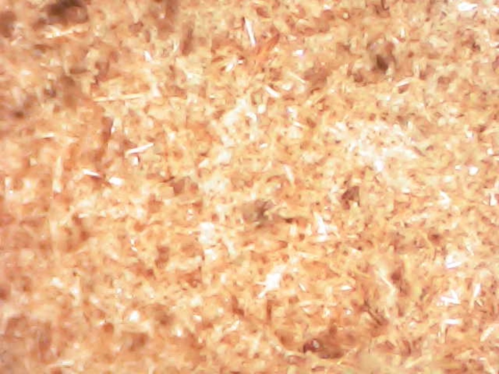

iNAP
[Edited on 21-10-2024 by Hey Buddy]

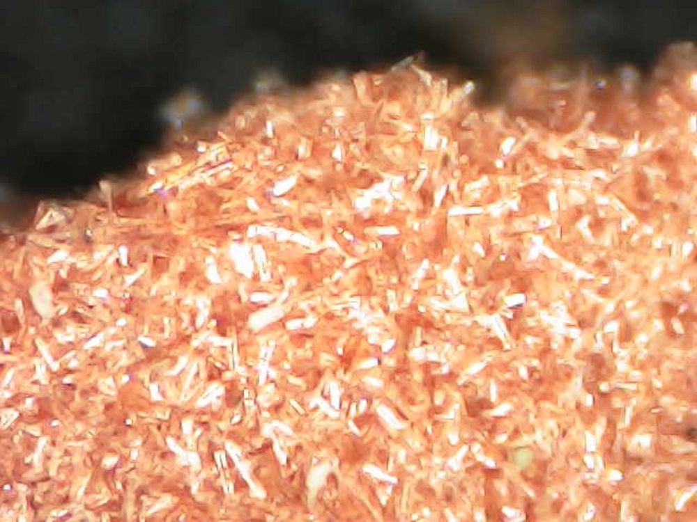

Low rpm NAP
CBEU8845.jpg - 196kBDQFP8442.jpg - 154kBRMPF3466.jpg - 189kBBMJV6250.jpg - 194kB

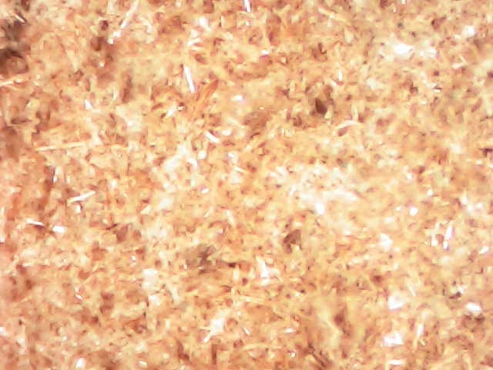

uNAP
EFGV9775.jpg - 201kBQZOS6428.jpg - 226kB

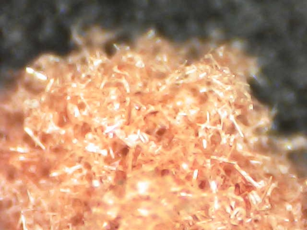

1200 rpm NAP
ELZQ2287.png - 1.1MBFEZJ5068.jpg - 160kBPWVB6838.jpg - 173kBUQNA0407.jpg - 156kB

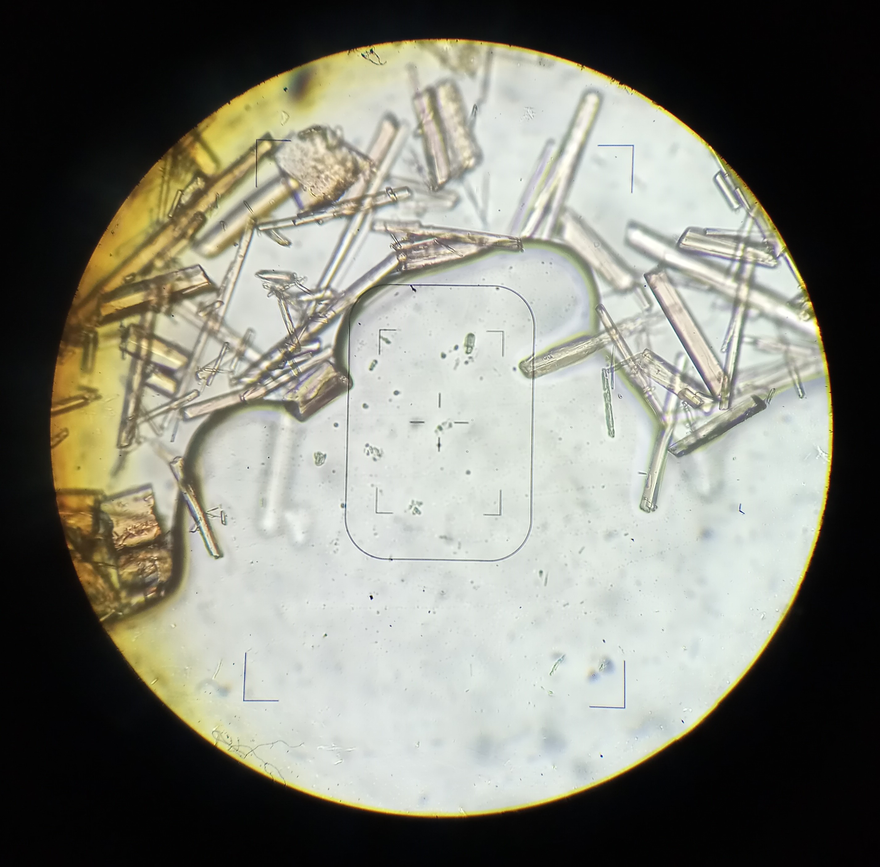

I have performed a round of sensitivity tests on the uNAP. I recorded 5 out of 5 no go's a the max setting of my apparatus, same as the stirred NAP. For this reason, I can't conclude anything about the sensitivity of uNAP versus stirred NAP, but I can conlude that they are both less sensitive in this test than PETN.
I took this picture through my microscope. It is perhaps not clear in this image, but the little specks seen in the frame are small crystals of NAP. The much larger crystal just on the right edge of the central frame is about 10 micron in diameter (I have an etched slide with a scale to compare).
In my opinion there are real differences in the performance of uNAP and stirred NAP on the very small scale, however, I think it can be explained solely by particle size effects. Furthermore, I think the differences are negligible in most practical applications. The purpose of a primary is usually to initiate a base charge, and stirred NAP (or even larger crystals of NAP) will accomplish this very effectively in minute quantities; 10-20 mg or so. Even 100 mg pressed into a standard detonator body takes up space like the skin on an apple, so there is rarely a reason to use just 5 mg.

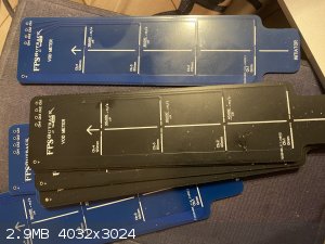

I use it when I do VOD measurements with ionisation probes and an oscilloscope. The fluffy NC
This makes an arc from one lead to the other across the cut end of the wire.
These don't work for VOD measurements however, since the arc triggers the scope before the the CJ-zone even arrives at the first probe.
Curious, at what voltage you are using across the probe and over what gap? I had made boards up which are still sitting around pic attached, with the intent to fire a charge across the PCB tracks. 2 types, some to break the 0.2mm track and other to act as ionisation probes with a gap; some 2mm and some 0.5mm. These were never tested as I never had a battery powered scope at the time.
Originally, I had planned to use about 1kV over the 2mm gap but then toned it back to low voltage over 0.5mm. Your comment seems to confirm that thought, that the higher voltage discharge would interfere with the other gaps (acting as antennas) so a lower voltage should be used.

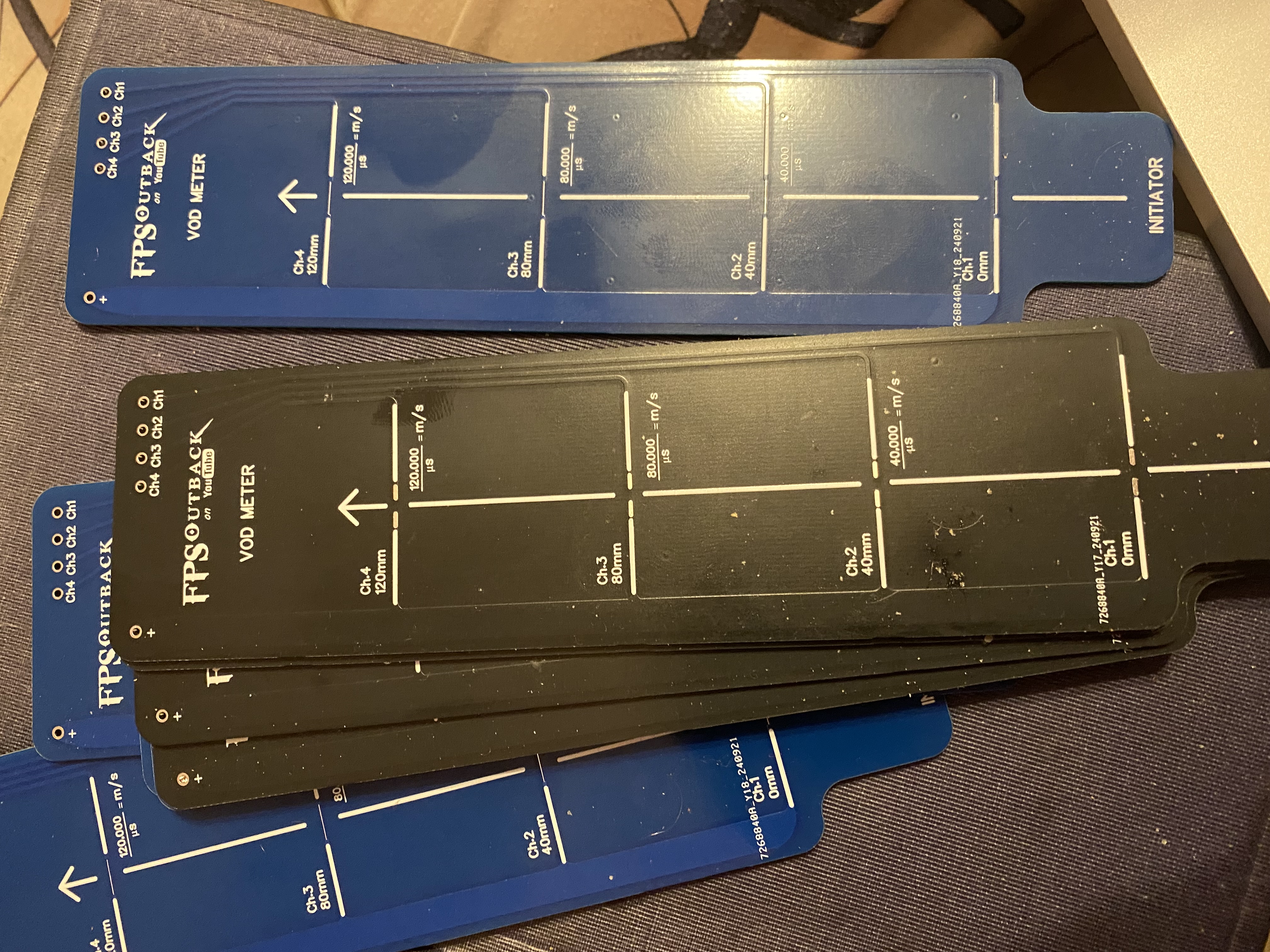

vod boards.jpeg - 2.9MB

You can crush up match heads and mix the powder with an acetone solution of NC to make a thick porridge. Then dip your nichrome wire in that. It works very well, and I use it when I do VOD measurements with ionisation probes and an oscilloscope. The fluffy NC ones are less labour intensive since all I need to do is to snip off a piece of wire with two leads and put one end into the 3d printed plastic cup I mentioned earlier. Then stuff in a small piece of gun cotton and insert the cup into the cap. It is then fired by a couple of batteries through a one dollar boost converter. This makes an arc from one lead to the other across the cut end of the wire.
Can you explain the VOD measurement process a bit?
