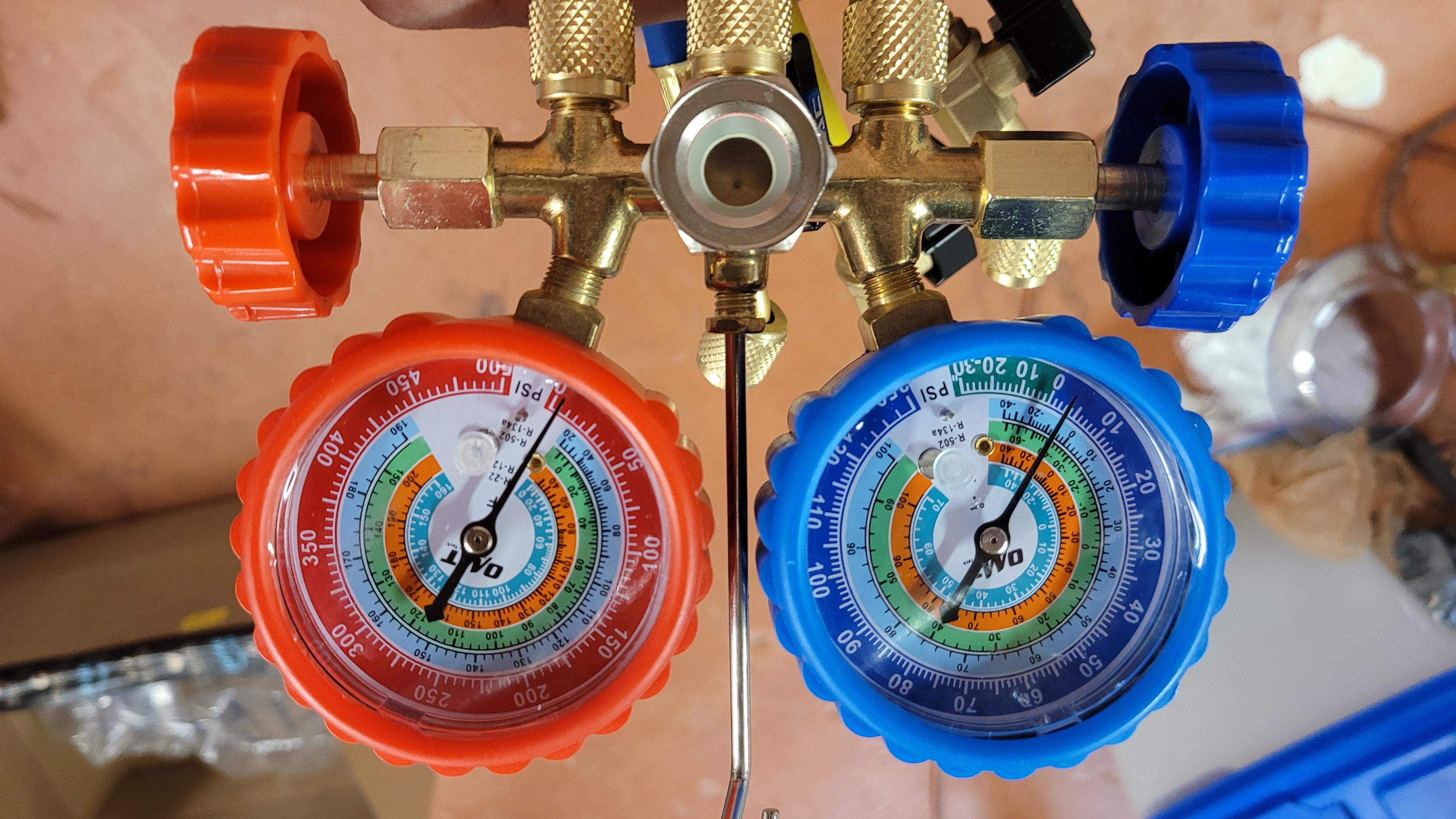

[*] posted on 16-7-2022 at 07:59
After reading I need to correct 3 things. The 15-minute cooldown time is 45 minutes. And the amount of ethanol was 1.5 L. Not sure how I got that wrong in my notes. I can't be trusted with Everclear.
As for my pressure readings. They are off.
At atmospheric pressure,
The low side gauge is reading +3.5psi. I verified with a trusted digital gauge at 100.0psi +/- 0.1, the blue reads 102. So the error is fairly linear.
The high side gauge was off by 4~5psi and maintained that same error at 100psi
The adjusted pressures will be
Suction pressure will be -1.5 high side 135psi
Subcooling about 10f and superheat @ around 9f

[*] posted on 17-7-2022 at 03:14
Your pressure gauges look like they have a zero adjustment. That's the slotted screw head under the small plastic thing in the glass viewing window of the gauges. You turn that screw to adjust the zero position of the pointer in the orientation that the gauge will be used .
The problem with operating the low side pressure near 1 bar is the mass throughput is low compared to operating at a higher pressure. That translates to lower cooling capacity.
My design strategy is start with the refrigerant's boiling point and vapour pressure at about 30 C. I don't need much cooling capacity so I can operate the evaporator near its boiling point. Of cause for safety I don't what to exceed the max pressure of the compressor. The new compressor I have was originally intended for use in a bottle chiller so I suspect whatever refrigerant I use it will not go much below 0C.
I am reasonable certain the capillary tubing has a restriction at the end inside of the evaporator. Ideally for a DIY cooler it needs to be adjustable.
I have bypassed the thermostat of air conditioning units and a dehumidifier to see how far they will go down. but they bottom out around 0C.
I do have a big commercial freezer that was sort of working before I received it. That should go down to -20C and possibly much lower. That is probably my best chance of my getting below -20C. The compressor, condenser and fan are on a single plate but its big at about 1m x 1m and 0.3m in height. It came from a small restaurant that also has a cold room. I am still hoping they will stop using the cold room and ask me to remove the cooling unit. Its got a belt driven compressor with two cylinders. I will be delighted to remove it and dispose of it for them LOL.
