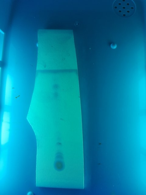

I made an alcohol extract (40% ethanol) with bark from a rare medicinal tree that grows in the jungle, and evaporated most of tge solvent, then spotted it on a TLC plate and first visualised with UV of 254 nm:
Then put it in an iodine chamber:
The mobile phase for this was 50:50 ethyl acetate : petroleum ether.
Here is a second plate I did with pure ethyl acetate:
Firstly I have a few questions about how to read this:
1.) How many unique compounds would you estimate are on these plates?
2.) The plates look very similar for both mobile phases. What does this mean?
3.) Why is there a line at the top of the plate where the solvent line is? Is this a substance that is highly soluble in the mobile phase?
4.) And the big spot at the bottom where I spotted, is this compound(s) that are highly insoluble in the mobile phase?
5.) Some new spots appeared when stained with iodine, are these non UV active compounds or are they just more visible with the iodine?
Where would you go from here to find out more about what these compounds on the plate are?

Although I am suspicious of this rare "jungle" bark you are trying to work with... (sounds a bit similar to a rather "special" bark I have heard of) I will avoid answering the questions directly and just help you with theory.
1.) No spoonfeeding answers. What do you think?
2.) What is the difference bewteen ethyl acetate and petroleum ether? Do you think that the hydrophobicity or dipole interactions could be affecting how the components interact with the solvent system? If so, what happens to different functional groups (separate or in conjunction to one another)? Why might these two solvent systems be so similar? Are they actually the similar, or are there two sets of contents you are mistaking as similar?
3.) Line at the top just indicates that a lot of contents moved at the speed of the solvent line, which likely indicates that you need a better solvent system, or need to break the chromatography into separate runs.
4.) Well given the information I have so far provided, this is answerable, and it seems you have a good idea already of ehat caused it.
5.) Iodine is just a cheap developer so that we can clearly see what is a spot and what isnt. Its sometimes hard to see spots if they absorb uv light, and sometimes even in uv light they are a pain. Iodine allows one to keep an "image" or "shadow" of the products. However this doesnt work for all chemicals.
6.) Unless you are a professional chemist, which I am assuming you are not, and unless you have access to a GCMS or some equivalent, identification is going to be super hard. Take it from pre 1900s chemists, they did this stuff by hand and by countless hours of reacting each component isolated until they got a very crude structure, and even then it is hard. If you know the species, you can probably look up the breakdown of components in the extract and use cross references to do so. But if you are also talking about separation post-chroma column fractioning, you need to be sure that all fractions are isolates and do not contain more than 1 compound. This could take an amatuer months if not longer to do, if done properly. It took me ages to get good at chromatography, even with my lab professor teaching me under direct guidance. If you wish to do so, then take your time and take copious notes with lots of experimentation. Id suggest getting more of that bark if you want to get serious. Otherwise, it may be very difficult.
There is also the possibility of very crude separations if you know the compound of interest, but be careful, this is also sometimes difficult. Just look to the forum posts about isolations from various substrates (black pepper corns, chiles, etc).
Also if this is drug related, its best you stop here and head to another forum, this stuff isnt tolerated here. Although I dont want to assume, your lack of stating the scientific name of this special tree gives rise to a feeling of drug chemistry. I am personally indifferent to drug chem, it seems cool in terms of building molecules, however you seem to be extracting from a bark, which if it is what I believe it is, could land you in some serious issues depending on where you live.
EDIT - Most definitely drug extraction. You sir are looking for DMT and harmaline alkaloids... you said so by giving the name of the plant in your older posts.
Exhibit A : http://www.sciencemadness.org/talk/viewthread.php?tid=158450...
Exhibit B : http://www.sciencemadness.org/talk/viewthread.php?tid=158450...
Listen, your post history gives it away big time. From saying that you got a BSc in chemistry, to extraction help for "alkaloids", and having no clue about mixtures of solvents and chromatography, makes this scream drug chemistry. Go to the HIVE or the Vespiary, they have plenty of information. Drug chemistry would get this beautiful site taken down, so please dont ruin it!

The plant is in the tabernaemontana genus. I beleive its tabernaemontana sananho but may be mistaking it with a related species.

I should have explained a bit beter when I wrote these questions, so as not to give the wrong idea. I think that there are 10 unique UV active compounds appearing on the plates. The crescents I believe are formed because I didn't have a capillary to spot the sample, so I disturbed the silica matrix a bit with the pin. I'm wondering can this situation make it appear like theres numerous compounds separating, when really its only one.
Petroleum ether is made up mainly of short chain aliphatic hydrocarbons which don't have major dipole moments to solvate more polar functional groups. Increasing the pet. ether would usually cause the components to spread differently, as the more polar constituents become less soluble in the mobile phase but could be that the concentration of pet. ether needs to reach a certain threshold where the ethyl acetate becomes so dispersed that its electronic interactions with the polar functional groups in the sample become negligent. The second plate might be a different spread of compounds entirely, but it does look very similar.
This is what I thought. I expected the different solvent system to slow down the components of this line, but that didn't appear to happen. Or could just be that lowering the polarity increased the solubility of another set of compounds in the sample.

I mean even the plant you have given in this thread contains ibogaine, which is schedule 1 in the US, which is pretty much a life sentence in the clank.
But to actually address your questions as you have expanded, I am happy to help.
In terms of separation, your crescents are all different compounds. Take the photo of it and draw a dot at each center of the crescent. Count them. This gives a good idea. In my lab at work, we work with porphyrins a lot and we tend to do what we call a "smear" technique where we dont dot the reaction mixture but instead smear it in a nice thin line horizontally. This allows us to visualize better, however porphyrins are known to be colored which makes it a whole lot easier. You can also try that, but be sure to let the applied extract mixture to dry on the plate first. You can even use gentle heating.
You are more than likely going to need to mess with more solvents. Make a list of solvents from totally non polar to highest polarity. Then mess around with mixtures. As long as you can get a nice separation, you can use the Rf values to determine the length of the chroma column needed. Its not perfect by any means, but ive separated 120 compounds in one column before, which honestly I got lucky with that. It was just perfect conditions. Wont happen again in my case haha.
I am assuming here, but Id say from experience that plant sometimes behave similarly even when a solvent is ommitted. So again, mess around and see what you get. Try and use a longer tlc plate, you might be surprised with what some extra time and patience can yield you.
As for the solvent front issue, maybe try and decrease the height of the solvent at the bottom of the plate. Sometimes when you submerge the plate such that the solvent system starts on top of the area in which you spotted the plate, you will get a nasty dissolution and will ruin the plate.
As for GCMS, use the chemists in Mexico. Its entirely legal to work with tryptamines there, and they are a skilled bunch. And yeah just keep working on the separation.

As far as I know, this plant does not contain ibogaine, it contains some other alkaloids that are present in iboga as these plants are im the same family. If it contained ibogaine, I would assume its in a very small quantity. In my country ibogaine is not prohibited as far as I know.
Thanks. I really just wanted to confirm that they are separate compounds, to understand if there might be situations where this crescent formation might make one compound appear as multiple compounds. I know how to resolve these dots by altering the solvent system. I usually run the plate again time in solvent system that doesn't elute the compounds very well, and repeat if needs be, slightly altering the system each run. Eventually they will separate.
When I have a complex mixture, I usually run one TLC plate multiple times until I find a few solvent systems in a specific order which spread all the compounds well, sometimes some of the compounds have to run off the plate first. So when I run the column, only a portion of the compounds elute first pass, then the rest come out with a different solvent system.
120 compounds in one column is pretty incredible alright, out of curiosity, what exactly was the mixture and what was the solvent system that separated it?
