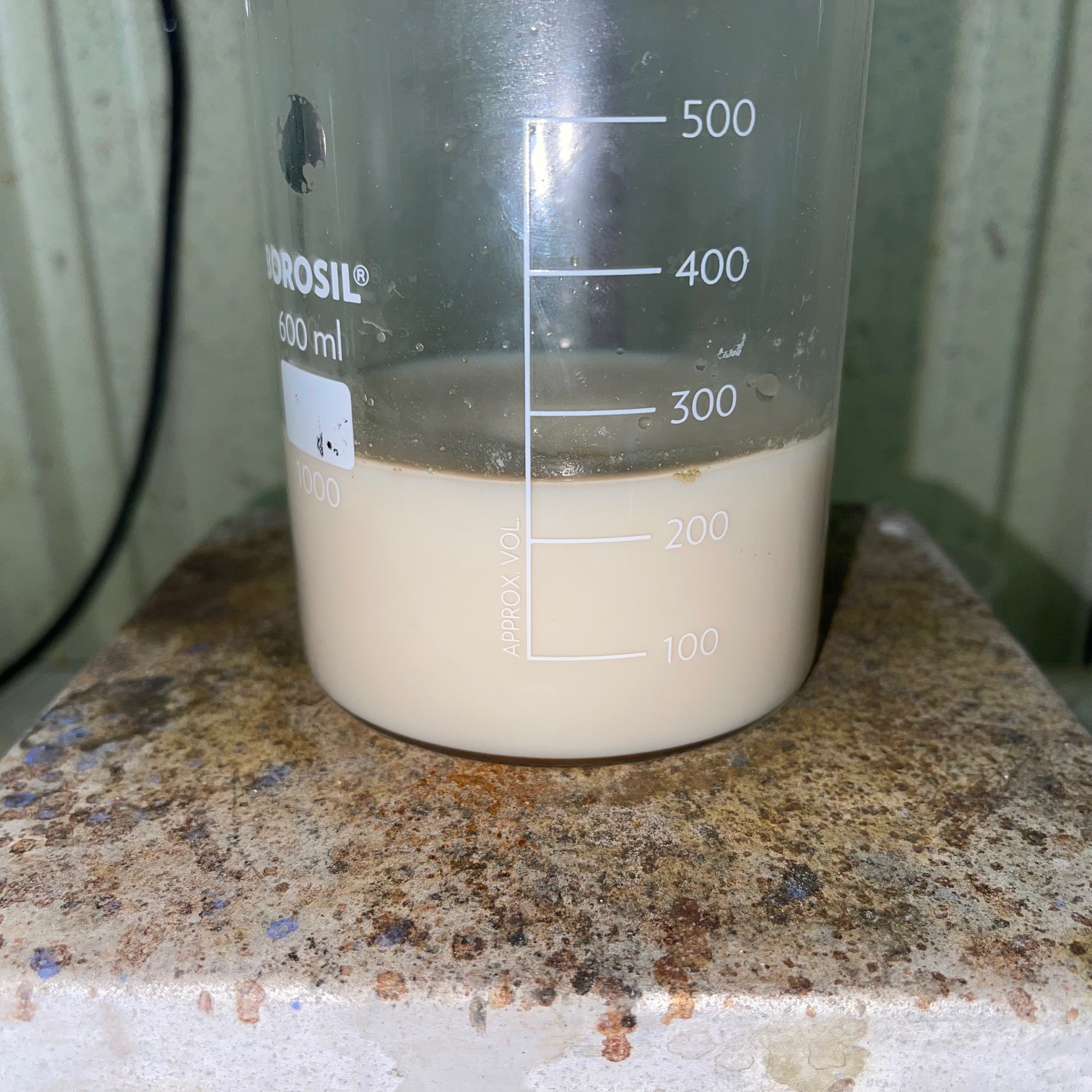

Manganese:
- 10g taurine and 3.3g NaOH dissolved in 120ml water without heating, almost completely clear solution.
- 10g MnSO4.xH2O dissolved in 120ml water, heated to obtain a clear pale pink solution
- Add manganese to taurine solution, both now hot.
- Cream colored suspension formed
1.jpg - 560kB
- After 2 hours stirring the solution turned light brown with darker brown where exposed to air.
