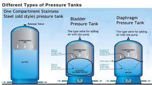

OK. Here is an idea for storing and metering various gasses:
https://www.sciencemadness.org/whisper/viewthread.php?tid=71...
It doesn't have to be implemented in this exact way. The idea is that there is a (large) container that is air-tight. A piece of tubing is sealed to a plastic bag, and the bag is stuff inside of the air-tight container. Air is supplied through another piece of tubing to the container, this causes the bag to collapse and force gas from the bag through the exit tube. This way the gas can be compressed a bit, but the two gas streams never mix. Also, a flow-meter can be used inline with the compressed air input. This is a handy option if the process gas is corrosive to the flow-meter components.
If you just want simple (mildly) compressed gas storage, then the gas can be stored in a bag, with the bag placed into a much larger (by volume) container. The greater the ratio between the container and bag volumes, the less pressure change between a full and empty gas bag.
If a gas being stored is fairly inert, then a bladder tank can be used:
pressure tank.jpg - 10kB
