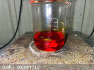

The reaction was to proceed as below, with a target yield of 10g.
BiCl3 + 2CsCl + 5KI = Cs2(BiI5) + 5KCl
- 2.8g BiCl3 in a small bealer
- Add 1g concentrated HCl and 9g water and stir
- Solution became cloudy, add a few drops HCl until completely clear.

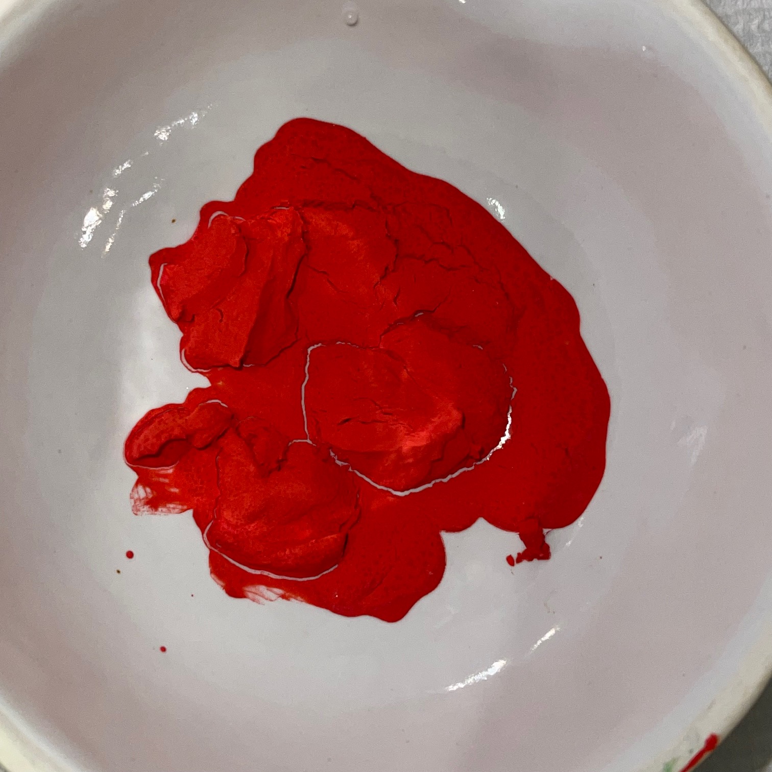

- Dissolve 7.5g KI in 10g water, and add this to the BiCl3 solution. The result was this red solution:
1.jpg - 689kB
- Dissolve 3g CsCl in 6g water. Add this to the red bismuth iodide solution. A red suspension resulted:
2.jpg - 497kB
- Stir 10 minutes and gravity filter. Rinse with water in filter twice. A red remainder was recovered with a very pale yellow filtrate. The color with the eye is very pure red according to my color reference; on the monitor it appears a bit darker:
3.jpg - 544kB
- Dry over NaOH and under vacuum in desiccator for 48 hours. The result was a dry, soft free flowing reasonably heavy powder. Minimal color change from wet to dry:
4.jpg - 440kB
- 7.9g bottled, representing a 79% yield. It seemed to stick quite well to the filter paper which probably accounts for some of the loss. Going by the volume that 7.9g takes up in the vial this product is heavier (denser) than most others I made.

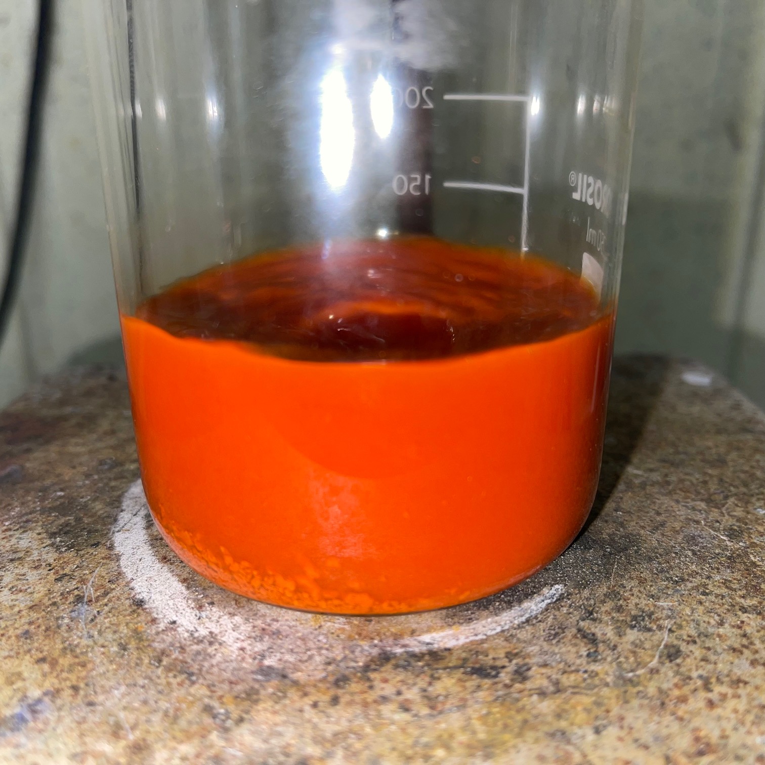

- Add the SbCl3 solution slowly to the mix of KI-CsCl. Solution initially turned red, but towards the end of the addition it suddenly turned black. At the same time purple-red fumes was seen; only for a few seconds and it disappeared before I could smell whether it was iodine vapor or NOx. Probably unlikely to have been iodine vapor as the solution was at room temp.
- I stopped the stirring and had an orange-red product with black supernatant liquid. I realised it was most likely free iodine.
1.jpg - 490kB
- Gravity filter. This was the result:
2.jpg - 495kB
- Wash with 3 lots of acetone in the funnel. This seemed to get rid of most of the iodine, but seemed to also dissolve a bit of the product as the last drops of wash water was slightly red.
3.jpg - 518kB
- Transfer the remainder into a beaker and stir for 5 minutes with 100ml acetone:
4.jpg - 442kB
- Filter. This time there was almost no black color left in the acetone and I was happy that I removed most of the iodine.

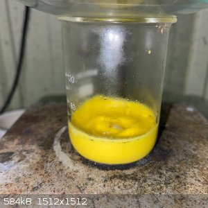

First batch:
- 4.9g of the old sodium iodate measured out.
- 4.5g cesium chloride in small beaker (a slight excess)
- Add 20g HCl, and stil to dissolve all CsCl (dissolved fast).
- Add NaIO3 in small portions while stirring. There was some bubbling, but not as much as I expected. Hardly any. With each addition there was also a black color that faded. I assumed this was a sigh of free iodine in my product or maybe NaI.
- The only time I really smelled Cl2 was towards the end of the addition. This was the final solution:
Na1.jpg - 584kB
- Add a few grams HCl but the solution remained vary thick. No point to try and filter.

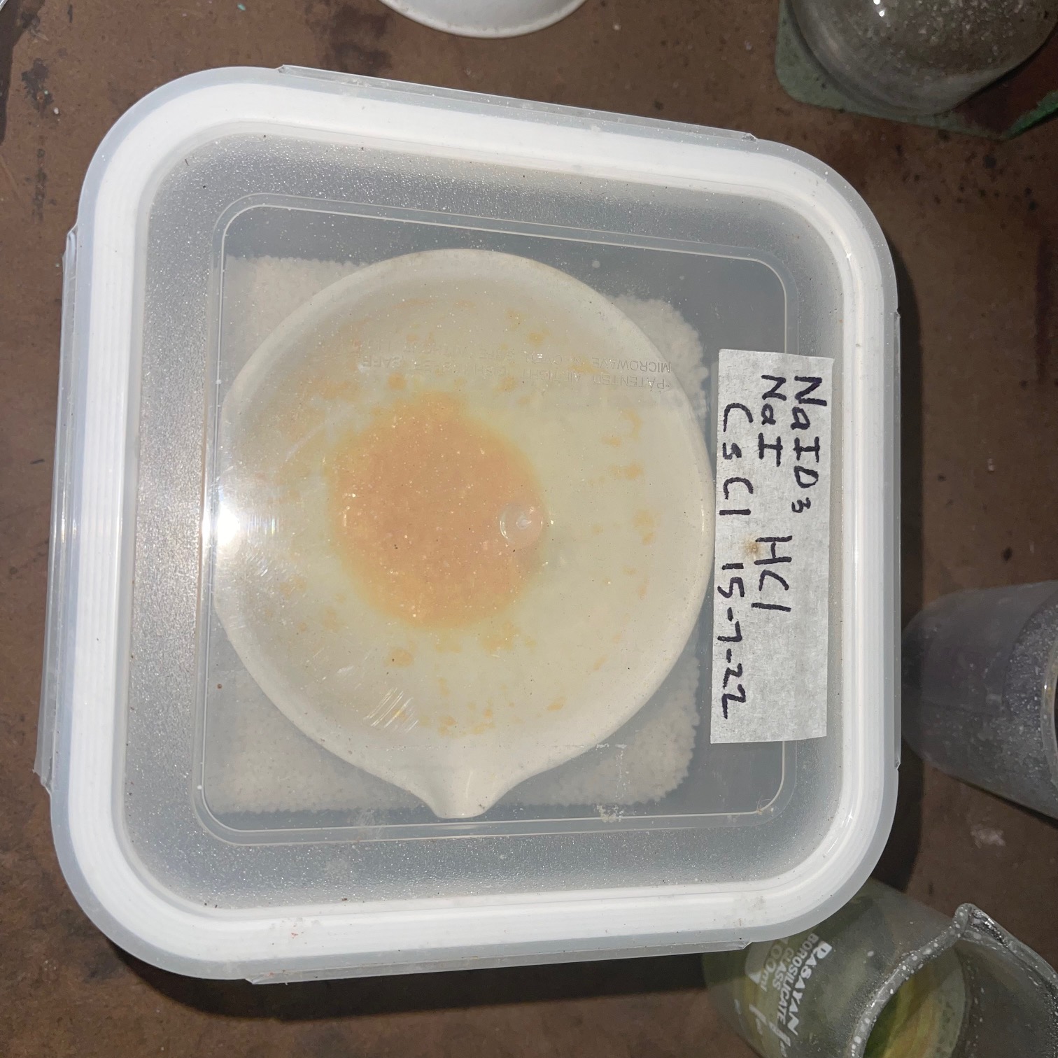

- Scratched all into a evaporating dish:
Na2.jpg - 419kB
- Keep dish in desiccator for 48 hours but it hardly dried.

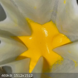

While batch 1 was in the desiccator I progressed batch 2 detailed below. This was much more of a success and I decided to be a bit more bold with batch 1.
- I dried batch 1 on a steam bath for a few hours. The volume decreased only a bit but it turned more orange. No sign of decomposition.
Na3.jpg - 446kB
- Making batch 2 told me that the potassium salt was soluble in water but not the cesium salt. I thus transferred batch 1 into a beaker with 60ml water and stirred for 20 minutes.
- Vacuum filtered. I got a pale orange yellow filtrate and a bright yellow remainder.
Na6.jpg - 469kB
- The remainder was dried under a steel dish in the sun, it quickly dried to a soft bright yellow powder which I am reasonably sure is my cesium product CsICl4. 2.5g was recovered (initial target was 10g).
- The filtrate was reduced to a wet paste on the steam bath, and then put in a sealed dish of NaOH to dry out slowly. With the eye it looks more orange than with the phone camera.
N8.jpg - 439kB

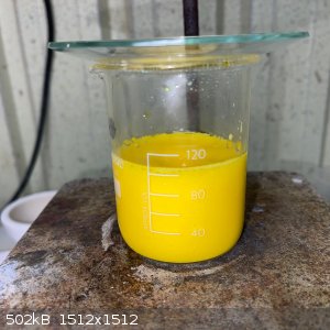

Cesium dichromate
Cesium dichromate has a relatively low solubility compared to sodium dichromate and a double displacement between sodium dichromate and cesium chloride was performed (each dissolved in minimal water).
- 6g Na2Cr2O7 dissolved in 10g water. This gave a clear red solution.
- 9g CsCl dissolved in 10g water. This gave a clear colorless solution. This should have put the CsCl in slight access.
- Add cesium chloride to sodium dichromate while stirring.
- An yellow suspension formed, too thick to stir. Add 10g water and stir for 30 minutes. During the stirring the color quickly changed to light orange.
- Vacuum filter. Both remainder and filtrate was the same light orange color.
1.jpg - 374kB
- Wash once in funnel with water (which would have caused some loss of product but hopefully increased purity) and leave on bench to dry.
- After 2 days the product appeared completely dry. The result was 8.2g of soft light/bright orange product, thus an efficiency of some 75%. I don't know if some chromate also formed, being that the initial suspension was yellow.
2.jpg - 435kB
- More crystals are also settling out of the filtrate.
3.jpg - 672kB
