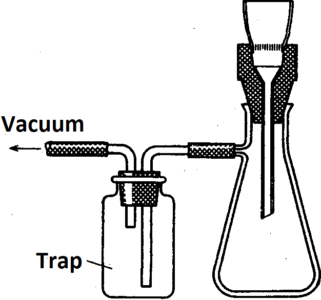

Romix
Hazard to Others (Literally)
Posts: 386
Registered: 19-6-2015
[*] posted on 7-9-2022 at 18:03
Dear Sulaiman.
Thank you for the advice, much appreciated.
That's what I been thinking about all night tonight.
As I have some experience with distilling things and filtering the gases into water.
I thought that the same could happen here.
[Edited on 8-9-2022 by Romix]
img-3x32ge.png - 16kB
Posts: 3443
[*] posted on 7-9-2022 at 18:29
I'm too lazy to draw it but imagine;
A similar (empty) bottle inserted between the flask and the bottle in the diagram.
The top/head/adapter should face the opposite direction.
Long tubes in the centre, connected together,
short tubes to filter flask and vacuum pump.
This way no liquid can be sucked or blown out in either direction.
[Edited on 8-9-2022 by Sulaiman]

[*] posted on 7-9-2022 at 18:30
So if I release it from one side it'll go in to filtering flask and dilute my solution.
And if I release from the other side, it'll break my vacuum pump.
Correct? Just thoughts...
Posts: 3443
[*] posted on 7-9-2022 at 18:44
pinch the tube that goes to the filter flask,
Carefully pull the tube off of the filter flask - now the filter cake and filtrate are 'safe'
Turn off the vacuum pump and slowly release the tube - done
Romix
Posts: 386
[*] posted on 7-9-2022 at 18:46
Ok Thanks, so there is no need in the second trap then, if you do it correctly ?
Posts: 3443
[*] posted on 7-9-2022 at 18:50
True...
if nothing could possibly go wrong ;)
