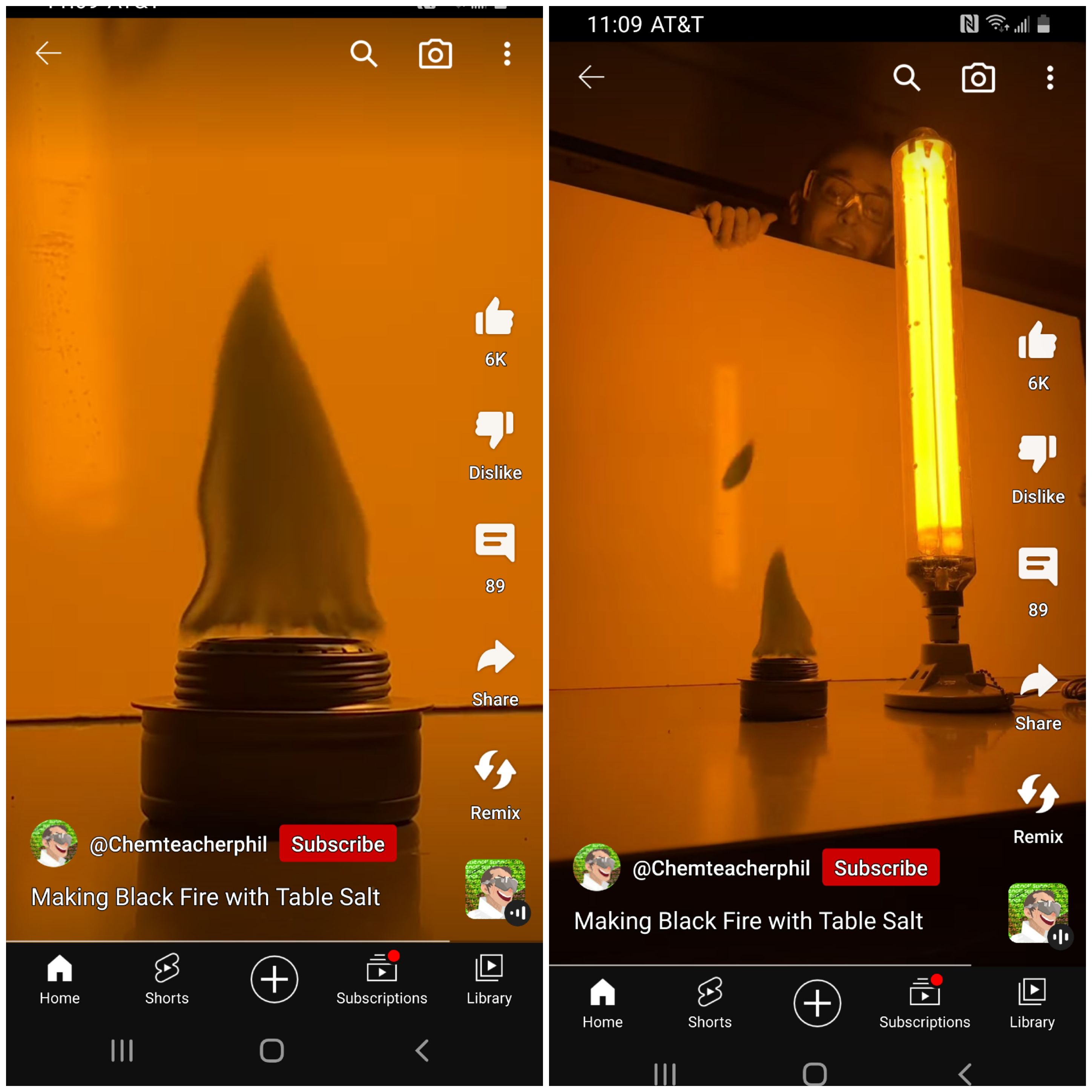

Black Flame?!
A visual effect produced by illuminating a table salt doped alcohol flame which produces the typical orange-y sodium spectrum with a monochrome sodium spectrum electric light. See attached images, check out the linked short video.
https://youtube.com/shorts/uUGzrS5tpLc?feature=share
Now. Where can I get strontium, barium, boron and potassium spectrum lamps- Or other suitably tunable light sources.
And how did I avoid hearing about this effect before?

It seems Physicists and Chemists do not talk with each other very much.
That is a good demonstration of Absorption Spectroscopy.
https://en.wikipedia.org/wiki/Absorption_spectroscopy
I think that a low cost option is a broad spectrum lamp (tungsten halogen, HID etc), lenses and/or mirrors, a diffraction grating and a couple of adjustable slits.
And a lot of miscellaneous materials and work.
A spectroscope in reverse.
I'd expect very low light levels, and a not truly monochromatic light spectrum, but may be zdoable.
If as a hobby project then I'd consider making the narrow bandwidth light source easily reversible to be a spectroscope?
And later as a spectrometer?
I'd consider it, but probably never do it :(
Other than a few industrial applications, and very specific educational purposes,
I guess that spectral lamps would be high cost per use in an amateur setting.

I bookmarked much the same thing a year or so ago intending to show the video to a class. Have not had the opportunity yet.
https://www.youtube.com/watch?v=F0LWtieip9E
I note that there are quite a few videos on this. Most of them shorts.
