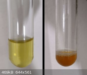

[*] posted on 2-5-2023 at 08:59
Thanks for your replies
Another update on this test. One of the batch of the pale green solution was left overnight and the following day it was bright yellow. To this, H2O2 was added while the solution was still basic, but nothing happened. But after the addition of some acid, part of the solution became blue/purple and then turned colorless, but the most interesting thing is... it separated!
As you can see from the pictures, the colorless liquid is floating on top of the yellow one (which is still basic). Adding extra acid, makes the remaining yellow react and go to blue and colorless and mix with the rest.
What could this immiscible colorless liquid be? So far we hypothesized it was a reaction of Cr VI making the blue peroxocomplex and then going to Cr III, but then the solution should be green, but instead it's colorless and not miscible with water. Any idea?
One additional detail, the basic yellow solution reacts with organic matter like cellulose from wood and turns orange with some brown precipitate, but this could be gunk from the wood bits.
yellow solution with wood chips.png - 469kBimmiscible yellow white solution.jpg - 11kB
Posts: 7918
[*] posted on 2-5-2023 at 09:42
The floating on top is most likely due to difference in density. If you have miscible liquids, but one of them is denser than the other, then they remain separated for quite a while, but slowly they will diffuse into each other.
I think that there is chromium in the mix, but that is not the complete story. The blue color with H2O2 at low pH and the fading of that color is quite specific for hexavalent chromium. Even very dilute hexavalent chromium can be detected this way. Iron could also be present. If you have potassium ferrocyanide (yellow prussiate of potash, K4Fe(CN)6), then you could try adding some of that. With trivalent iron it gives an intense blue color or low to medium pH, which persists. At high pH, the blue color disappears and the liquid turns pale yellow/brown and a little opalescent.

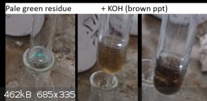

Update
A dried green/white chunk of the raw material was dissolved in water, yielding a rusty precipitate, a dark green solution and some whitish suspension (this solid contains KOH and its pH is >13). This was centrifuged, forming 2 precipitates (a whitish and orange one) and leaving a very intense dark green solution. The dark green solution was isolated.
1) to 1 ml of this dark green solution, HCl was added, turning the solution yellow and producing a brown precipitate (acid pH). To the resulting solution, H2O2 was added, initially turning the solution blue (for 1s) and then pale green/colorless (a separation of the two liquids was observed, as shown in the previous post).
On the pale green/colorless solution, KOH was added again to bring the pH back to 13, turning the solution fully colorless and producing a dark brown precipitate.
2) to 1 ml of the starting dark green solution, H2O2 was added, turning the solution dark orange.
Hypothesis:
1) The starting solution has an intense dark green color, and the only thing I know that is so intensely colored is Cr III, likely in the form of Cr(OH)63- due to the very basic pH.
- Acidifying this solution turns it yellow, with a brown precipitate. The yellow could be attributed to the formation of CrO42-, but which species could be oxidising Cr III to VI, while leaving behind a brown precipitate?
- My hypothesis is that there is some MnO4- or MnO42- in there (the latter being green too!), and that acidifying the solution leads to the oxidation of Cr III to Cr VI, and the reduction of Mn VI/V to Mn IV, which precipitates as MnO2 (brown precipitate).
- Then, following the addition of H2O2 in acid environment, the CrO42- (and MnO2) are reduced to Cr3+ and Mn2+, which leave a pale green/colorless solution.
- Upon addition of KOH, a dark brown solid precipitates. Now, I'm not sure why this is happening. Could it be that the excess H2O2, coupled with the basic pH, is oxidising Mn2+ to MnO2? Usually H2O2 is a strong oxidiser in basic pH (or more precisely, these metal oxides are less oxidising in basic environments), so that would explain the brown precipitate.
2) Upon addition of H2O2 to the raw, basic, dark green solution, the solution turns dark orange. If the H2O2 was oxidising Cr III to Cr VI, this should be bright yellow instead of dark orange (which is typical of acid Cr VI solutions), and if there was Mn in there, not much should happen. The only metal that turns orange in basic H2O2 solutions that I know of, is lead IV/II oxide (Pb3O4).
Do you have any observations or thoughts about what else could be in there?
raw green chunk.png - 838kB raw green + HCl + H2O2.png - 667kB pale green + KOH.png - 462kB Raw green + H2O2.png - 332kB

[*] posted on 5-5-2023 at 01:02
Some more weird things
The starting green, basic solution, becomes yellow overtime on its own. Adding HCl to this solution leads to the formation of a brown precipitate AND negative pressure. It's like it's consuming something from the atmosphere. As you can see in the pictures below, the glove is being sucked in. What could be causing that? I thought oxygen consumption from the air might be the reason, but shouldn't oxygen diffusion be a slow process anyways for this to be noticeable?
Some other tests on the pale green solution, obtained after HCl + H2O2 treatment, which in theory should have left a Cr3+ solution behind (the excess H2O2 was previously decomposed by heating):
- in one test tube of the pale green solution, adding ammonia till basic pH leads to the formation of a light blue/azure precipitate. After centrifugation, it still doesn't fully settle and remains suspended as a light blue gel. Upon addition of KOH, a dense gas is released (probably ammonia) and a brown precipitate forms. After centrifugation, this settles as a brown solid, leaving a pale brown solution.
- in another test tube of the pale green solution, adding ascorbic acid turns the solution light green, and adding KOH afterwards turns it very dark/black with an olive/red weird tint. Adding HCl, makes the solution lighter colored, revealing a dark red hue.
1) If the HCl + H2O2 left a Cr3+ solution, adding a weak base should make green Cr(OH)3 precipitate, but instead an azure precipitate is obtained. Could this be an amino-compound with Cr? I remember seeing something similar in Woelen's wegpage about Cr III. Adding KOH should in theory reverse the entire reaction and take us back to the starting dark green solution, hypothesized to be Cr(OH)63-, instead a dark brown precipitate forms.
2) Due to the acid pH, ascorbic acid should be in its protonated form and shouldn't be acting as a chelating agent, but could still be acting as a reductant. Are you aware of a reaction that turns pale green to light green? Adding KOH makes a very dark solution, that lightens up only upon addition of HCl.
I still think there's some Cr in there (because of the temporary blue complex) but what else could be giving these reactions? And why are we unable to revert back to the dark green solution?
Is anyone familiar with ascorbic acid and what metal complexes it might make? Or perhaps if in these conditions it is acting as a reductant. Are any of these colors familiar?
pale green + NH3 + KOH.png - 557kB vacuum.png - 340kB pale green + ascorbic + KOH + HCl.png - 458kB
[Edited on 5-5-2023 by Metallus]
