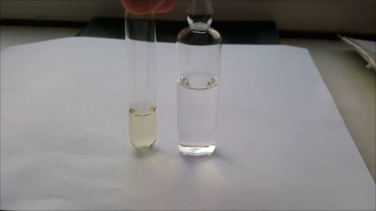

I filled all of the hydrogen cyanide in ampoules and sealed them with a bunsen burner.
Momentaufnahme 12 (23.01.2024 02-27).png - 142kB
After more than one year, the HCN in all of them is still crystal clear. I also made some unstabilised HCN (without phosphoric acid). After one day, they looked yellowish (left ampoule):
Momentaufnahme 13 (23.01.2024 02-27).png - 111kB
After one year, the unstabilised HCN formed a brown solid (left ampoule).
Momentaufnahme 14 (23.01.2024 02-27).png - 196kB
Momentaufnahme 15 (23.01.2024 02-28).png - 221kB
So even 0.05 % of phosphoric acid prevents this polymerisation reaction for more than one year (according to the literature: even much longer).

- qualitative HCN test (paper)
- pur HCN into ethanolic KOH solution to show the formation of a salt
When this is done, I can finish the video and upload it somewhere.
