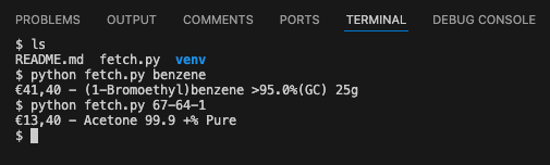

It was a bit more dififcult to do in javascript, so I decided to do it in python. When I am done, I can always just do it in JS afterwards too.
Anyway, this is how it's looking in a console app so far. I am still adding the shipping, quantity, notes, etc.
I still need some beta-testers, if anybody is interested? I am still not done for the beta-version yet, so it's going to take a while still.
Also, it is a bit more difficult for elements. For example if you search "sodium", the top results are sodium chloride, etc, but I'll get to fixing
that.

Couple of questions,
- You said this will limit the scope to suppliers that sell to individuals. How about for specific products? eg: Carolina Chemical sells to
individuals, even 1L of H2SO4. But if you try to buy the 2.5L (or larger) bottles of H2SO4 then they require that you be a school or run a business
(and ship to those addresses)
- How does this pull the prices? Did you go to each individual supplier and see if the frontend sends requests to a backend API, then use those? Does
it just scrape the HTML for simpler websites? I'm hoping you have some simple modular system that allows for small changes (eg: if the paths or ID's
of the elements change, they use pagination, etc).
- Do the results get cached for any amount of time? eg: If the same SKU or CAS gets pulled up in different search results, it might not make sense to
query/parse the same web page/product multiple times within 24 hours).
- Is this going to be open source?
Hopefully you're structuring it so that there's just some logic module that does the data, then that can be used in either a CLI client (like what
you're showing) or use something like FastAPI to create a basic web client.
I'm a software engineer, I do NodeJS for my professional job but I do a bunch of Python on the side (mostly for 3D printing related, eg: moonraker),
and I'd love to see the code for this :-) (show me yours, ill show you mine).
Maui3
Posts: 142
Registered: 9-9-2024
Of course! I love you alls questions and feedback!
1: I have not checked the website for Carolina Chemical, but for some of the european ones there will be a little popup saying that it is not sold to
private individuals above a certain concentration or amount. My python script could potentially check for that.
2: This was very difficult to get to work, so the way it works right now is like this: It uses the search link, for example: "example.com/search=" +
the chemName. Then it uses beautifulsoup to extract the HTML, where it finds the product and price from their classname. As you noted, this can be
quite unreliable - so I am definitely also considering possibly doing a daily check for each of the websites in the sitemap.xml (since it'll take too
long to do for each individual search), whereafter it'll find the product name and price - possibly by finding the first currency-symbol and then the
closest chemName to the price-element. Of course chemical names differ, so it'll run through the Pubchem API for all of the synonyms.
3: That's kind of what I considered too (like I said in 2) - but so far it only checks for individual searches. There is not database, yet. I also
thought that if I was to do this, I would do it as one of the last things, since making it extract the price and chemical name is the most important
thing.
4: Yes, of course! Besides, if the chemical suppliers websites whole system and URLs change, I would much prefer if it could be fixed by others than
me. Also, I am just a amateur chemist and amateur programmer, it would be very ineffecient and ignorant to only let me edit it and understand how it
works.
Yes I am structuring it like that.
Oh, maybe you can help me with some of it then - I will definitely need help at some point.. probably more than just one point. If you would
like to help me with whereever I need help, I'd really appreciate it.
Yes - I'll show you the code. It's structured quite poorly now - with variables that are.. well.. badly named. I'll fix it and send it to you in just
a bit. Where (and how) would you prefer me sending it to you?
EDIT: I would loved to have used the suppliers APIs, I really would - but most of the suppliers never replied back to me after I told them I would
like an API. There was one that replied back saying they'll send my message to their "tech-team", after which they could send me the API. It's been
three months, they have no intentions on doing that.
[Edited on 9-2-2025 by Maui3]
SuperOxide
Posts: 539
Registered: 24-7-2019
Location: Devils Anus
Quote: Originally posted by Maui3  | 1: I have not checked the website for Carolina Chemical, but for some of the european ones there will be a little popup saying that it is not sold to
Carolina Chem is an easy one for this, it always just says "This item is sold and shipped to schools and businesses only.".
I've had to automate stuff like that. It's... even less fun than it sounds, lol.
A lot of these websites keep the chemical synonyms paired with the listing, so typically searching for any of them should return the same product (at
least on a few that I tried).
three months, they have no intentions on doing that. |
Well, sir, since it would be a client side API (if its used on their website), just keep an eye on your networking tab of your browser.
Example of how to do it with LigmaAldrich
1) ProductSearch query:
gets a response with unique product keys:
2) Using the unique productKeys, request the Pricing and Availability endpoint:
Which will give you the price:
I think this would almost have to be done for some of them that populate the UI using RESTful calls from the client side. Otherwise, whats the best
option? Launch a headless browser to track the client side requests? Way more tedious.
thing.
I guess this comes down to if you want it to be a stand alone client, or a service you provide? (Or either?) If its a service you provide, I would
have it cache the prices only on the first time its requested, and have a TTL for the prices that can expire, and only then will new requests for that
item trigger actual price updates.
If its a stand alone client, then I would do the same thing, but store it in a sqlite database.
works. |
Excellent! Open source is the way to go.
This is something you really need to put some time into and think about. It looks like you're just developing a Proof Of Concept right now,
so its not a huge deal, but when you work on the first release this is something that is key. Every website operates differently, but you want the
same data. So I would create it in a way that each site has its own module that just takes an input, then it can go about getting the data (cache,
RESTful API search, HTTP requests and parsing data, etc), then return a simple object with the results. Obviously each one should be in its own file,
making it super easy to replace/update them when needed.
That's a bad sign, though I'm guilty of it as well. If you're doing this in Python I would highly recommend putting a hold on your coding and read

P.S.S. Here's some very crude python to grab the cheapest price for whatever the search string is:
Attachment: php8vYt1p (18kB) This file has been downloaded 32 times
Obviously you would want some logic that would make sure the result item you're analyzing is actually what you searched for. You can see I searched
for benzene and it returned (1-Bromoethyl)benzene >95.0%(GC) 25g. But if I searched for the CAS of Acetone, it returned
acetone.

Quote: Originally posted by Maui3  | Yes I get what you mean, their websites search function is not very nice for IUPAC names. I think we will do CAS-numbers instead, then.
Yeah, the thing is that people are probably going to want to search for names too. And what if not all websites allow you to search by CAS?
What I would do is allow someone to type in a CAS or chemical name, then you query Pubchem to get a list of chemicals with that name in the
title (obviously putting exact matches at the top of the list, since they're most likely the correct one), and allow the user to select the chemical
from that list. That way you know the exact name and CAS number, allowing you to search for either (or both, if applicable). This would be a
property you would include in the module for each vendor (eg: allowsCasSearch) to see if you can just jump right to the CAS search instead of
Name search that you then need to verify the CAS for on each (if possible).
I think this is a good approach, because if someone searches for a chemical with the name Supercalifragilisticexpialidocious, you don't
really want to query every website for that name if you're fairly certain it doesn't even exist, right? Just a thought :-)
