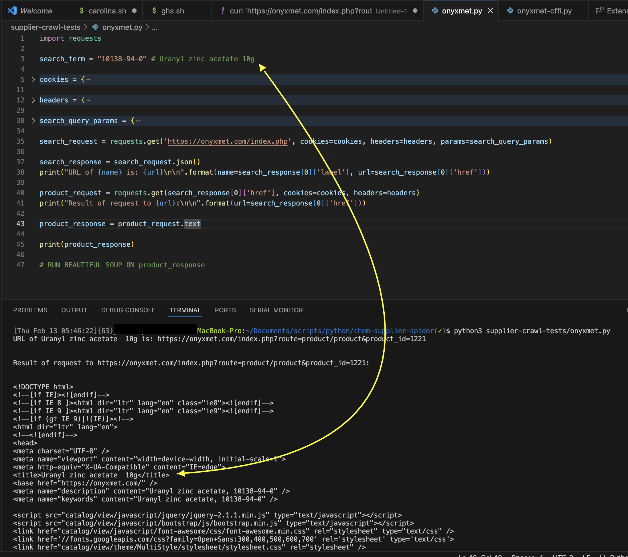

Try doing what I did earlier (in this video):
  1. Open up developer tools in your browser (In Chrome/Brave, its at View > Developer > Developer Tools)
  2. Go to the Network tab, click Preserve Log
  3. In the same window, try to perform an action that will trigger the call you want to make in your app. (This is easier if you filter it to only show Fetch/XHR and Doc requests)
  4. When you see the XHR or Doc call in the network tab, right click on it > Copy > Copy as cURL
  5. Go to curlconverter, paste the cURL request and select Python. You should end up with something like this.
  6. Try to copy/paste that to a local script. Remove any session specific cookies. Run it.
  7. Use the BeautifulSoup thing on the result output
Let me know if that works out.
Once that works, see if you can take a short cut and just use a python library to spoof a browser by using something like curl_cffi.
And if you send _too_ many curl requests, they may block you as a spammer or a bot. I would recommend doing a few requests you want, save the responses to a separate local file. Then in your code, stub (mock) the responses from the remote server by just importing/including the downloaded file. Then you can continue on as if that's a real response. Once your code is ready to be tested, remove the stub and run it.
Feel free to share the code on Github so I can check it out.

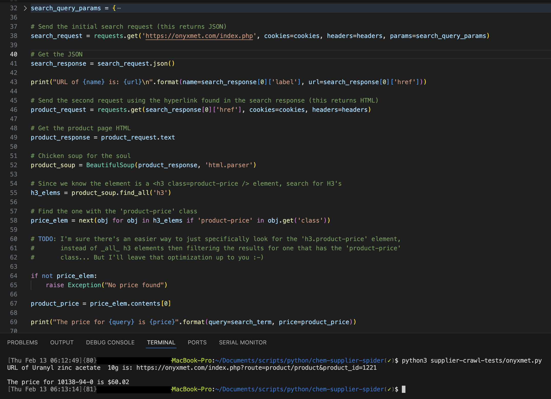

I updated the gist to include a customized python3 script that sends a product search query using the CAS on Onyxmet, then grabs the URL for the first result and curl's that page for the actual product details. Try running BeautifulSoup on the product_response variable at the bottom.
Screenshot in the attachment:

I updated the working_requests_example.py script to even get the price from the product page using BeautifulSoup.
Attachment: phpWiDJG0 (430kB)

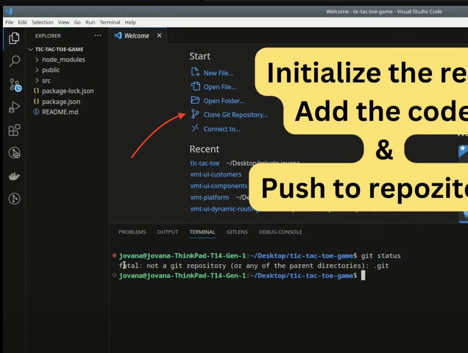

That's very simple. Did you read/watch what I linked you to earlier? It should be like 5 minutes to read/watch, and youll see what I mean.
Quote: Originally posted by SuperOxide
But, first things first. Do you use Git (revision control)? If not, start using it. Sign up on Github.com (free), create a repository for this project, then install git on your local machine and commit some code to it. Start checking in your changes so you don't lose any of your files or anything.
- Install git
- Create a repo and add some code to it
In the 2nd link (starting at 0:29), you can see how he adds his local code to it.
Alternatively, you can download VisualStudio Code, which is what hes using in that video, and instead of doing it via the CLI, you can just select "Clone github repo, then give it the git repo URL, it checks it out, and you add your code and commit/push.
Attachment: phplY2wEm (1.3MB)
This file has been downloaded 41 times
I have to work now, but maybe we can set up some time to hop on a video conference call or something and I can walk you through it.
