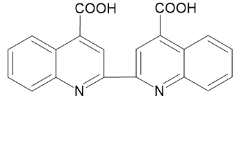

I investigating possible -N=C-C=N- type ligands of the bipyridyl type. One such ligand that caught my was 2,2’-bis-cinchoninic acid:
02-bis-cinchoninic acid.gif - 5kB
While looking for a synthesis for this compound, a search of the technical literature led me to the Pfitzinger reaction as the most likely route.

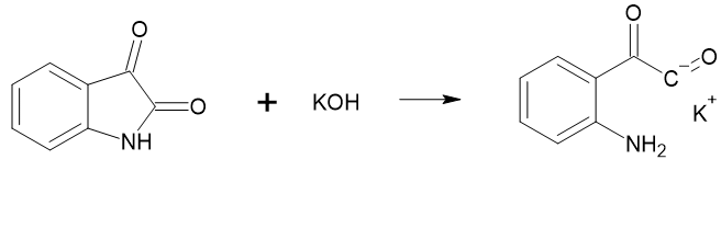

This reagent is prepared by the condensation of a biacetyl proxy with isatin in strong potassium hydroxide solution. I tried this reaction with biacetyl itself and it forms only tar. This is confirmed by the literature which indicate that 3-hydroxybutanone (acetoin)(1) or 3-chlorobutanone(2) are usually used as a proxy for diacetyl, biacetyl-monoxime may also work.
In its original form the Pfitzinger reaction comprises the condensation of isatin with an aldehyde or ketone, that contains a methyl or active methylene group adjacent to the carbonyl group, in potassium hydroxide solution to give 4-quinoline-carboxylic acid (cinchoninic acid) or a derivative of it. The reaction was originally described by Pfitzinger in 1886(3a) with isatin and acetone to give 2-methylcinchoninic acid (2-methylquinoline-4-carboxylic acid) and with more varied substrates in 1888(3b). Cinchoninic acid itself can’t be prepared from isatin and acetaldehyde, probably due to the instability of the latter in strongly alkaline solutions. Subsequently the reaction has been extended into a fairly general synthetic tool. When isatin dissolves in a strong alkali solution it initially gives a deep purple solution from the deprotonation of the isatin but this quickly fades to a pale straw colour of the potassium isatinoate:

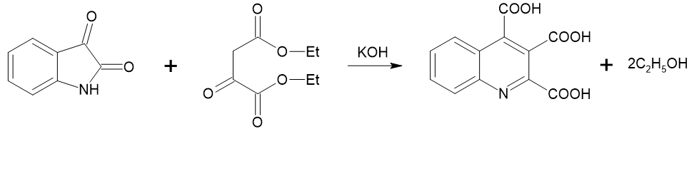

With diethyl oxaloacetate the reaction is:
05-isatin-oxaloacetate.gif - 8kB

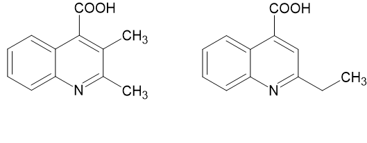

Theoretically, butanone can give rise to two possible products, 2,3-dimethyl-cinchoninic acid and 2-ethyl-cinchoninic acid:
11 dimethyl-ethyl acid.gif - 5kB
However, the original literature(6) claims that only the 2,3-isomer is produced though later researchers refute this claim, stating that a small amount of the 2-ethyl isomer is also formed. All, however, agree that the 2,3 dimethyl derivative is the major product.

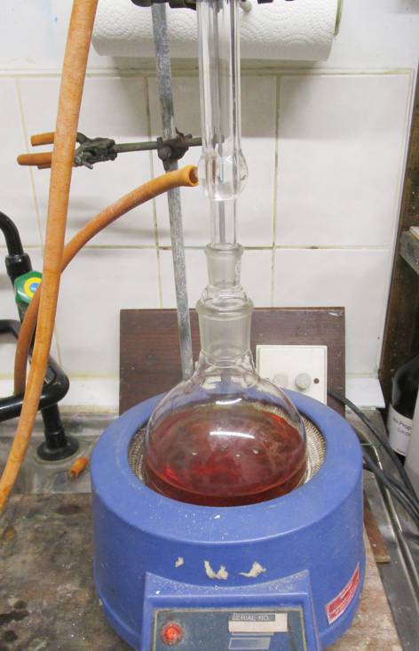

This procedure was based on that of Pfitzinger in his 1897 paper(6). The procedure was carried out twice, this description is based on the second, larger scale, experiment.
30.38g (approx. 0.2 moles) of isatin were dissolved in 450ml of water and 130ml of 50% sodium hydroxide solution and stirrer gently until the initial deep purple colour has change to a light straw brown. 60ml of butanone were then added all at once and the mixture gently refluxed for 8 hours.

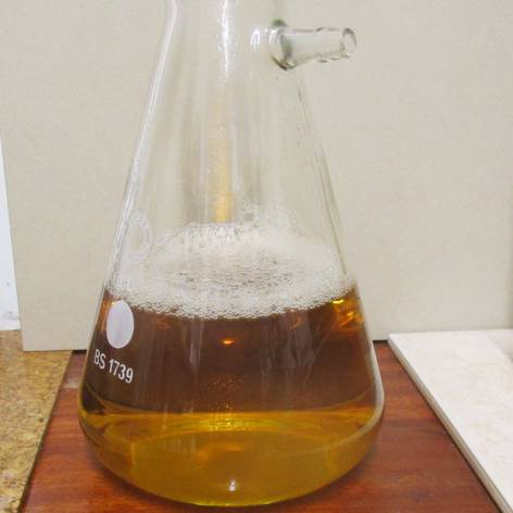

01 refluxing reaction mix.jpg - 58kB
Start of the reflux, the brown colour develops quickly.

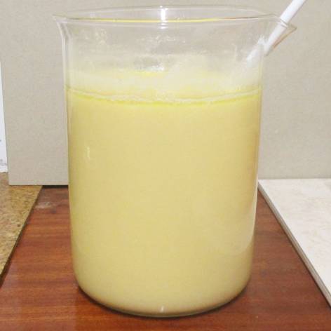

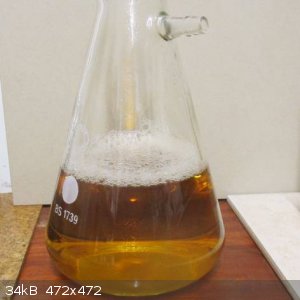

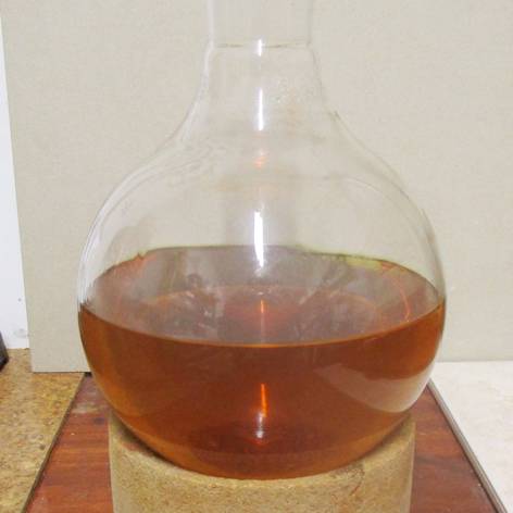

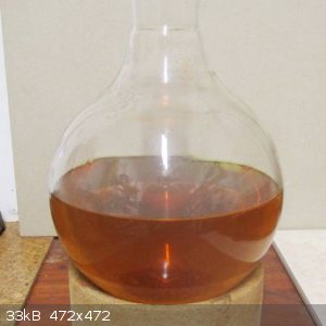

02 final reaction mixture.jpg - 33kB 04 neutralised solution.jpg - 33kB
The final reaction mixture, nothing much appears to have changed. The tar precipitating from the mixture on neutralisation

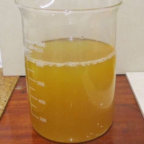

05 filtered solution.jpg - 34kB 07 acidification complete.jpg - 31kB
The solution after tar removal. The free acid ppt at pH circa 2-2.5

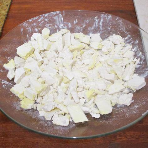

08 crude filter cake.jpg - 50kB
The raw dried filter cake

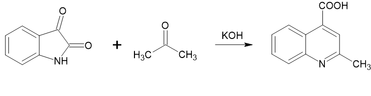

2-Methyl-quinoline-4-carboxylic acid (Quinaldine-4-carboxylic acid)
14-quinaldinecarboxylic.gif - 3kB
This compound was prepared by an almost identical process to the previous compound but substituting acetone for butanone.
30.210g of isatin were dissolved in 500ml of cold water and 150ml of 40% sodium hydroxide solution. When the initial violet colour had faded to a straw brown 60ml of acetone were added all at once. The solution was refluxed gently for 8 hours during which time little appeared to change.

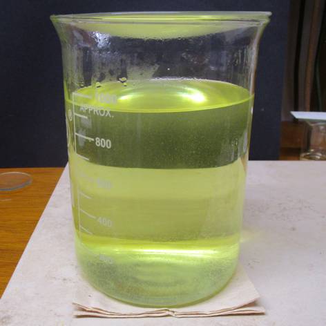

11 recrystallising 2-methylcinchoninic acid.jpg - 37kB
The clear filtered solution just starting to crystallise

This synthesis is based on the procedure given by Halberkann(7). Due to the sensitivity of diethyl oxaloacetate to alkalis the procedure for this compound is slightly differently. The reaction is carried out at room temperature or just above and as a result the reaction time is long (more than 2 days). Attempt to reduce the time by increasing the temperature and adding the sodium diethyl-oxaloacetate in small portion over the reaction time failed to improve then yield, in fact the yields at elevated temperatures were always poorer and the product contaminated with increasing amounts of tar. A large excess of oxaloacetate is also required to compensate for the loss due to side reaction.
3.800g of isatin were dissolved in 24ml of 50% potassium hydroxide in a small conical flask by shaking vigorously. 13.452g of sodium diethyl-oxaloacetate were then added followed by a further 6ml of 50% potassium hydroxide diluted with 15ml of water. The mixture was swirled around to dissolve the solids and warmed gently (to a max of about 34-40°C) until most of the solid had dissolved. A small amount of fine solid remains undissolved. The flask was stoppered and the light brown solution was then set aside for 2 days.

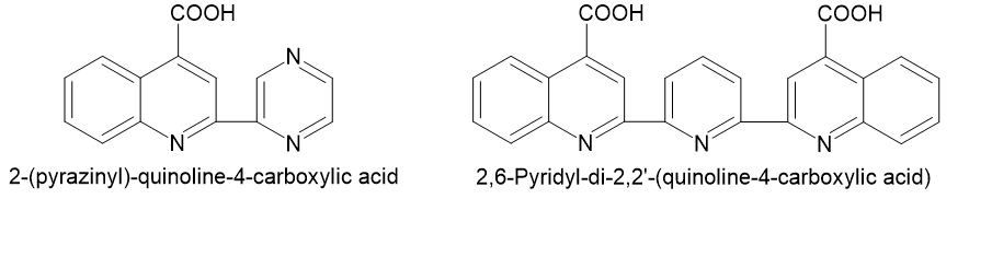

2-(2-pyrazinyl)-quinoline-4-carboxylic acid
16 pyrazinyl acid.gif - 4kB
The original target of this reaction was to have been the 2-pyridyl- derivative but 2-acetylpyridine is hard to get and expensive so the experiment was run using 2-acetylpyrazine which is now a readily available flavouring compound. A small-scale experimental run using 1.5g (c 0.01M) of isatin was carried out first and based on the observations the follow larger scale procedure was used:

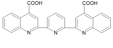

2,6-Pyridyl-bis(2-quinoline-4-carboxylic acid)
17 pyridyl-bis-acid.gif - 5kB
Although I didn’t have access to 2-acetylpyridine and had to substitute it with acetylpyrazine I did have some 2,6-diacetylpyridine and decided to give the double Pfitzinger reaction a go as it should yield an interesting tridentate ligand. In most Pfitzinger reactions I have used an excess of the ketone component in an attempt to minimise the amount of residual isatin in the product as it is often difficult to remove, however, in this case an excess of isatin was used to ensure maximum utilisation of the precious 2,6-diacetylpyridine.

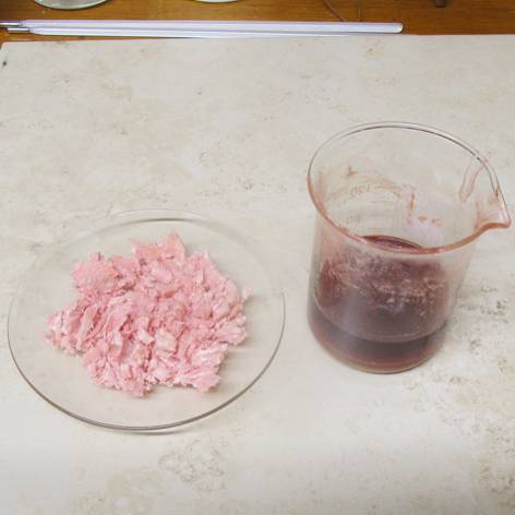

After the reflux was complete the reaction mixture was poured into 100ml of cold water and chilled to 4°C. The red mixture almost solidified on cooling. It was stirred up and drained hard in a Buchner funnel and the cake washed with a little cold isopropanol. Air was drawn through the cake and then it was dried at 35°C to constant weight yielding 10.520g of slightly pinkish cake of the dipotassium salt, presumably as a hydrate.
03 crude potassium salt.jpg - 36kB
The filtered of and isopropanol washed K salt and the red filtrate

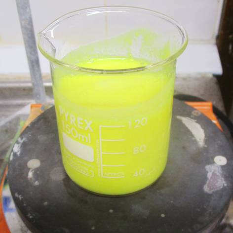

04 liberated acid.jpg - 34kB
The acidified K salt solution, the bright yellow free acid precipitates.
