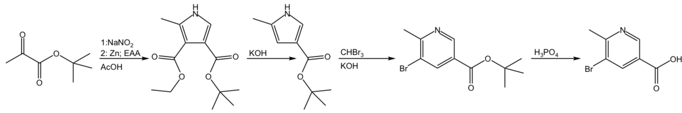

As it’s a 3-bromopyridine I thought of potentially using a Ciamician-Dennstedt rearrangement, to go back to a pyrrol which may be somewhat easier to prepare by classic carbonyl reactions. Knorr-pyrrol synthesis is the obvious option for that, and with that I came up with this path starting from tert-butyl pyruvate (should be available by simple Fischer esterification) and ethyl acetylacetonate (available by Claisen condensation, but also cheaply commercially).
Due to the conditions of the second and third step both being similar one may be able to combine those in a one-pot sequence (with some trail and error).

@Niklas What is going on in the first 3 reactions shown?

First step is a crossed Knorr pyrrol synthesis (the aminoketone being made in-situ by making the oxime by nitrosation followed by zinc reduction) (https://de.wikipedia.org/wiki/Knorr-Pyrrolsynthese), the second step is a simple ester hydrolysis (t-butyl ester being resistant because of sterics), and the third reaction is a Ciamician Dennstedt reaction (https://de.wikipedia.org/wiki/Ciamician-Dennstedt-Umlagerung).
