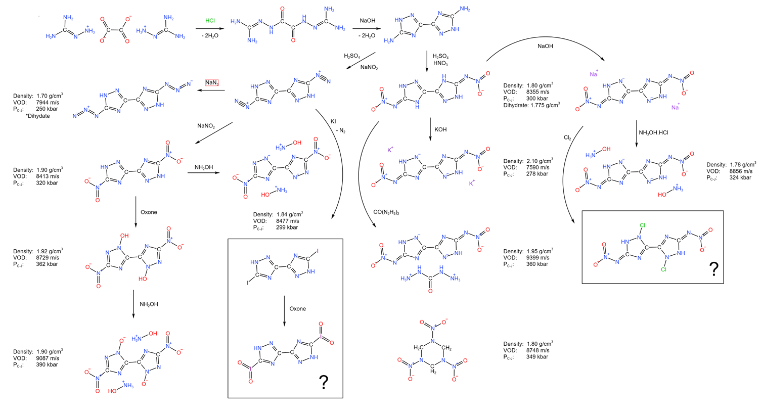

The oxidation to the highest performing diol designated "MAD-X1" is in the attached patent. It's essentially TKX-50 with two of the N's replaced with C-NO2.
A couple speculatory reactions are in the scheme attached. it may be possible to chlorinate the sodium salt. Chloramines of this nature are generally much more sensitive than the parent compound but less stable. It might also be possible to drop a diiodo compound from its diazonium salt and oxidise to iodyl with oxone (a pool chem). This would most likely have primary and initiatory properties if possible.

Attachment: bis(aminotriazole) and derivatives.pdf (896kB)

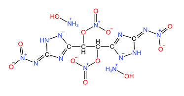

Proposed tartaric acid derivative is attached.

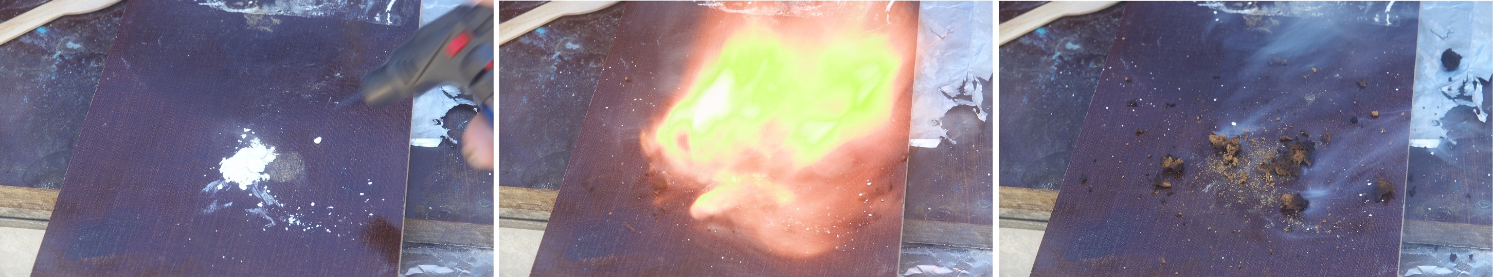

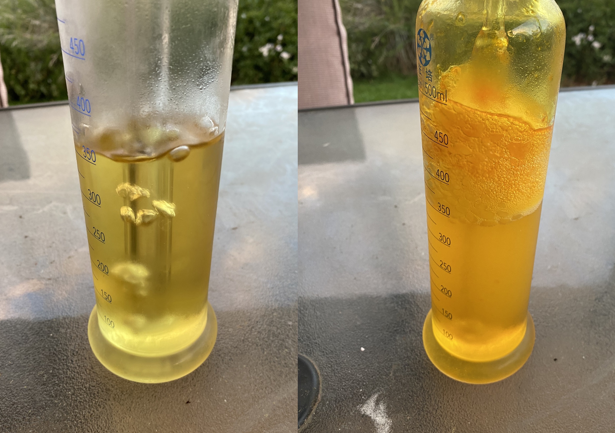

I ran a test, without acidifying the diazotisation liquor and I will say the result was a little disturbing.
As per your description Microtek it foamed up quite a lot in the final stages of the DABT/H2SO4 addition to the nitrite. And was thick with a buff-coloured precipitate. I filtered this directly without acidification, washed through with water then boiled the wet cake.
The recrystallisation liquor turned orange and was filtered, which only captured a very small amount of solids even though the liquid stayed turbid. On cooling a crop of very fine salmon coloured powder formed that is difficult to filter, rapidly clogging it.

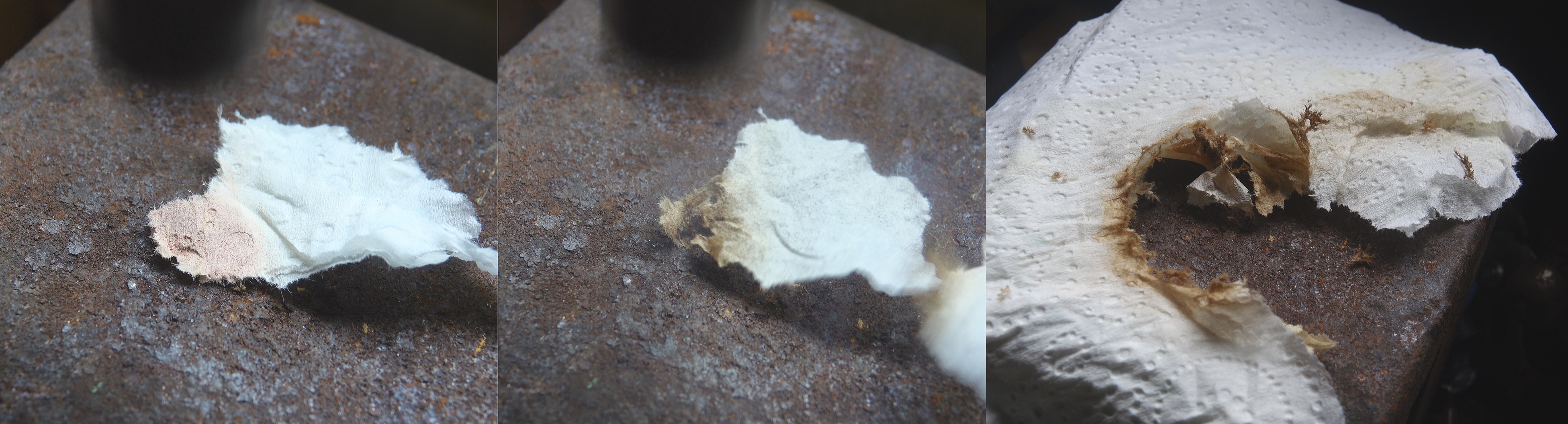

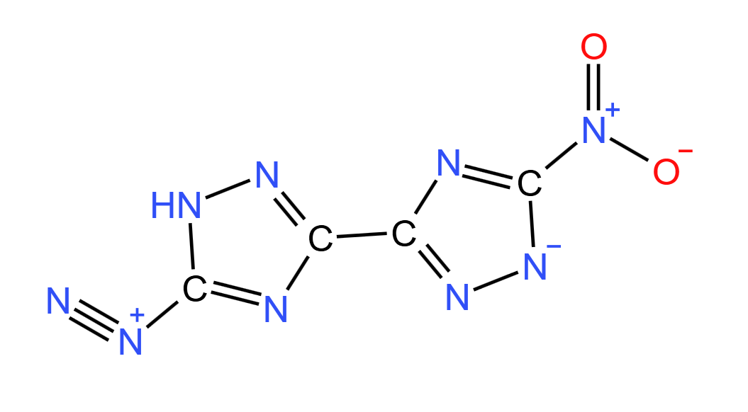

This salmon powder is a primary explosive as vehemic as any I have ever seen. I don't know what it is, but it is very sensitive to the point where I wouldn't have expected it to be the sodium salt of DNBT, not that its properties are given in the literature, so I really can't discount it for sure.
One guess would be a zwitterionic diazo compound, where you have half substituted nitro and the other side a balancing diazonium group similar to DDNP, structure attached. I cannot stress enough how dangerous this stuff is, some impregnated into absorbent paper and dried detonated when the paper was torn.

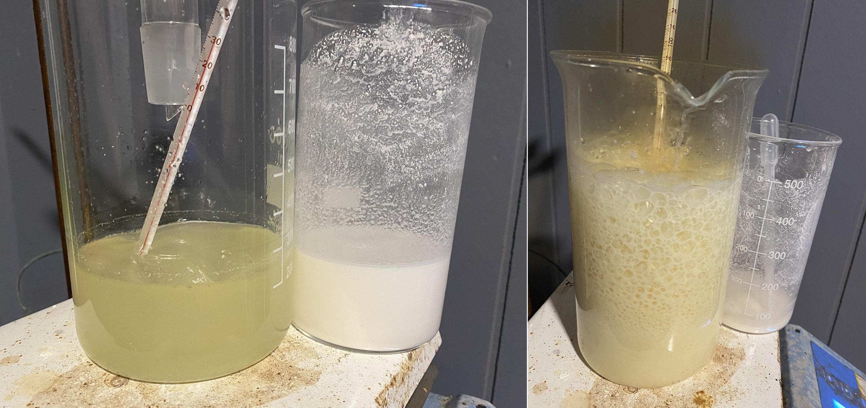

On a separate note, chlorination of the sodium salt of the dinitrimine does not form the expected chloramine, it seems to break the ring and gas off. The highly staining yellow product that forms is non-energetic.

DiazoNitroBistriazole.png - 38kB

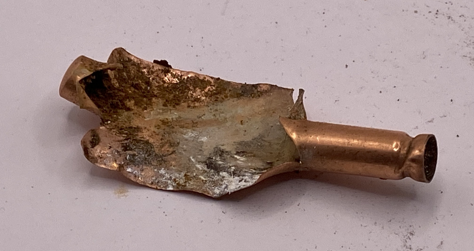

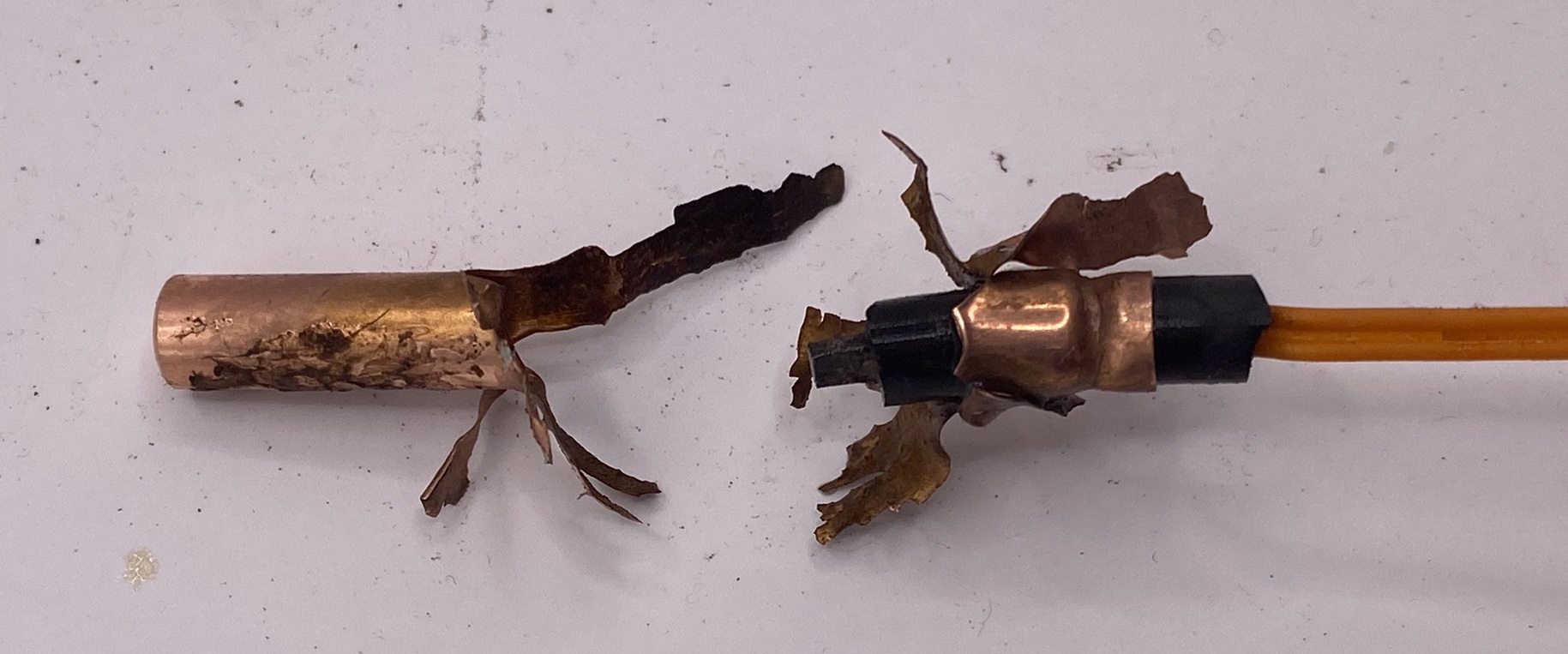

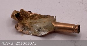

Finally I tested detonability by hand pressing 600 mg in a 7 mm ID brass tube and initiated it with 50 mg uNAP --> 300 mg RDX.
Full detonation was achieved. I have yet to do a plate dent test to compare it with other energetics, and I haven't measured density yet either.

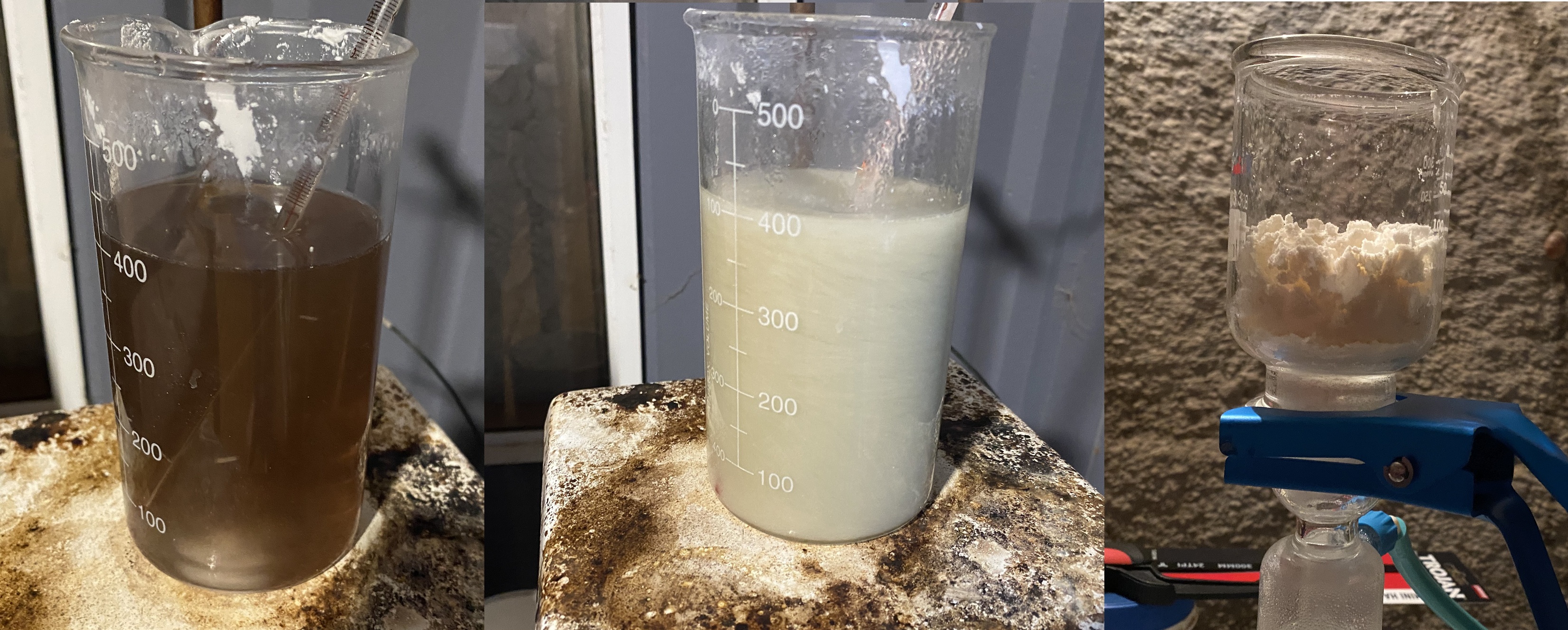

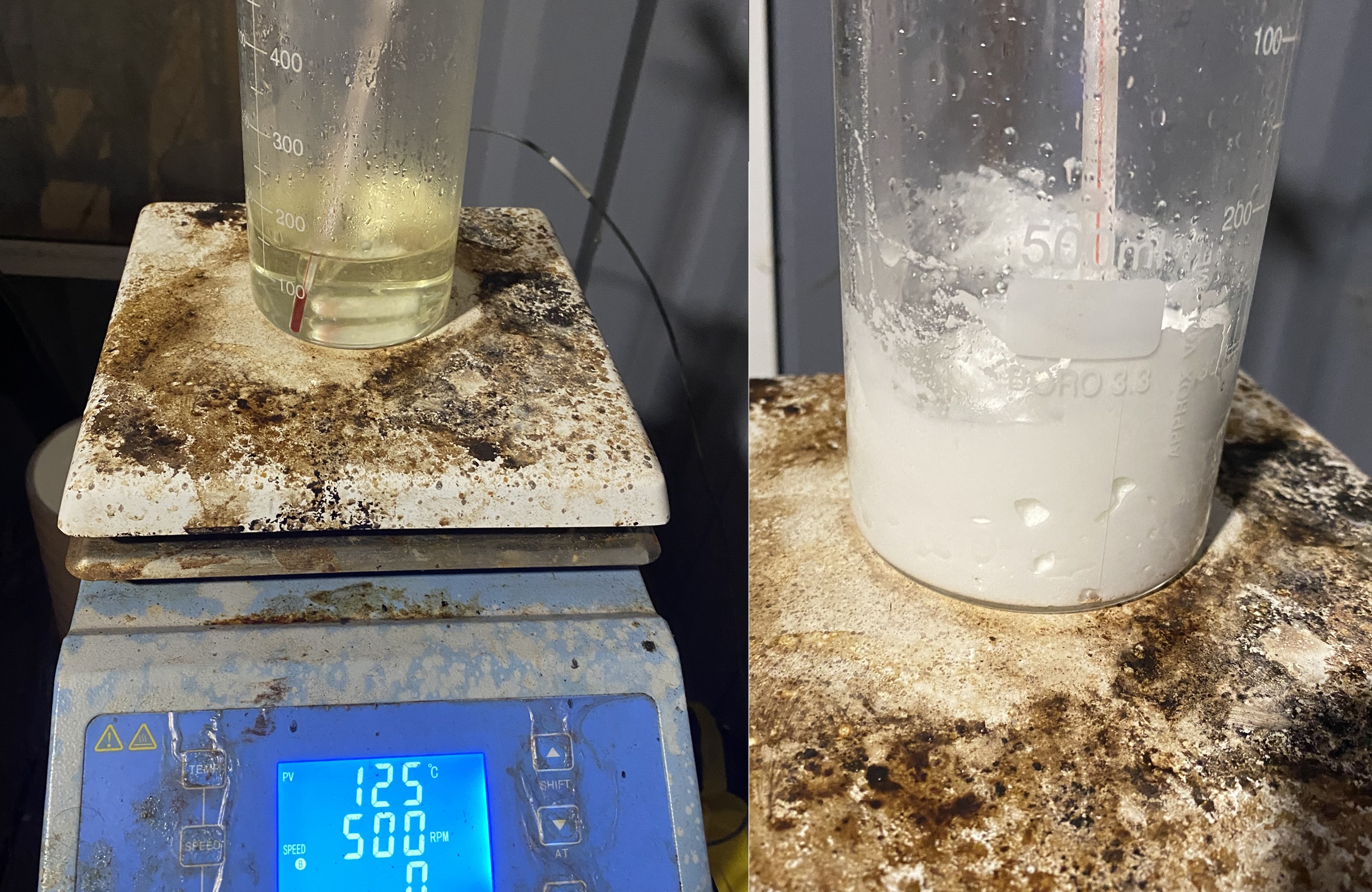

1st is the initial oxalic + aminoguanidine condensation. I did this before having the full information, so I used less HCl solution than the literature and as a result solidified, although this didn't seem to affect the yield.
2nd is the cyclisation in NaOH, wasn't expecting it to turn brown-grey, not sure if that's a result of the drain cleaner NaOH or not. The cyclisation went fine though and readily precipitates.
3rd is the nitration to the dinitrimine, it readily dissolves in the concentrated acids and precips on dilution. I used the round flask thinking I could better cool it, but it was still impossible to keep near 0C. I'm sure a beaker would work just as well and be more convenient.

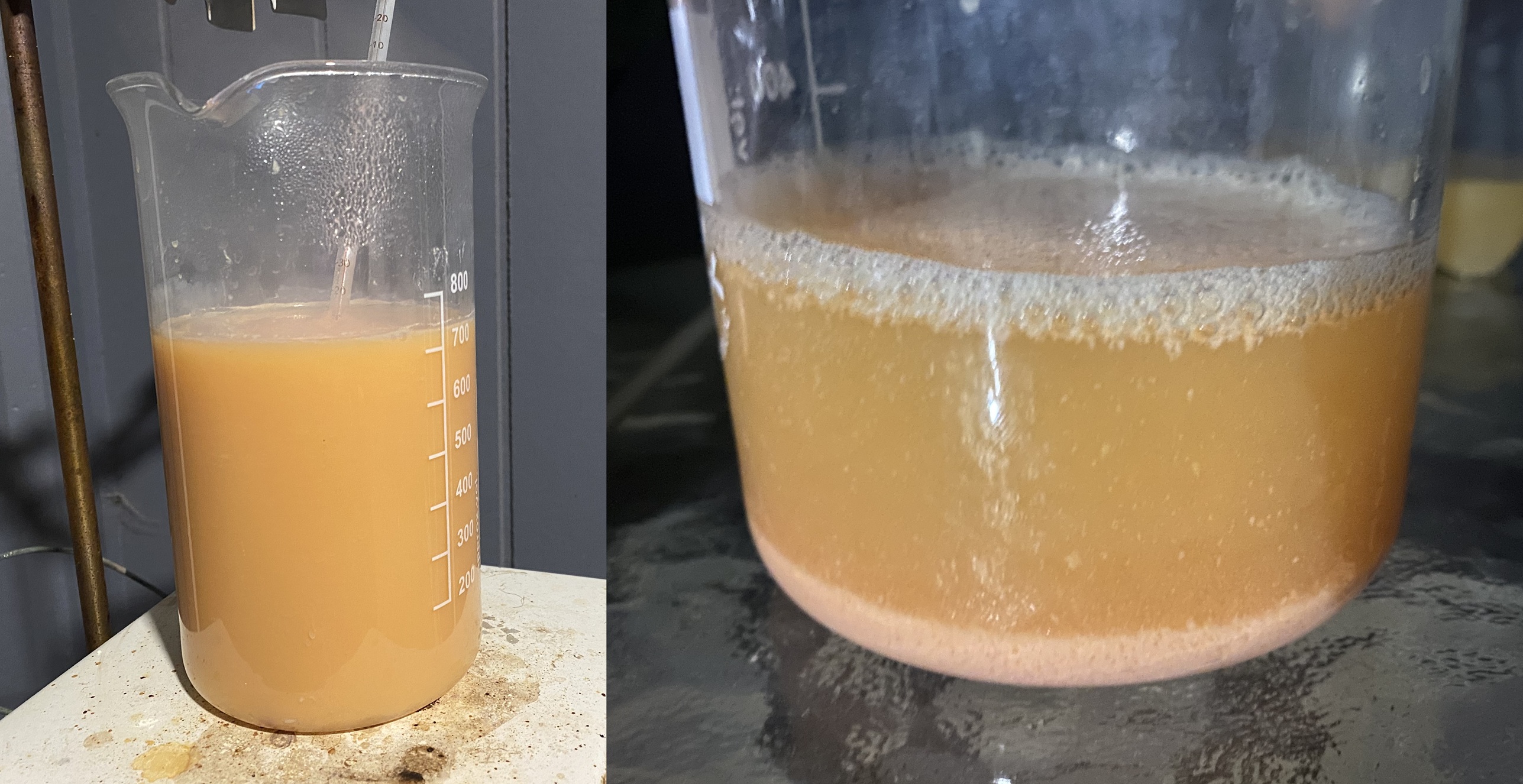

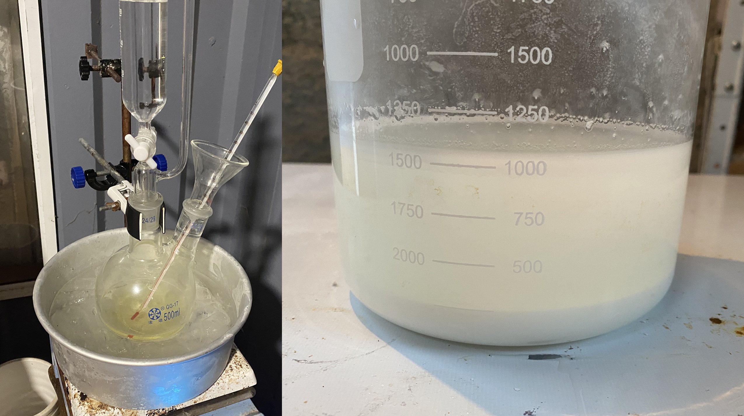

4th is the diazotisation of DABT, this is using the patent quantities. A 1L beaker is required to contain the foaming. I followed the patent apart from not acidifying the mixture to destroy the nitrite at the end. the 5th pic shows the result of this.
5th is the recrystalisation of the diazo product, the turbid orange solution passes through the filter and deposits a salmon powder of cooling.
6th is the salmon powder impregnated in absorbent paper, it detonated on a light tap of a hammer and then when I attempted to tear off a bit more it detonated from the simple act of tearing. I watered the rest into the lawn to dispose of it.
7th is the failed chlorination, it gasses and foamed off to a non-energetic yellow precip. The glass is still stained bright yellow.
