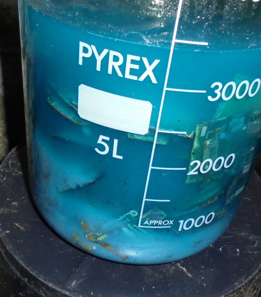

Cu(NO3)2 + Sn = ?
CuNO3 + Sn = Stannic acid and no visible displacement, nitrate was lightly acidic.

Did you get any fumes? Any precipitate? Color shift?

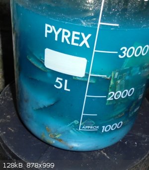

No fumes, precipitate white jelly Stannic acid, blue solution before and after addition of Sn.
DSC00099.JPG.2a955dd456bbf3d35ae045b8eb751db7.jpg - 128kB

The stannic hydroxide ppt is going to be voluminous. Leaving it sitting for a while, and you'll probably start to see copper metal forming.
Was there for couple of days, with out any visible displacement.
Maybe not enough Sn and solution too acidic, I will try this experiment again.

@Romix: In the picture you posted, it appears that you'd started to dissolve circuit boards in the solution. Was this after the tin, or was it your source of tin?
Source of tin.

Source of tin and lead, you mean.

Source of tin.
No, lead free solder used on PCBs.

Source of tin and silver, then. But remember that not every PCB uses lead free solder, what with those damned whiskers and all.

And probably several other metals.
No, only Tin able to displace in these.
