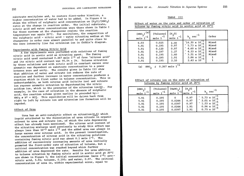

You don't need - want to use RFNA. RFNA is an oxidizing agent...
think rockets.
http://en.wikipedia.org/wiki/Red_fuming_nitric_acid
If you can't dazzle them with your brilliance ... boodle them
with your references.
This from :—
Hanson, Pratt & Sohrabi
Some Aspects of Aromatic Nitration in Aqueous Systems
In:— Industrial and Laboratory Nitrations
American Chemical Society
ACS Symposium Series 22
1976
I would be less then honest if'n I didn't note - that I assume
they used RFNA and not WFNA.
There is a large amount of literature on theory(ies) of nitration.
I am not planning of going through it here.
