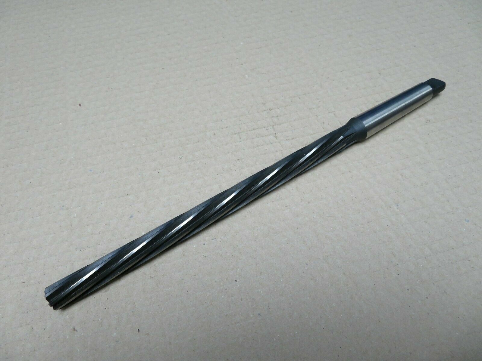

Would a reamer be a good starting point for getting the Al or Mg into a state good for ball milling. A reamer as pictured would be easy to drive with an orginary drill. Put perhaps a bearing on the side away from the chuck and bolt the drill and bearing down to a bench. You could feed the bar of Al (or whatever) between the reamer and a steel plate that is also attached to the bench. The plate would need to be adjustabe upwards towards the reamer to shave layers off of it.
A reamer in conjunction with the lathe and you would be on the pigs back!
Yob.

Thanks for the suggestion, Yobbo.
I have found a step drill is excellent for getting turnings. So no need to worry about that.
