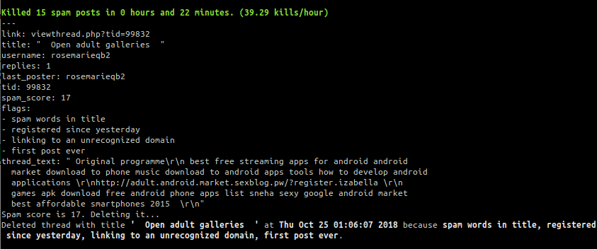

BotKilla in action.
I sort of gave it an overhaul today, that allowed me to run the spam tests independently of the main script. This makes it a lot easier for me to test spam that isn't caught in the filter and quickly write and test new rules that might do a better job of catching it.
Any spam that does get through the filter, it'd help to move it to Detritus so I can take a look at it later and see how it got through.

Are you checking for false positives?
Melgar
Anti-Spam Agent
Posts: 2004
Registered: 23-2-2010
Location: Connecticut
Mood: Estrified
[*] posted on 25-10-2018 at 13:33
Yes, so far just that one, and that was because of a glitch in the way links were checked against the whitelist. I PMed him and told him what happened, and included the text of his post in case he wanted to repost it. I don't think he's been back in a few days though. Once I fixed that glitch, it no longer got flagged. Really, the scrutiny is just a lot more on recently-registered users, especially when posting links. His link would have been whitelisted though, had the whitelisting been working correctly at the time. I also raised the threshold for what gets deleted and added a few more conditions that can trigger additional flags. The "linking from unrecognized domain" flag has really been a key predictor of spam, by a long shot. And the "registered today" flag too, just because it focuses on the narrow subset of members who post 99% of the spam.
The algorithm has worked flawlessly, actually, it's just a stupid bug in my code that was responsible for that one false positive. :P

I only have moderation privileges, I think banning someone requires an admin. Not that it matters, since it looks like spam is almost always deleted within a minute after being posted. Really, this is a temporary measure to make this board usable until we can commit to switching forum software, and make sure we're all on the same page as far as how we go about it. Obviously, the sooner we do this, the better.

Oops. There was some strange character encoding in one of the spam posts that crashed BotKilla, and I didn't notice what happened until just a little while ago. I think I've covered all the bases now, but the only way to know for sure is to just let it run and keep checking it.

Oh right. If my U2U message count shoots up due to spam reports, that's my cue to check on the BotKilla script. Indeed, it had malfunctioned and needed to be restarted. Since I let this thing loose with a lot of untested code initially, I've been operating under the principle that it's better to have it stop when it malfunctions. That way, I can see what caused the problem, and there isn't a malfunctioning bot on the loose, deleting posts. But like the last three times that's happened, it's been some sort of temporary network error, so next time that happens I'll set it to ignore that specific error and just keep trying again until it works.
When it finally does get running again, it keeps track of how many spam posts it's deleted per hour, and I admit that seeing spam text scroll past faster than I can read it, and watching that rate temporarily shoot up into the tens of thousands is quite satisfying. :D

Ok, here's the main script :
https://github.com/toldani/sm-transition/blob/master/botkill...
And here's the domain whitelist that links are checked against:
https://github.com/toldani/sm-transition/blob/master/sm-link...
No single flag is enough to trigger a deletion, but most spam is deleted when a user's first post includes a link to a domain not on the whitelist. The whitelist was generated by scanning 14 years of forum history and storing all the domains that were linked to at least ten times.

I'm sure teh question was asked earlier but... can you get the code to spot posts in cyrillic?
Yeah, it already does. Also, Chinese, Tagalog, Arabic, and Thai. Although I've really only seen much Cyrillic and Chinese.
Right now, it only gets new threads and not spam that's been tacked onto the end of existing threads, but that's mostly because that spam is less common and it usually gets deleted before I have a chance to figure out how to detect it.

It's nice to see so many new threads being started that aren't spam. :) Also, I've configured BotKilla to wait five minutes after it crashes, then start running again. The main thing crashing it now seems to actually be if a thread gets deleted between when BotKilla determines a thread to be spam, and when it tries to navigate to that thread to delete it. So really it was just a 404 error that only became a problem because I hadn't set up error handling in the "delete thread" function. But since it seems to cause way more problems when it's down than when it's up and malfunctioning slightly, it should now recover from any errors that it throws, and go back to hunting spam. :D

I lowered the refresh time from 60 seconds to 30 seconds, meaning that spam that's slated for automatic deletion will only be visible half as long now. It's not actually that big of a deal, but if you guys don't mind, could you just wait about a minute to see if spam gets deleted automatically before reporting it? Most of the spam that gets reported actually does end up getting auto-deleted a few seconds later, actually.
The only spam I've seen getting through regularly are these super vague posts with no links and terrible English. Since those are the epitome of pointlessness though, I'm not worried about them, and have just been deleting those manually.

Why not config it to restart sooner, preferably instantly?
Sometimes the reason it's crashing is because there's content in a spam message that causes a crash. In this case, BotKilla has to wait for a human moderator to delete the spam that it got stuck on. If it just restarted instantly, it could get stuck in an infinite loop until it goes haywire and starts marauding through the forums destroying everything it sees.
