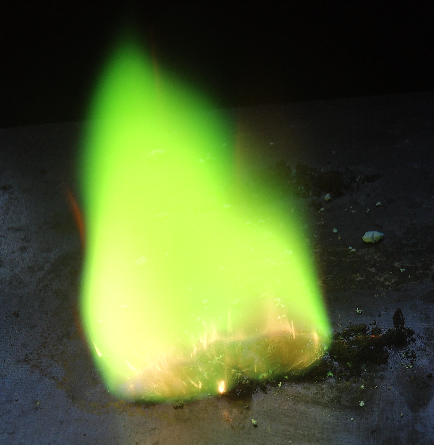

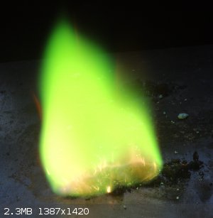

Unfortunately, I cannot reproduce that.
Cu(NO3)2·3H₂O, 2.42 g, 10.01 mmol
C₂H₄N₄, 2.52 g, 29.96 mmol
3 eq 4-ATZ in 50 mL water mixed with 1 eq copper nitrate in 50 mL water, immediately turns dark blue. Within 5 min a precipitate had formed, left it an hour it's formed a viscous soup. Filtered and dried. Took the form of very small sky blue needles, too small to see with naked eye. Fluffy, lint-like to the feel.
Deflagrated mildly on ignition, luminous green flame. Fairly easy to elicit a snap under the blow of a ball peen hammer. It doesn't show any of the DDT characteristics as described.
So there's another puzzle to solve. My copper nitrate is the remnants of dissolving copper plumbing pipe in HNO3 and the 4-ATZ is purchased from china (I haven't made it since the perchlorate experiments).

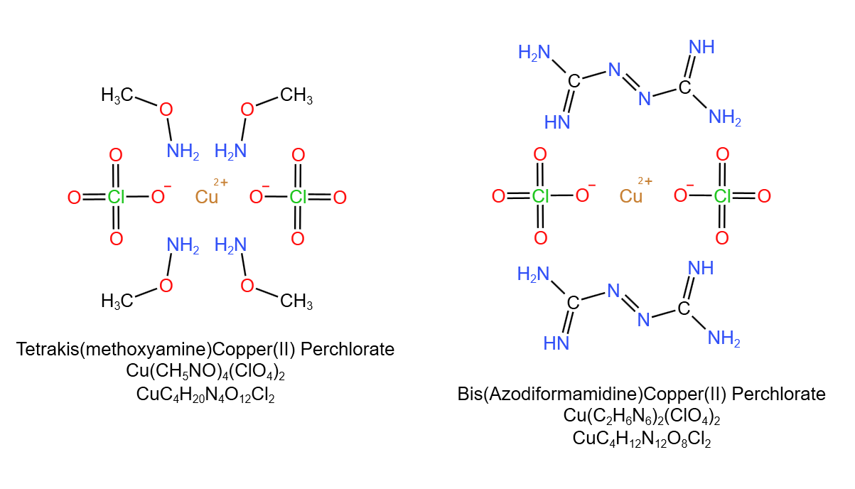

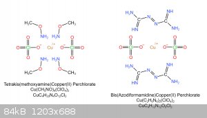

Out of curiosity I precipitated the persulphate from the acetate Cu(C2H4N4)3S2O8? it's an instant pale blue precipitate too, flares off faster than the nitrate, a bit slower than the perchlorate. Only the small amount struck with a hammer will initiate, feebly spreading the rest. A bulky molecule with a single peroxidic bond, it's obviously low energy but has a rapid deflagration.
I've identified a couple more ligands that haven't been explored, I can't find any reference to methoxyamine (CH3ONH2) nor azodiformamidine (NH2-C(=NH)-N=N-C(=NH)-NH2) complexes. Methoxyamine prep aint for the faint of heart but it is commercially available and I have confirmed it will complex with copper nitrate. Azodiformamidine is a simple permanganate oxidation of aminoguanidine nitrate where it is basic enough and insoluble enough to precipitate as a dinitrate but in low yield, I got 5.4 g from 32 g aminoguanidine bicarbonate. I'm not sure why this high nitrogen CO balanced molecule has no reported energetic properties. I haven't attempted a complex, and I'm not sure if the free base is stable.

I was able to distil some methoxyamine, from its hydrochloride using concentrated hydroxide in water, it boils off at about 50C.
The copper perchlorate complex presumed to be as shown above - Cu(CH3ONH2)4(ClO4)2 - precipitates from cooling an ethanol solution (basic copper carbonate + 70% HClO4 + slight excess CH3ONH2 in EtOH) as purple shards.
It's not a particularly vehemic substance in the open, it'll flash off in an instant but with a bit of a courser crackling sound than that of a thump. When 40 mg was confined in a single layer of Al foil and heated it will detonate shredding the foil. It also detonates strongly under hammer impact, its fairly sensitive but that's yet to be quantified.

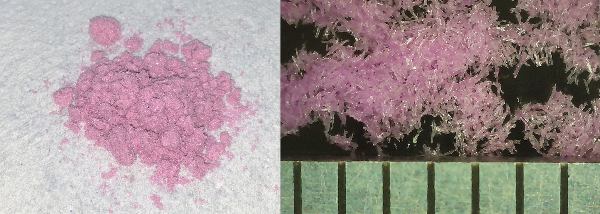

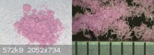

I did try nickel methoxyamine perchlorate, it turns from green->blue->purple->mauve of addition of methoxyamine and precipitated from cold ethanol but I couldn't seem to get it dry and was forming purple patches. It seemed to be losing methoxyamine and taking in water. I didn't try to desiccate it, although it's pretty, it's not that interesting to me. It wouldn't be expected to be as potent as the copper based on oxygen balance.
The copper salt has been stable and hasn't changed sitting unconfined for over a week.
NMOAP crys.jpg - 572kB
