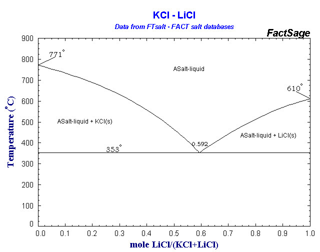

Below is a LiCl/KCl phase diagram plotted against degrees
Centigrade:
KCl-LiCl.jpg - 61kB
Between the range of 47%-77% mole % of LiCl, the salt
mixture remains molten below 490°C.
