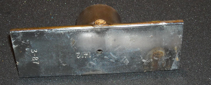

Having prepared large, silvery ampoules of Na & K, I needed to face my nemesis, lithium, and try to prepare a comparably sized (1" x 6") ampoule for my best customer.
I've previously uploaded a pdf file describing the significant factors that effect the deterioration of fresh Li in air. The important lesson I took from this Naval study was that Li is inert to oxygen and nitrogen as long as H2O is less than 5 - 10 ppm.
My experience has been that when lithium is melted and poured in the air, it maintains a bright surface until it cools. I can only assume that the high temperature (such as it is) maintains a localized dry zone around it for a short time.
The metal needs to be cast in some sort of mold (or does it?).
Yet no container seems suitable. Molten lithium reacts with glass, Teflon, alumina, beryllia, carbon. Casting into metal has its own problems. If the metal is hot, Li welds to it. If it's too cold, the Li freezes too quickly and won't flow.
I melt the Li in a steel piston with a SS screen in the bottom and extrude it, once molten, into...what?
I finally decided that no mold was the best mold. I extrude the molten Li out the bottom of the piston and let it form a large teardrop shaped object (sometimes as large as 3/4"). It cools in a flood of argon and that's it. I just grab the hot chunk and pop it into vacuum.
Rinse. Repeat ad nauseum. The final product is shown below.
The sample is very nice, mostly silver with some light grey and no black nitride. Always room for improvement, though.
Has anyone else dealt with these problems? How did you address them? I've been toying with the idea of using a (water jacketed?) polyethylene tube as a mold....

Sorry, I overlooked this question when answering a similar one.
The problem is moisture. It catalyzes the reactions with O2 & N2. The dark color on Li is Li3N, lithium nitride. One lone N2 molecule takes out 6 Li atoms in the process. I'm afraid that what works nicely for Na, K, etc. often fails miserably for Li.
Toluene won't react with Li but it won't melt it either.
The only method I have cleaned Li with (successfully) is mechanical.....melting it in a confined area and pushing the melt through a filter of SS mesh. The one improvement I envision is using SS wool to filter out the smaller detritus better than a fine mesh can.
In fact, I'm going to go take a picture of the crude piston to make its construction clearer in case others try this....brb....
There! Not pretty, but it's a disposable thing.
1.jpg - 97kB 2.jpg - 73kB
[Edited on 18-5-2012 by Zan Divine]
Cool apparatus! Is the piston a tight fit? I ask because I was wondering if upon heating, the metal expands and would seize the piston?
And when the apparatus is heated, in what vessel do you "squeeze out" the molten lithium?

Is it soldered all way around or is it held together with tack weld(s)?

Q) Cool apparatus! Is the piston a tight fit?
A) The piston is not particularly tight.
Q) And when the apparatus is heated, in what vessel do you "squeeze out" the molten lithium?
A) "I finally decided that no mold was the best mold. I extrude the molten Li out the bottom of the piston and let it form a large teardrop shaped object (sometimes as large as 3/4"). It cools in a flood of argon and that's it. I just grab the hot chunk and pop it into vacuum." The Li just hangs there cooling. It looks like a punching bag.
Q) Is it soldered all way around or is it held together with tack weld(s)?
A) 2 tack welds. No solder. The cylinder had a nice, flat, smooth face. No leaks of molten Li since the Li is never under much pressure
