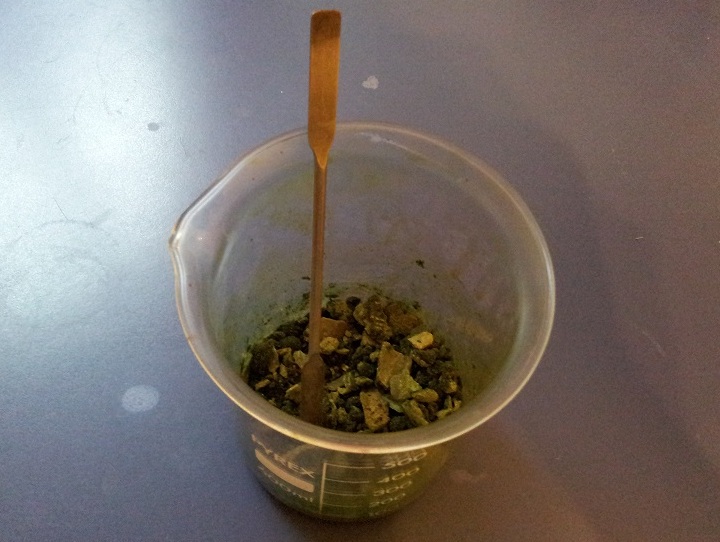

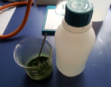

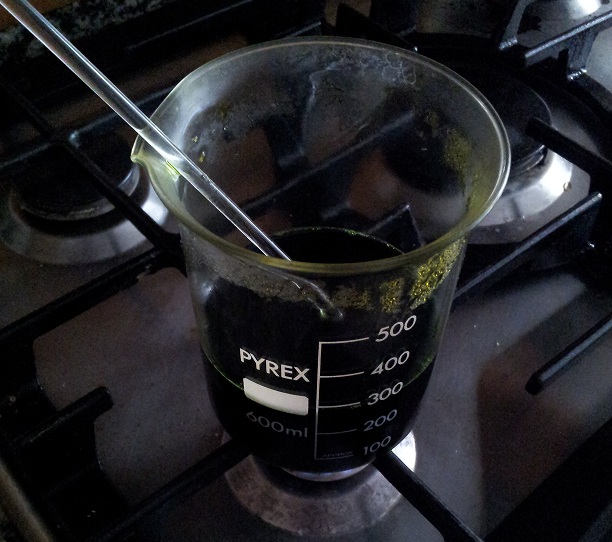

Hello to all, i know that there are other threads about this topic i studied them very well, but they are not exhaustive.
I'm trying to produce sodium chromate from stainless steel 18/10 with only OTC products.
I started dissolving 2 small ss spoons (28.8g) in 33% HCl (500ml?), it took a lot of time and it produced an horrible smell (i hate HCl), anyway they completely dissolved and after that i evaporated the dark green solution to a green, almost dry, mass.
What i want to do now is to precipitate,with naoh, iron/chromium/nickel as hydroxides, wash them with water to get rid of all the NaCl, and then react the solution, until fizzing stops, with some hydrogen peroxide (35%) and NaOH (again),to form Fe(OH)3 and sodium chromate , after that i want to filter the solution to obtain a yellow liquid that should be sodium chromate plus some sodium hydroxide. So i would purificate my sodium chromate by crystallization.
Am I correct ?Is this possible??would I really obtain Cr(OH)3 first or maybe something like sodium chromite that would be lost with filtration?
Please help me with this procedure, I promise that I will go on taking photos and posting them for every step that I will do.

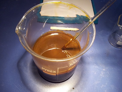

oh my god :D so today i made a big mistake.. i almost completely oxidized the solution with H2O2 only,I added something like 200 ml and it goes on fizzing, have i to throw anything away ? Is possible that with hydrogen peroxide i oxidized only the iron to iron oxide (maybe nickel too) and that the chromium is still chromium (III) chloride? What can I do now? Could I filter off the iron oxide? and than add NaOH and repeat the oxidation with the new almost iron free solution??

[*] posted on 28-9-2012 at 08:49
Salmo:
No, don’t throw anything away. You’ve oxidised the Fe(II) to Fe(OH)3 which has precipitated (your solution was quite concentrated, not acidic enough and that caused the Fe to drop out as hydroxide). Your Cr has in all likelihood co-precipitated as Cr(III) (it tends to do that).
Now neutralise the slurry to about pH 10 – 11 and the chill it to remove neutralisation heat. If there is excess H2O2 present that might be enough to oxidise the Cr to chromate but to be on the safe side add some more H2O2, SLOWLY. The fizzing you observed before is oxygen and it means you’re wasting H2O2. In alkaline conditions the half reaction (reduction) of H2O2 is:
H2O2(aq) + 2 e- == > 2 OH- (aq), so no O2 in sight.
Then try and filter the slurry (depending on thickness, you might want to add some water first). The filtrate should contain the Cr as yellow chromate. You can test for it with a lead (II) salt: yellow PbCrO4 should precipitate.

[*] posted on 28-9-2012 at 10:21
Thank you blogfast, maybe you're right but it's strange i mean: If my Fe(II) has been oxidized to Fe(OH)3 where are my chloride ions Cl-? anyway maybe It's just Fe(III) chloride but if so why is my solution so thick? Is some kind of peptization possible?
Ok I will follow you and I wont throw away anything ;)
I will alkalize first than add h2o2, then filtrate to get the yellow solution, than (as you told me before) i will add acid (h2so4 is ok?) more h2o2 to get Cr(III) back, sodium carbonate to precipitate it and than i will wash it really well!
Then, i will have almost pure Cr(III) hydroxide as [Cr(H20)3(OH)3] i will add the right amount of a NaOH solution (KOH should be better) until it's fully dissolved than H2O2 again to get Cr(VI) as sodium chromate than finally crystallization. :o
