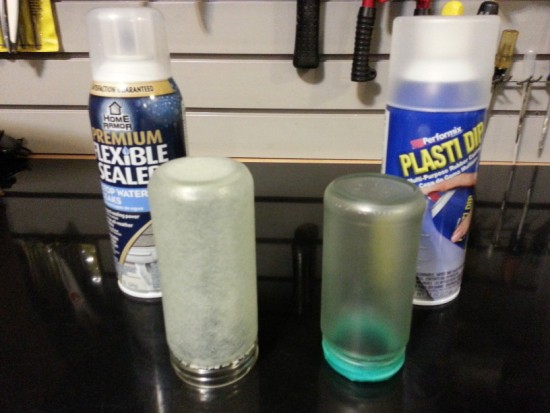

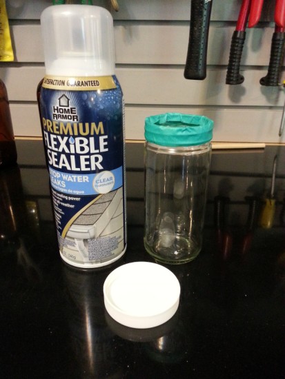

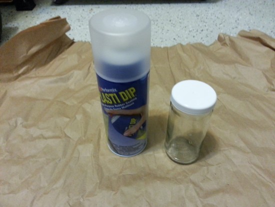

Well over the past couple days I safety coated about 4 bottles with two different types of aerosolized rubber coatings. The first was Home Armor "clear" rubberized coating from Home Depot. The second was Plasti Dip Clear. The Home Armor Ended up creating a horribly sticky air-bubble including mess. The Plasti Dip was highly favorable, and looks/performs much like the Schott Duran bottles I have. I will later be doing some destructive impact tests to verify performance.

The Home Armor and Bottle to be coated
The Plasti Dip and the awaiting bottle

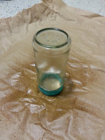

The process was overall stupidly simple. I just taped over the threads with some painters tape, making sure it was tight over the threads. Applied several coats of the rubberized spray (the bottles were sprayed both upright (with a towel stuffed inside to prevent overspray from entering the bottle) and upside down.
Then once cured for 24 hours, I took an exacto knife to the edge of the tape so that it wouldn't pull the safety coating off, then simply peeled it away and was left with a clean safety bottle.

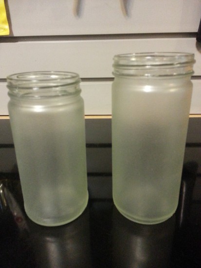

Here is a a comparison shot between the two coatings used:
I actually ended up removing the Home Armor coating (damn was it stuck to that glass!) from the larger bottle and Plasti Dipped it.

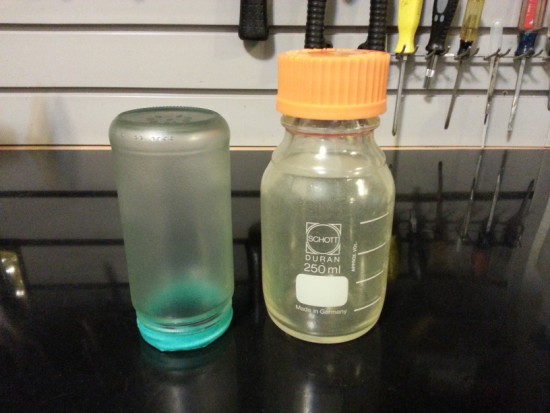

Here's a shot next to a Schott Duran bottle. The resemblence is uncanny:
And the final results looking pretty, and grip extremely well:
