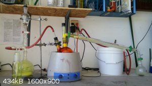

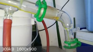

I know this is a VERY old post, but I figured I would give my two cents just because. In case someone else strolls among this.
The following picture depicts my setup as a whole.
I chose a calcium hypochlorite w/ HCl as my Chlorine generator with sulfuric acid as my liquid drying agent.
Sulfur was brought to a molten state above 200C
Distillate collected and condensed.
And collected.
The crude S2Cl2 was then fractionally distilled.
Then vacuum distilled and collected; with this being the purified final product. BP 137C
The S2Cl2 made here will be used in the preparation of Thionyl Chloride which I would be happy to post on a SOCl2 related page.

[*] posted on 14-5-2015 at 18:26
Lovely! Cool setup. Definitely a compound that's nicer to look at pictures of rather than play with in person... Nah who am I kidding I need to make some.
How did those rubber stoppers hold up? And it looks like this was done inside, was fumes/smell a significant issue?
[*] posted on 14-5-2015 at 18:35
Nice!
Looking at your separatory funnel sitting in that iron ring makes me squirm. I would suggest that you place some rubber tubing on the ring to protect the glass.
Are you going to gas your product with Cl2 to form SCl2 as the next step?

[*] posted on 14-5-2015 at 18:40
Not too dissimilar to what aga has been doing lately. Lovely pix.
Looking forward to getting my glassware so that I can have a try.

[*] posted on 15-5-2015 at 03:13
I don't think you have pure disulfur dichloride as your product is significantly red:
http://www.sciencemadness.org/talk/viewthread.php?tid=10363
Notice how Klute's product (when sufficiently purified) is golden yellow in colour, matching the physical description given in texts like Armarego and Perrin. I'd set up for a brief reflux over some sulfur, and then distil.

[*] posted on 15-5-2015 at 16:39
DJF90- that was my original concern when seeing the color. What I forgot to mention was that during the fractional distilation, I added a considerable amount of sulfur but the color remained red. Perhaps I will heed your advice and reflux w/ sulfur, distill, and report back.
The hoses held up just fine. The rubber stopper became brittle but remained in tact. My set up is right next to the garage door which I leave wide open with a fan if the fumes become a problem; but I usually wear a respirator just to be safe.
Magpie...that is a good idea, I will do that. Thank you. And yes I plan to gas this with Cl2 in an oil bath above the boiling point of SCl2 but below S2Cl2...say 120C. The SCl2 vapors that continuously form will combine with SO2 & excess chlorine over a hot activated charcoal bed in making SOCl2. Which will then be purified and used in the making of alkyl chlorides.
