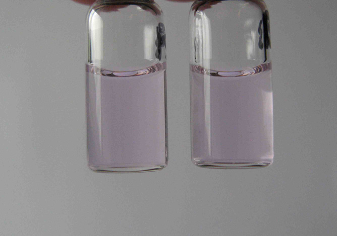

@Blogfast25: The tests with iron were as follows:
- Solution of thiocyanate was nearly saturated, i.e. of very high concentration
- I used a test tube for the tests and mixed appr. 1 : 1 by volume the test solution and the concentrated thiocyanate.
- The test tube is a standard 16 mm test tube, so I decided positive testing on the basis of viewing through appr. 15 mm of liquid. Maybe if I worked on a larger scale I could achieve even better sensitivity, but I did not want to spend too much of my thiocyanate.
Your red Nd-sulfate looks quite much like mine (in the small vial), but mine is somewhat more brown/orange. The material in the large vial is more pink/purplish.
@adamsium: The red/orange material is made from Nd2O3, which was sold to me as 99.9% pure material by eBay seller Jarmond Brinkley. Of course, the 99.9% number must be taken with a grain of salt, but it would be really bad if this is so-called "didymium". The color of the oxide is as it should be. Pure Nd2O3 has a very pale blue/gray color and my sample has exactly that color. When dissolved in dilute acids, it gives a nice lavender solution under TL-light and a pinkish solution under daylight.
Another indication that it is not "didymium" is that on strong heating of the oxide, it does not turn dark. Didymium is a mix of praseodymium and neodymium and Pr2O3 turns dark on strong heating in contact with air, due to formation of Pr6O11 (which contains Pr in oxidation state +4 besides Pr in oxidation state +3). Samples of "didymium oxide" turn dark on heating, but my sample does not, I tried that some time ago and I heated until the oxide was red hot and glowing.

Posts: 7754
[*] posted on 4-7-2013 at 06:32
The color of the material in that picture of Nd-sulfate matches mine quite well.
I actually have two batches of Nd2O3, purchased at very different times and from different sellers. Both batches, however, are very pale blue/gray. One of the batches was sold to me as 99.9% and the other was sold to me as being free of iron. I tested that and indeed it is free of iron (up to PPM or so level). The other "99.9%" sample has clearly visible presence of iron, but it is at the 10...100 ppm level, not more. That sample is slightly less bluish than the iron-free sample, but the difference is VERY small and I could not make convincing pictures, showing the difference.
Are you sure the pink coloured oxide is Nd2O3? I also have some Er2O3 and that material has a pale pink color, but the color is much stronger than the color of Nd2O3.

Posts: 7754
[*] posted on 4-7-2013 at 23:04
The sample in the larger vial, the other sample is much more orange/brown.

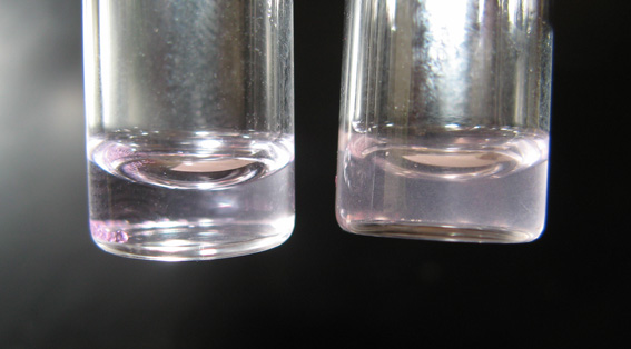

Posts: 7754
[*] posted on 14-7-2013 at 23:27
Phlogiston, thanks very much for doing this test! Interesting to see that the red/brown sample has very fine solid particles. This may of course explain the difference in color. Even a very faint opaqueness in the crystals may cause a significant difference in perceived color. I indeed made the brown sample from Nd2O3 (which I purchased from eBay seller Jarmond Brinkley). The pink sample was made from metallic Nd (heavily oxidized, due to me storing it improperly), purchased from an eBay seller, called Metallium.
I will make a webpage about all of this and then I'll include the spectrum-images as well and of course a word of thank to you :)
In the meantime I also did some new experiments. I dissolved a few grams of Jarmond Brinkleys Nd2O3 in dilute H2SO4 (appr. 1 M). Initially, I had some fizzling (apparently the oxide contains some carbonate as well) and there was slight warming up of the liquid. Not all of the oxide dissolved. I needed to heat the liquid to get all of it dissolved.
At this point there were quite a few interesting observations:
1) Initially, the liquid I obtained is lavender in TL-light and pink in daylight.
2) On stronger heating, the liquid turns yellowish in TL-light, still pink in daylight, albeit somewhat duller/brownish pink.
3) On boiling, a lot of pink fine crystalline solid drops out of the liquid. The remaining liquid becomes yellowish brown in TL-light.
Next, I decanted the yellowish brown liquid and allowed this to evaporate slowly in a petri dish.
I rinsed the pink crystalline solid two times with boiling hot distilled water and after this treatment I dissolved the pink solid in water. I needed quite a lot of water to get all of it dissolved. For appr. 5 grams I needed well over 100 ml of water. The solution is pink/lavender under TL-light, pink under daylight. I have the impression that it is slighlty opalescent, but only very slightly so. Just to be sure, I added a single drop of 1 M H2SO4 to the solution and tranferred this to an evaporation disk. I allowed it to evaporate slowly as well.
The solution in the petri dish evaporated in nearly three days, giving red/brown crystals again, very much like the ones in the small vial. I allowed appr. 90% of liquid to evaporate, the rest I transferred to a test tube and I rinsed the crystals with boiling hot distilled water.
The solution in the eavporation dish was allowed to evaporate for nearly 95%, I tranferred appr. 5 ml to a test tube and rinsed the crystalline solid with boiling hot distilled water. The crystalline solid from the evaporation disk was pink, but I did not obtain nice large crystals, they were much finer. The pink color is the same as the pink color of the fine crystalline solid which crashed out of the boiling hot solution.
From the above, I get the impression that from a strongly acidic solution, you get nice large crystals, while from a (nearly) neutral solution you get very small crystals.
Finally, I tested for the presence of iron with thiocyanate:
- The small amount of liquid, remaining from the petri dish was positive on iron. Actually, the color was quite strong.
- The 5 ml of liquid, remaining after crystallization from the evaporation disk also was positive on iron quite strongyl, albeit not as strong as the other one. Apparently the crystals, crashed out of solution by boiling it contained quite some iron, which after recrystallization remains in the solution instead of in the pink crystals.
- The red crystals and pink crystals, obtained after recrystallization both have negative test on iron.
So, the presence of a (small) quantity of iron apparently does not significantly change the perceived color. The color of the crystalline solid, obtained initially after boiling the solution is the same as the color after recrystallization.

I wonder how the Jarmond Brinkley oxide would behave if you dissolve it in hydrochloric acid, and reflux that for 10 minutes or so. The rare earth chlorides have a much higher solubility than the sulphate, also at high temperatures.
My guess is that in hydrochloric, all of the oxide will dissolve, and I wonder what happens if you exchange the chloride for sulphate and crystallise then. I expect (but am not confident) that then the sulphate will have a pink colour too.
(Exchange of chloride for sulphate: precipitate with NaOH, suction filter and rinse a few times; then dissolve in H2SO4.)
Edit: Oh yes, in order to get rid of the iron, the sulphate should be cleaned as you did in the experiments in your last post, in order to make a sensible comparison.
The problem is that with HCl you're severely limited in concentration (max. 37 w%). Concentrated HCl often doesn't even make a dent in oxides that have been calcined. That's the primary reason for using H2SO4 95 % (or better).
@woelen:
I made an interesting observation. Preparing my Nd sulphate to make a solution of exactly known concentration (about 0.05 M), I decided to dry it overnight in a CaCl2 desiccator, to get rid of possible surface moisture. In that period, it seemed to me to have undergone a bit of efflorescence. I weighed it and put in in the desiccator for another 24 H and it lost another 2.5 w%. That's equivalent to about 1 mole of water based on the octahydrate. It appeared (subjectively) more pinkish).
I really need to repeat this experiment to be sure of what I'm writing.

The Nd2O3 I have has no problems of inertness at all. It very easily dissolves in acid, also in dilute 10% HCl. In dilute sulphuric acid some heating is required to get all of it dissolved, in dilute hydrochloric acid or dilute nitric acid it simply dissolves in a few minutes. This is in stark contrast with my Er2O3 I also have from Jarmond Brinkley. That material must be boiled for hours to get only a small part dissolved, or you have to let it stand at room temperature for many days. But finally, with sufficient patience and with sufficient excess amount of acid that also dissolves.
But back on the topic of Nd-ions. I also noticed a peculiar effect when a solution of NdCl3 in excess dilute HCl is heated. On heating, the solution turns from lavender through grey to yellowish grey and on cooling down it slowly (takes a few hours) turns back to lavender. Apparently, with chloride it gives some coordination complex in the hot solution, which slowly decomposes again when it cools down.

Well, mine was homemade, not calcined at all (just dried very thoroughly) and didn't dissolve in 37 % appreciably!
