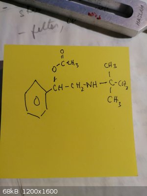

[*] posted on 4-11-2023 at 07:52
...help finding the correct name for compound ...i tried 2-ethyltert butylamine-1-phenylbenzoate ...but no results....its a steroid precursor .....solo

[*] posted on 11-11-2023 at 08:00
2-(tert-butylamino)-1-phenylethyl acetate
