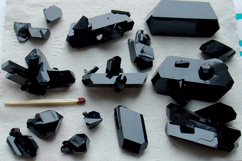

[*] posted on 15-9-2016 at 10:29
I tried to crystalyce copper acetate into a big crystal dark crystal, like the ones seen here
files.php.jpg - 146kB
(Image taken from SM btw)
But I can only get shitty small blue crystals.
I did get some dark ones starting to form in a copper wire, but a lot of blue ugly ones formed way faster.
What do I need to do to to get those beautiful crystals?
I thought about moving the evaporation thingie to a colder place, but that means it needs to be inside my house, something I dont think I can do. I also thought about hanging a copper wire, since I saw dark ones starting on the copper wire, but since its something that takes so long, asking saves me a lot of time :)

Posts: 4326
[*] posted on 22-9-2016 at 10:07
Make sure you've got excess acetic acid in solution. Don't leave the copper wire in there, as you'll get a slow reaction with atmospheric oxygen to give basic copper(II) acetate. I haven't had much luck with large beautiful crystals, but I tried leaving the copper wire in (actually, I was suspending the seed crystal from a copper wire, since I could tie it more easily than fishing line) and it failed, failed failed for that reason.

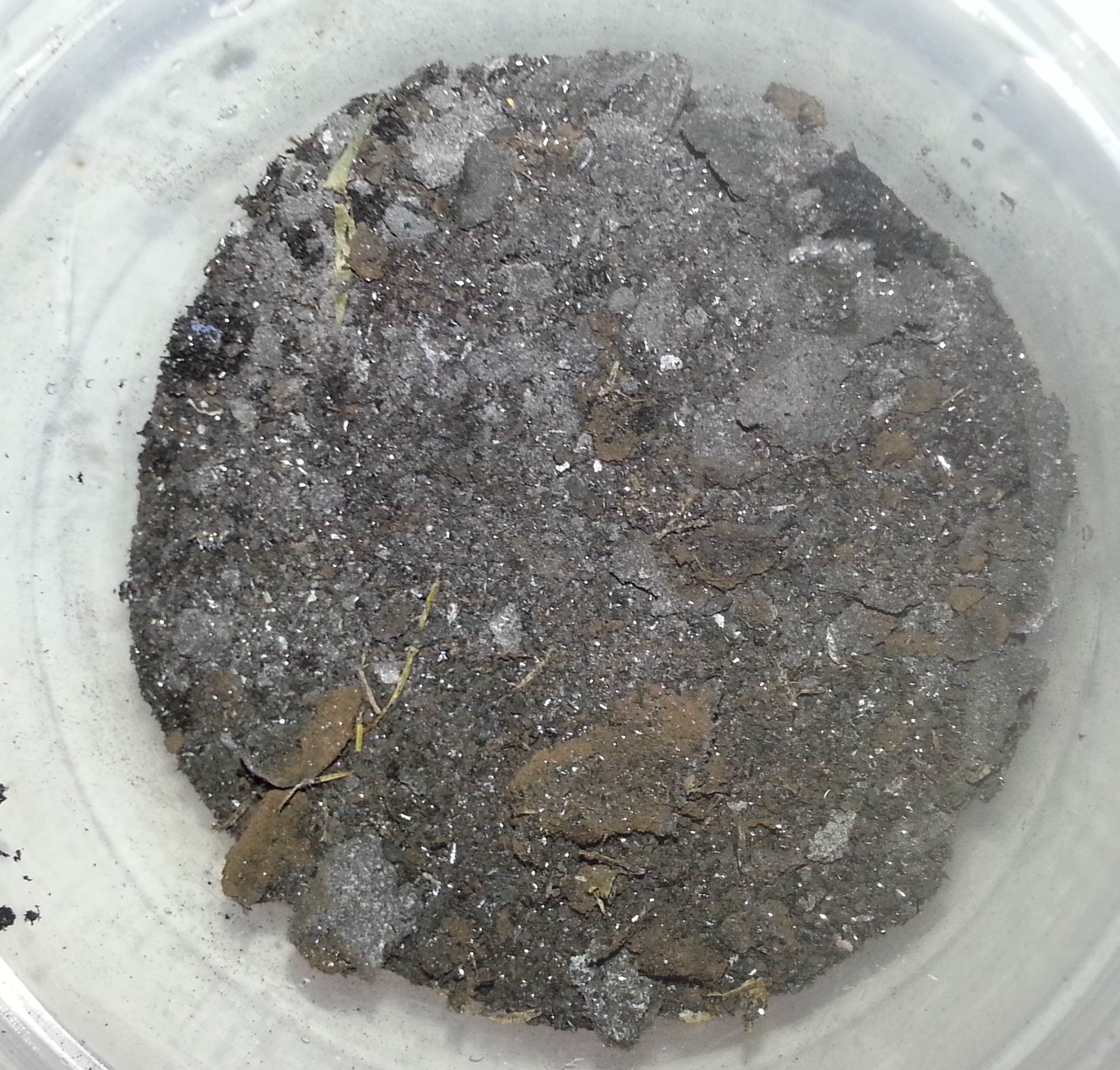

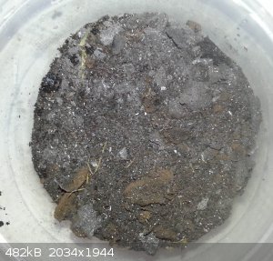

[*] posted on 28-9-2016 at 18:52
Is this CuO or Cu2O??
Cu2O maybe.jpg - 482kB
The image doesn't show how black it is with lots of reflective "glitter like" speck in it. It is light and feels more like dry dirt.
I'm trying to figure out what I have here. It is the result of putting enameled copper wire (magnet wire) into hot (boiling at some points) molten NaOH. It leaned up the wire to a beautiful shine but there seemed to be some black specks in the lye and on the copper as I shook it off as I removed it from the pot.
I then soaked the copper w/ lye/black coating in hot water and boiled till clean. I added the water to the solidified lye until it was dissolved and filterable. The remainder is what is left from all the windings I "cleaned". There is about 1.25 cup and it weighs about 83-85g and it is fluff y like dirt. The thing is that I never had dirt near the lye or copper or solution pre-filter.
It has a dirt "feel" and a couple grains tasted like dirt. IT doesn't dissolve in water.
Any idea what this could be? Being so light how could it be copper (or is it some sodium compound)?
Posts: 4326
[*] posted on 28-9-2016 at 18:57
That might contain copper(II) oxide, but it doesn't look like it's even mostly copper(II) oxide.
Metacelsus
Posts: 2539
Registered: 26-12-2012
Location: Boston, MA
[*] posted on 29-9-2016 at 05:24
It's probably from the enamel.

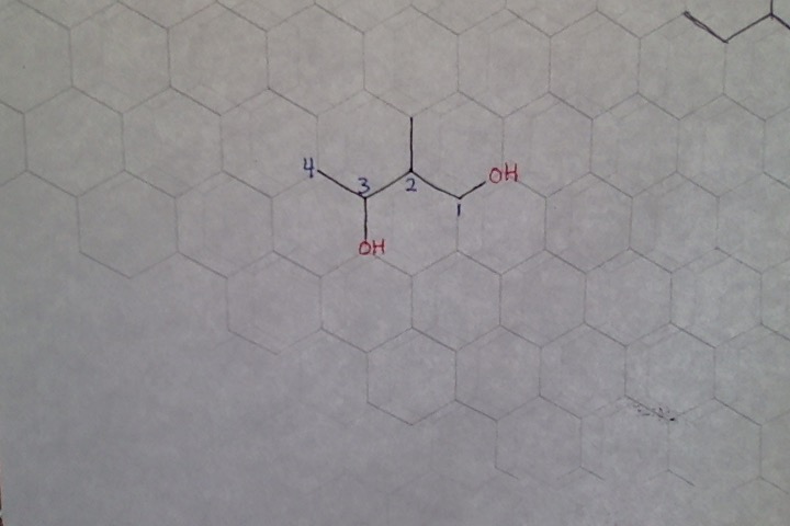

Need help identifying this secondary alcohol!
Can you guys help me identifying this orgo alcohol? Is it 2,3 dimethylpentanol? Or 2,dimethylhydroxypentanol.
https://scontent-arn2-1.xx.fbcdn.net/v/t34.0-12/14509282_102...
Thanks in advance
Posts: 4568
Mood: PhD candidate!
[*] posted on 29-9-2016 at 05:51
2-methyl-1,3-butanediol
Edit: to explain how to name it:
Photo on 9-29-16 at 9.01 AM.jpg - 55kB
-Find the longest carbon chain that both hydroxyl groups are attached to, in this case, 4
-Number the carbons so that the substituents have the lowest numbers possible, in this case 1,2,3 (if you started at the other side it would be 2,3,4)
-Because there are two hydroxyl groups, it is classified as a diol
[Edited on 9-29-2016 by zts16]
