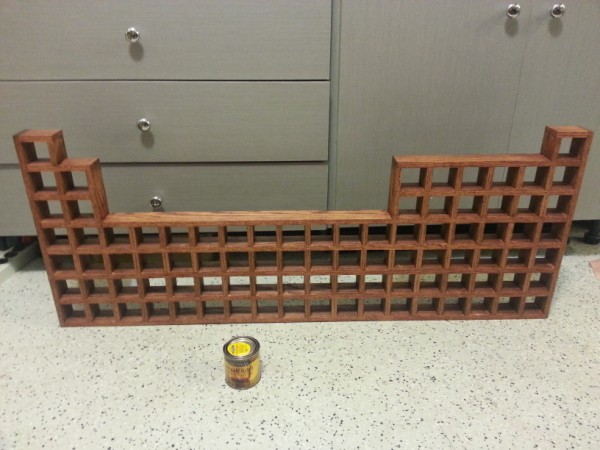

Well I just finished the final steps to make the periodic table look pretty. A nice coat of Miniwax red oak stain and some polyurethane clear gloss varnish. Really looks quite presentable now!
After staining:
And finally with the clear gloss varnish, looking glossy and beautiful!

Beautiful work! Please keep us updated with your addition of element samples. (Do you want/need a large chunk of PTFE?) I have just one suggestion for future reference; I've found that it's often easier to stain intricate woodworking projects before the final assembly. Keep up the good work! :)

That's very pretty! I like everything about it. Choice of material, neat construction, dimensions. When I finally find the time to build something to display my element collection in, I am definately going to use your design as 'inspiration'. Thanks for sharing!

One reason I try to stain before assembly, is that any wood with wood glue in/on it won't take stain (learned this the hard way).
If this does happen, sanding is your best friend! Sand, reapply stain, sand again, etc.

Doesn't help if the glue has soaked deeply into the end grain on a joint.

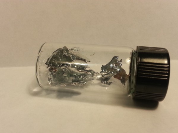

Here we have bromine, prepared using NaBr, MnO2, and HCl in a very crude distillation setup. The result looks to be fairly pure bromine, although it certainly has some water content in it.

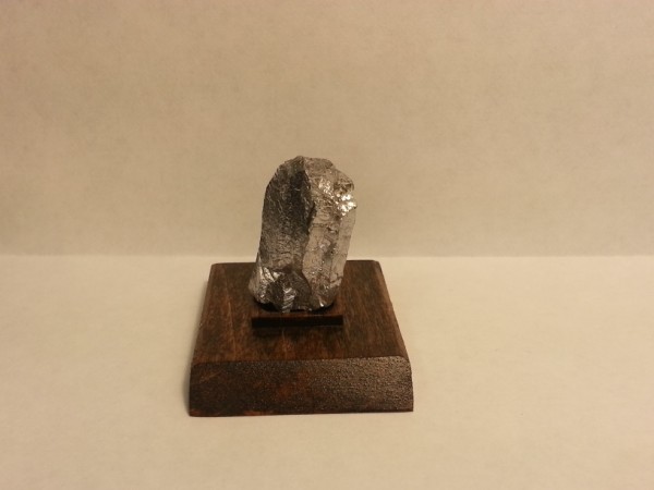

Next up is a large chunk of very pure Chromium purchased from a seller on eBay. I made the wooden base it sits in out of some scrap wood I had laying around. Just tossed it in my milling machine and a few minutes later I had a nice display base.

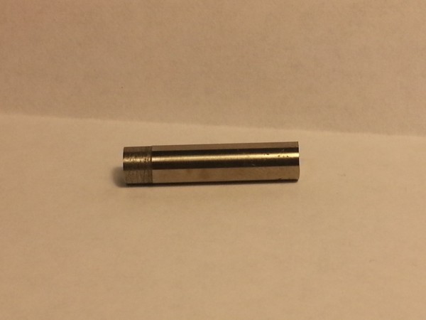

And finally a large cylinder of Iron. Made by cutting a large iron bolt with a hacksaw and the turning it on my lathe. I coated it in a clear lacquer to prevent oxidation. I realize its not pure iron, but it looks nice, is close enough to pure for me, and was what I had lying around.

Very nice sample of chromium! What elements do you plan to go for next?
