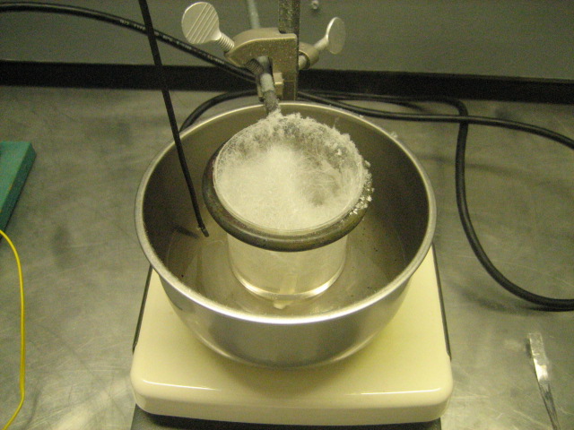

12. As the phthalic acid begins to heat up and liquefy (mp = 131°C) water vapor will evolve. Some of the formed phthalic anhydride will vaporize forming filamentous crystals (wool) around the lip of the beaker. Gather the wool as it forms using the ss spatula and drop it back into the melt. See photo below:
IMG_0658.JPG - 110kB
13. The melt should be gently boiling and off-gassing. Continue this until the milky melt turns clear.
