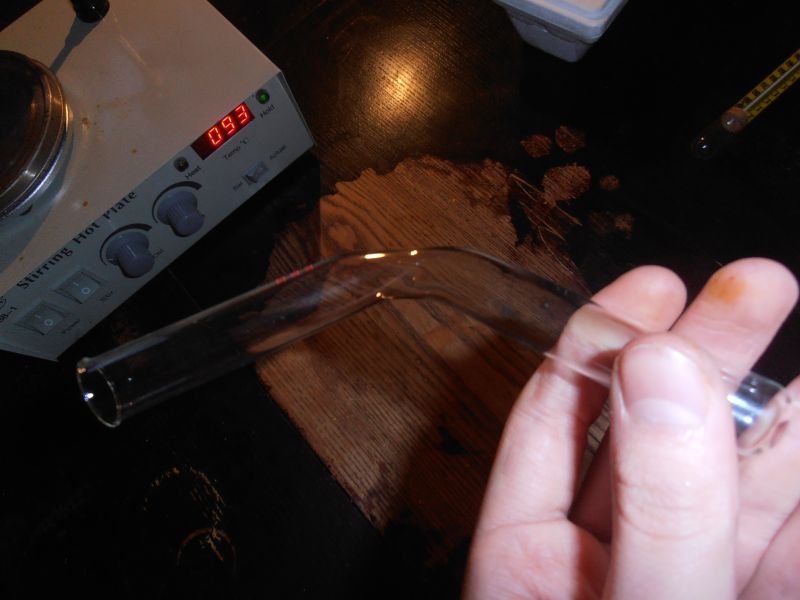

I started with a box of 16mmx160mm soda lime test tubes. I prefer soda lime as it is a lot easier to bend. Many people prefer 3.3 borosilicate because it's less prone to cracking due to thermal stress but it's more expensive and If you heat it properly there should be no danger at all of it cracking
you will need to light the burner and turn it to the maximum setting, then take a test tube by each end and hold the middle in the upper part of the flame, rotate it for about 1-2mins. You should see the flame turning yellow where it's touching the glass, now gently pull the two ends apart while bending, this will ensure a smooth bend with no kinks that can collect P4.
the finished test tube should be bent between 90* and 100*, the closer to 90* the better. It should look something like this:

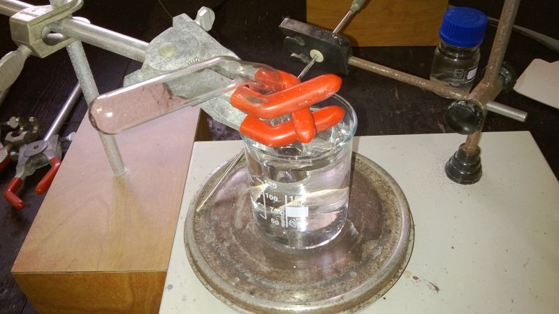

With the spatula, put red phosphorus into the bent test tube. put enough in to get a 2-3cm deep layer on the bottom, then place it in a clamp and suspend it above a beaker of warm water (+-50*C) so that the mouth is as far under water as possible.
WP_20130815_007.jpg - 83kB WP_20130815_008.jpg - 69kB
I find it unnecessary to mix SiO2 with the red phosphorus, I have never had problems with bumping.
Now start the burner, you want a gentle flame. I set it so there is a little yellow tip on it so its not too hot. Now hold the base in your hand and tilt it towards the tube, heat the open end first and work back to the closed end (e.g. from left to right on the above picture).
As soon as the glass gets hot enough the P will ignite. It is nothing spectacular, just a barely visible yellow green flame which goes out quickly.

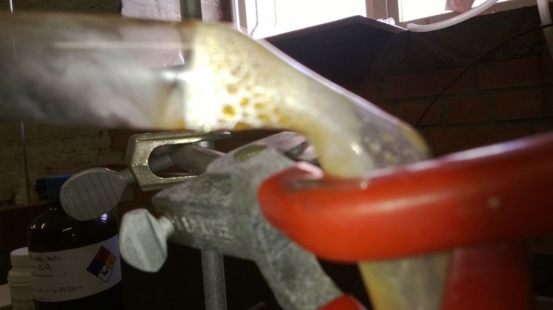

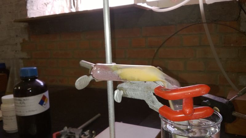

now continue heating, the red phosphorus will turn to P4 and you will see the vapors coming up and condensing in the curved part. The glass there is hot enough to keep it molten so once enough has built up it will run down the glass and drip into the beaker
WP_20130815_011.jpg - 56kB Here the drops of P4 are condensing and dripping down
Warning!:If you overheat it bubbles of P4 vapor will come out of the test tube, catching fire the effects range from a big bang to a gentle fizzing sound but will not occur unless you are careless
The P4 that collects in the beaker will be anything from dark red (almost black) to lemon yellow depending on how carefully you heat.

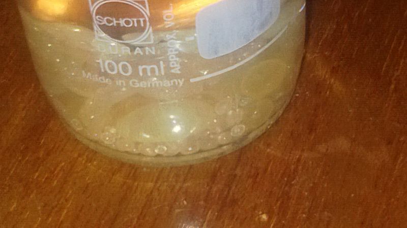

when the P4 is freshly distilled it is usually orange with lots of other junk.
Half fill a pipette with water and then suck in the molten P4 and transfer it to a beaker of dH2O at 50*C. next add 5ml of H2SO4 and then 2 spatulas of K2Cr2O7 and stir for about 5-10 mins. then transfer the purer P4 to another beaker of 50*C dH2O and stir for about 20 mins. by then it should be white. If it is then pipette it off to a clean beaker of water, cool it and transfer it to a good bottle.
-results
a bottle of nice pure P4

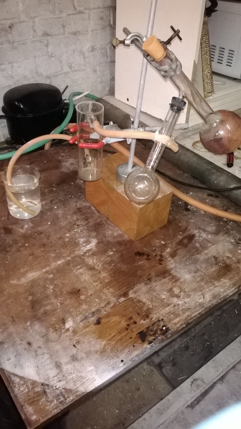

i have stopped making it this way, i make it in a 150ml retort. That's a lot faster.

update:

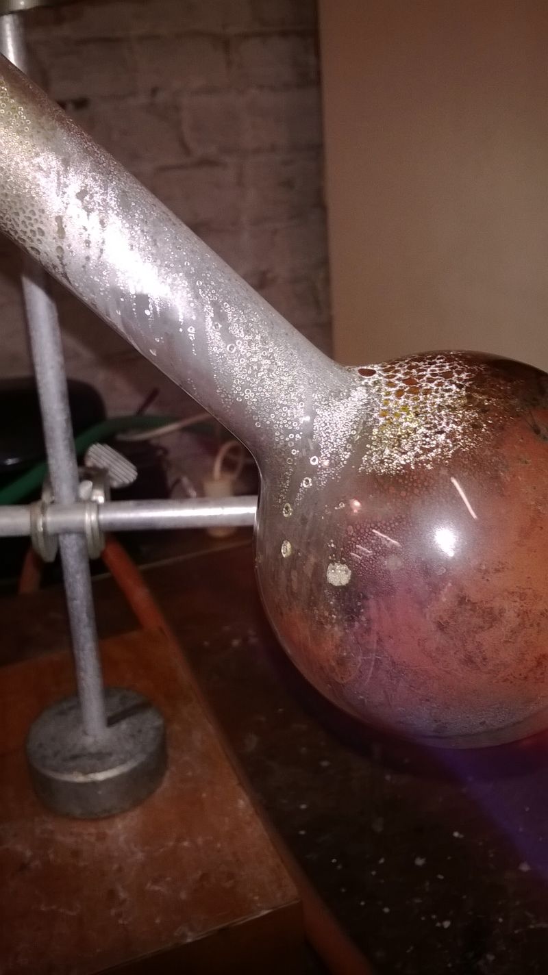

yesterday I successfully attempted the synthesis of P4 again, but on a larger scale.
WP_20140103_014.jpg - 213kB
a 250ml retort is fitted with a cork so that the outlet tube leads into the top of another retort of which the outlet tube is pointing up. that tube is connected by a hose to a suckback trap to a beaker of cold water.
the other retort is placed in cold water.
the retort with RP is then heated so that a constant stream of vapor goes into the other retort and condenses

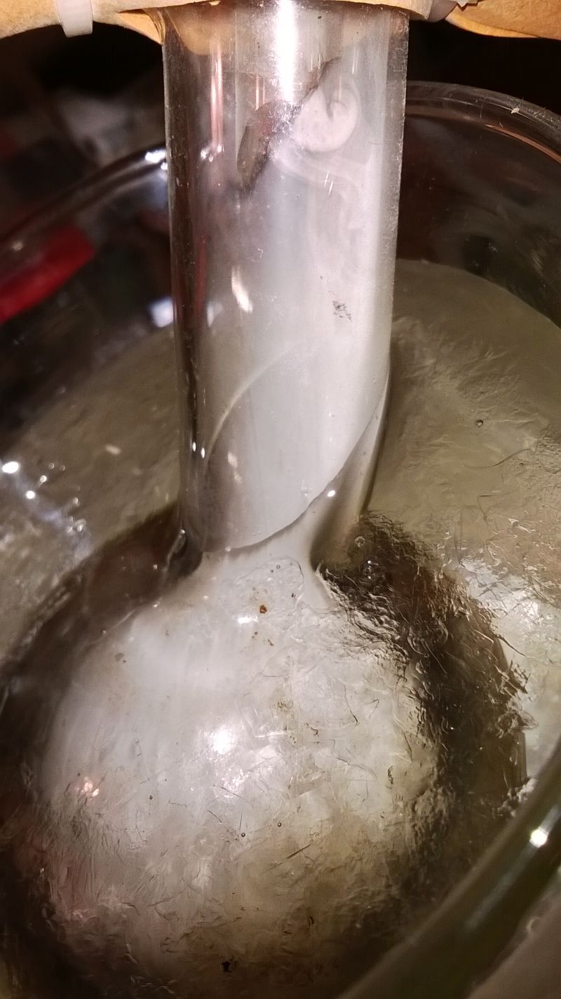

WP_20140103_020.jpg - 173kB
after a while liquid P4 will start coming over.
WP_20140103_022.jpg - 160kB
refluxing P4
observations:
-loading the retort over 50% full is not recommended
-Later the rubber stopper was replaced with a well greased NS19 stopper.
-notice I used my crappiest table, in case of an accident
-a bucket of cat litter should be on hand
