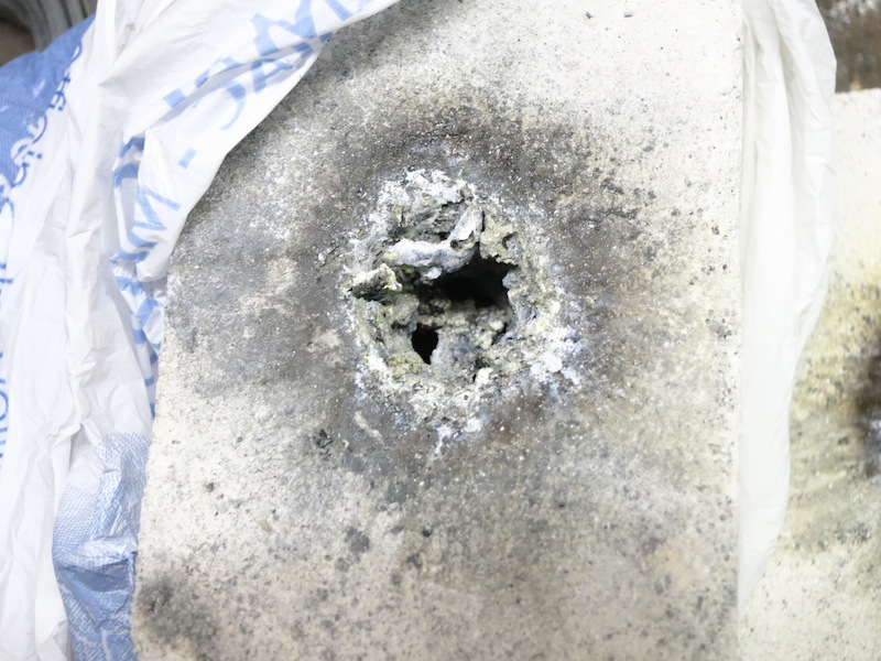

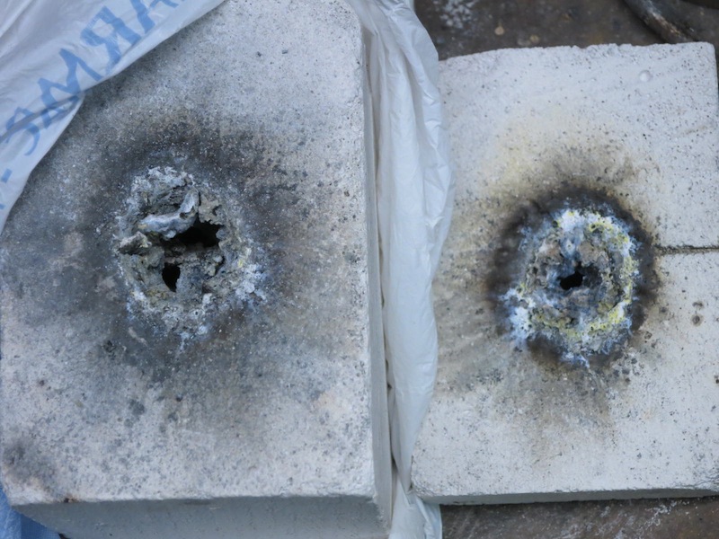

Anyway I tried the Sulfur method:
9 parts SiO2, 10 parts Al and 12 parts S. It reacted slower and still have to open the reaction vessel (25mm hole drilled in YTONG brick) to collect the result.

You always show the reaction and then the slow motion, but you never show the product once it's cooled. I find this to be repetitive/annoying (slow-motion) and rather pointless. We all know what a thermite reaction looks like; show us the products. Also, more data is essential. As an example of what you're doing wrong; you've given poorly defined ratios and "parts." Are you measuring by mass, moles, or volume (the wrong way)? Inexplicably, you specified the hole size in your brick as 25mm&mdash;this is irrelevant.
In short; <em>more science, less k3wlism!</em> Considering the current quality of this thread, it belongs in Beginnings. I try not to interfere in Energetic Materials, but come on...

[*] posted on 6-9-2013 at 11:27
The ratios are always by mass. The amount was about 22g altogether.
Here a photo of the results. Very hard and brittle. Must be mixture of Si and Al2S3.

A bit better. Thanks. What about chemical analyses of the products? Have you performed any?

It doesn't reach our normal standards for chemistry but in pyrotechnics parts are always by mass. Anything that produces gas - sulfur, chlorate, residual water - will tend to turn your reaction into a fountain, destroying any silicon you form. I really don't like the look of these mixtures and it may not be feasible to use a self sustained reaction with small amounts anyway. I have a book which recommends fine silica and magnesium powder heated in a hard glass test tube and describes a red glow traveling through the mixture when the reaction starts. If you have magnesium I can search for the details, one other advantage is that magnesium oxide can be dissolved in dilute hydrochloric acid. If you must use aluminium then starting with tiny amounts to gauge the violence of the reaction may be the way to go.
