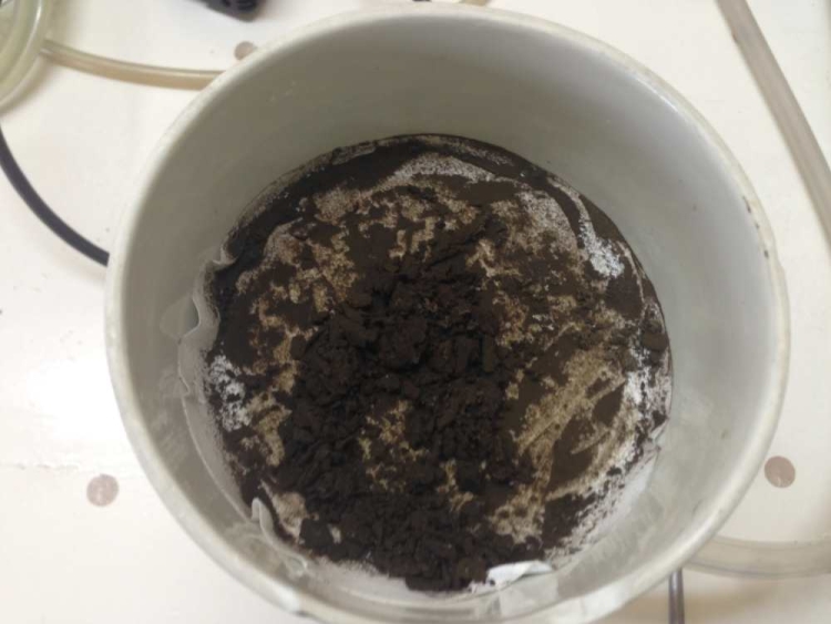

As the reaction took place, there was a clear reduction to a vivid purple (V(II)), then after some time the solution took on a brown coloration. After some dilution, the addition of some 'fresh' magnesium, and further reaction, there was a black/brown precipitate, and the solution turned colourless.
The second batch worked similarly, though wasn't diluted as much. This batch appeared to cease at the brown-coloured step, with minimal precipitation.

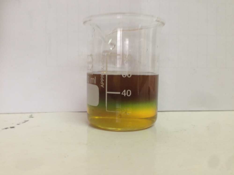

After taking a small sample of the brown liquor, and adding some 12.5% hypochlorite, the attached layering effect was encountered, with the quite obvious transition of V(V) on the bottom (the hypo sank through the solution), a blue/green layer of V(III) and V(IV), with a faintly detectable purple V(II) visible underneath the brown layer on top.
Can anyone advise what this brown-coloured liquor may be, or the precipitate? (V(0)? V(I)? V(?)xOy?)
Alternatively, can anyone advise what analytical methods may be employed to determine the oxidation states of the a)liquor and the b) solid?

As long as the liquid remains acidic, you indeed have violet vanadium(II), green vanadium(III) and blue vanadium(IV). I certainly can imagine that you get these if you add magnesium to a strongly acidic solution, containing vanadium.
If during the reaction with magnesium the acid is used up, then the liquid soon becomes alkaline and then you get the brown hypovanadate-ion in solution, V4O9(2-). It might be that the brown liquid contains this ion. Try to determine the pH of the brown solution. Is it alkaline or acidic? If it is acidic, then my suggestion of hypovanadate is wrong and another explanation must be found.
The hypovanadate is formed at really high pH, at slightly alkaline pH, a precipitate of hydrous VO2 is formed, which is dark brown/black.

In terms of pH, the end pH of the process is just under 3, and when raw caustic is added, the precipitate is brown leaving a completely colourless filtrate. I'm trying to get some XRD analysis done to confirm, but I believe the filter cake is V(OH)3.
I have recently also performed a similar reduction process, though electrolytic, which has yielded similar results, albeit with an added jet-black material having been plated on the cathode (or anode - can't remember which one's which) - presumed to be V2O3.
Given the liquors go to a deep violet colour through the reduction process, there is most definitley V(II) or V(III) present, and I cannot envisage any V(IV) being present at all.
While I have reasonable confidence of the composition of the solids, the brown colouration of the (reduced) liquor is still confusing. Am also unsure of how to analyse this to get to an answer - UV-VIS as a start then...?
Any other thoughts welcome
