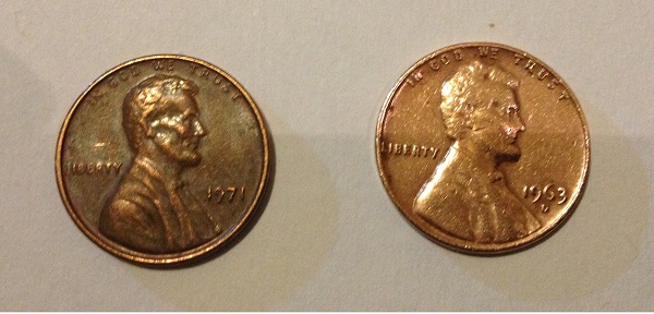

I took pennies between, years 1962 < X< 1982 as these contain 95% copper 5% zinc.
Experiment 1
The penny was placed in a small container and 10ml 5% acetic acid was added. The entire oxide layer was removed at room temperature in about 10 minutes. No apparent further reaction with the unoxidized copper was observed.
Experiment 2
The same procedure except the acetic acid was slightly heated. The oxide layer was removed in less than 2 minutes. The reaction was left to sit for 20 minutes the copper produced a few tiny bubbles that clung to the surface of the coin, but very slowly.
Experiments 3,4
The same procedures as above however this time 10ml of H2O2 was added to the solution. The oxide layers reacted and both pennies formed bubbles though the reactions were less than vigorous.
newer 022.JPG - 92kB
The penny to the left has a brown oxide layer. The penny to the right was the result of experiment 1.

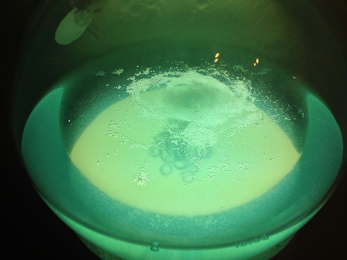

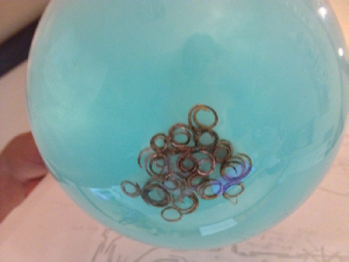

To a 1L RBF I added 250ml of 5% acetic acid, 250ml 3% H2O2 and 1 gram of copper turnings. At RT this mixture slowly formed very fine bubbles that clung to the copper's surface. After heating the mixture to about 80oC vigorous reaction took place.
newer 021.JPG - 95kB
Characteristic blue color.

View of reaction illuminated from below.

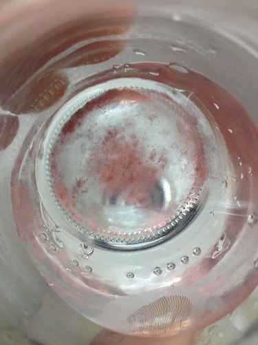

About 30ml of solution from experiment 7 was added to a small glass container. A few tiny pieces of Zn were added to the solution. The zinc started to bubble immediately and after a few minutes the solution lost its blue coloring. After the zinc had stoped reacting the gray liquid (suspected zinc acetate) was discarded. Deposited on the glass appeared to be a small amount of copper metal. The glass was washed with dilute HCl and rinsed with tap water. To the glass containing the copper film was added 10ml acetic acid and 10ml hydrogen peroxide. After a few minutes of heating the characteristic blue hue of copper acetate was observed.
newer 039.JPG - 82kB
After washing, the copper deposits can be seen
on the bottom of the glass.
