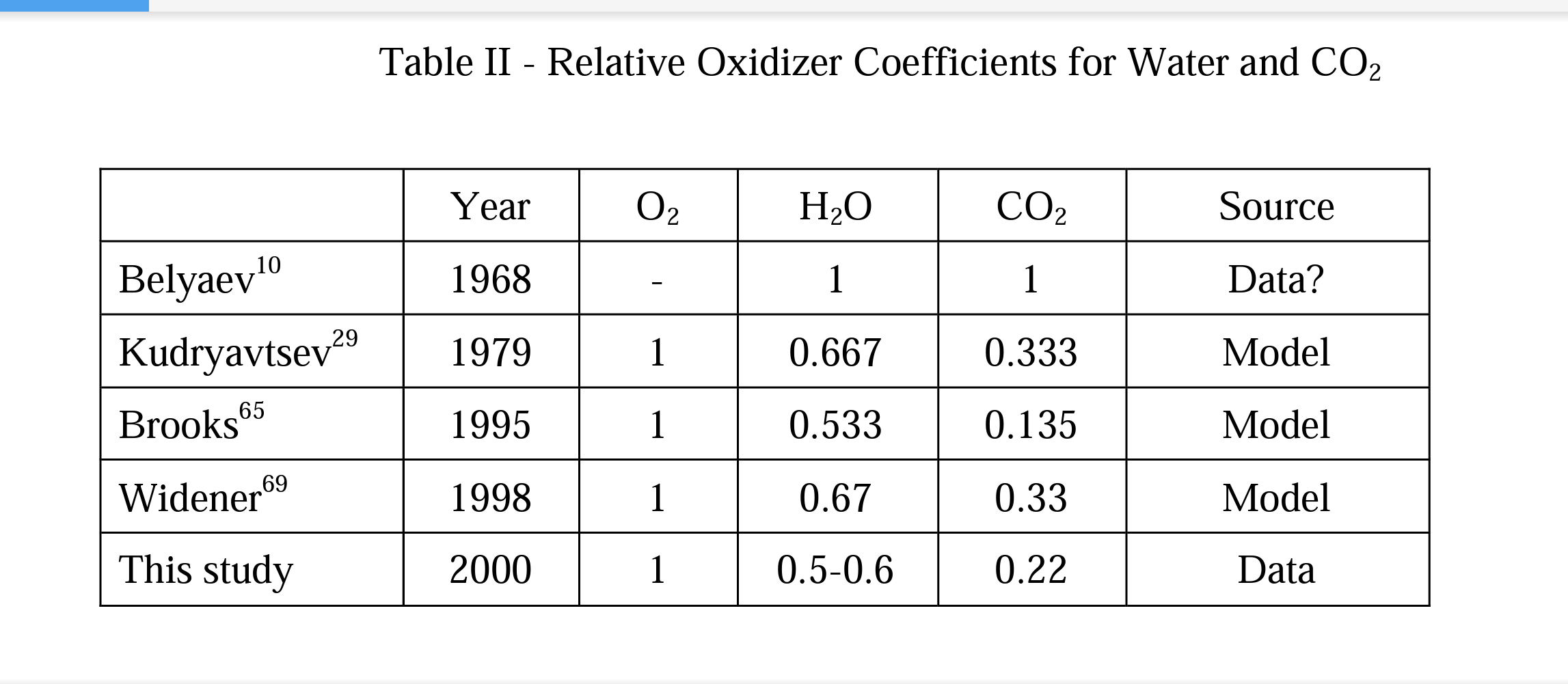

True thermobarica do not function well underwater due to lack of atmospheric oxygen.
Aluminum (which torpex has a high % of, along with TNT and RDX) reacts just fine with the Oxygen from water vapor, CO and CO2 inside the big bubble formed by an underwater explosion.
20171115_004152.png - 144kB
Thermobaric? Not as I generally see the military use the term, but it DOES make use of environmental Oxygen to after burn a fuel and prolong the pressure pulse. Just not the free O2 in air.
Attachment: Summary of Aluminum Powder Testing.pdf (853kB)
This file has been downloaded 350 times
[Edited on 15-11-2017 by Bert]

[*] posted on 30-11-2017 at 17:53
According to Davis, it was easier to synthesize TNT and demethylate that than do the brute force tri nitration of benzene itself.
20171130_185412.png - 722kB
20171130_195433.png - 577kB
