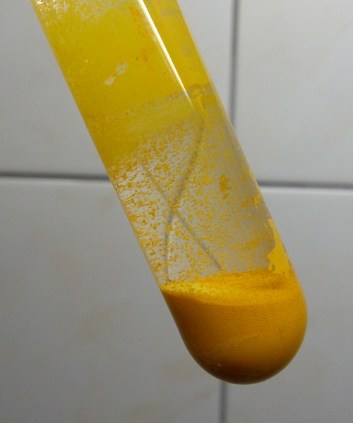

By accident I found a rather surprising reaction between thiocyanate ion and nitric acid. The experiment is very simple:
Prepare a very concentrated solution of NH4SCN or KSCN in water (e.g. 1 ml). Add 2 times its volume (e.g. 2 ml) of concentrated nitric acid (65% HNO3 by weight). Swirl the test tube.
When this is done, then a very pale pink liquid is obtained. This pale pink color may be due to some reaction product, but it might also be due to a tiny amount of impurity in the reagents.
Next, carefully heat the test tube, while swirling. At a certain point in time, the liquid turns turbid and yellow and some gas is produced. Keep on heating, until the production of colorless gas goes smoothly and a lot of a yellow solid is obtained. Then stop heating. The reaction continues. The colorless gas most likely contains quite some NO, because in contact with air, brown gas is formed (which must be NO2). The liquid starts foaming.
After the reaction, there is a lot of yellow solid material. I added a lot of water to the test tube, so that all of the solid material is under water and then allowed the material to settle at the bottom. The result is in the following picture:
oxidized_thiocyanate.jpg - 87kB
I am wondering what this yellow solid is. I could not find info about this on internet. There are documents about oxidation of thiocyanate, but these talk about formation of (SCN)2, which is colorless or further oxidation to sulfate and cyanide.

My first guess would be sulphur.
Posts: 7774
[*] posted on 2-12-2013 at 12:39
Of course, I also checked that, but that is not the case. At first, the color is quite different, sulphur is much lighter and more greenish yellow. This yellow color is more like ochre. I tried the experiment multiple times and in some runs it almost is orange, while in others it is like the color shown in the picture.
Another thing is that the material is soluble in warm bleach. It slowly dissolves, giving a colorless solution. Sulphur does not dissolve in warm bleach.

I kept on heating. After a minute or so, gas was produced, but at the same time the liquid started boiling. The liquid also becomes turbid and a yellow/orange solid is produced. The gas mix is flammable, when a flame is kept near the open end of the test tube, then the flame goes into the test tube without any sound.
On longer heating, some compact yellow/orange solid is formed. Further tests of the gas mix did not show any flammability, probably the gas mix is a mix of HCN and a lot of water vapor. There was a peculiar smell though, but as soon as I smelt that, I stopped the experiment and left the room (maybe I smelled the HCN, the smell was not bad or pingent, but I dared not continue the experiment). Now, I have the test tube loosely stoppered, standing in my lab.

I have just found the following excerpt in Richter's Organic chemistry vI that I think explains both the action of nitric and sulphuric acid on thiocyanates. It would appear that fairly strong no oxidising acid liberate thiocyanic acid which then polymerises even in the cold to dithiocyanic acid which with KOH give the sparingly soluble K salt. Boiling with acid decomposes the free acid.
Oxidising agents give Cyanogen sulphide or cyanogen pseudosulphide. The former may result from the reaction of liberated sulphur with dithiocyanic acid. The so-called cyanogen sulphides seem rather uncertain compounds so I did an online search for them to see if anyone had subjected them to modern investigation but found nothing "modern".
The "xanthene hydride" sound like it could do with a modern investigation too. It looks like this is from the A Fleischer reference I posted; I'll request them and see what they have to say.
[Edited on 10-12-2013 by Boffis]
Xanthane dithiocyanic Richter p468.jpg - 170kBXanthane dithiocyanic Richter p467.jpg - 67kB

I read the following and what is mentioned here may also explain what I observed:
http://carbon.atomistry.com/thiocyanic_acid.html
HSCN apparently decomposes to COS and NH3 as well when heated. So, the flammability I observed may not (only) be due to formation of HCN. COS is flammable as well and burns with a pale blue flame. The flames I observed indeed were pale, but HCN also has a fairly pale flame as far as I remember.

After two days of standing, the liquid deposited more yellow material. This material has a lighter color than the material I had after the heating. It is yellow, like the skin of a banana (without the black spots) and seems to have the same matte texture.
I decanted all liquid from the yellow material (which is yellow as well, and clear) and then I added some ethylene diamine. The material dissolves very quickly and the resulting solution is dark olive green. In very thin layers (liquid sticking to the glass), the solution looks yellow.
As a counter experiment, I added a drop of water to my dry yellow/ochre powder from my earlier experiments and then I added a small amount of ethylene diamine to that as well. That solution is dark red at very high concentration and is orange/yellow at lower concentration.
To both solutions I added a lot of water. The resulting solutions are yellow.
This experiment adds more questions than answers. Why the different colors? Is the result of heating with H2SO4 instead of HNO3 really different?
