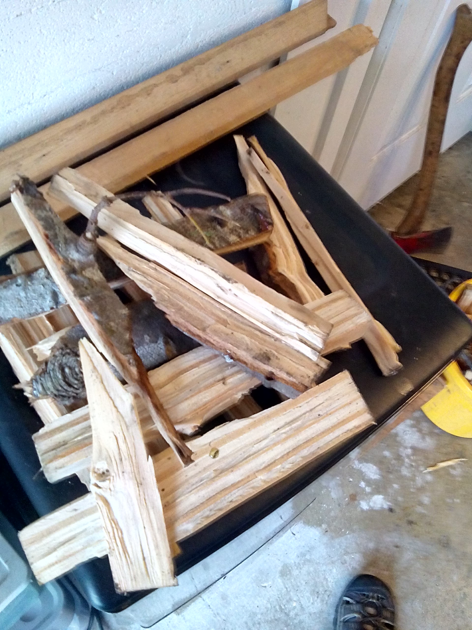

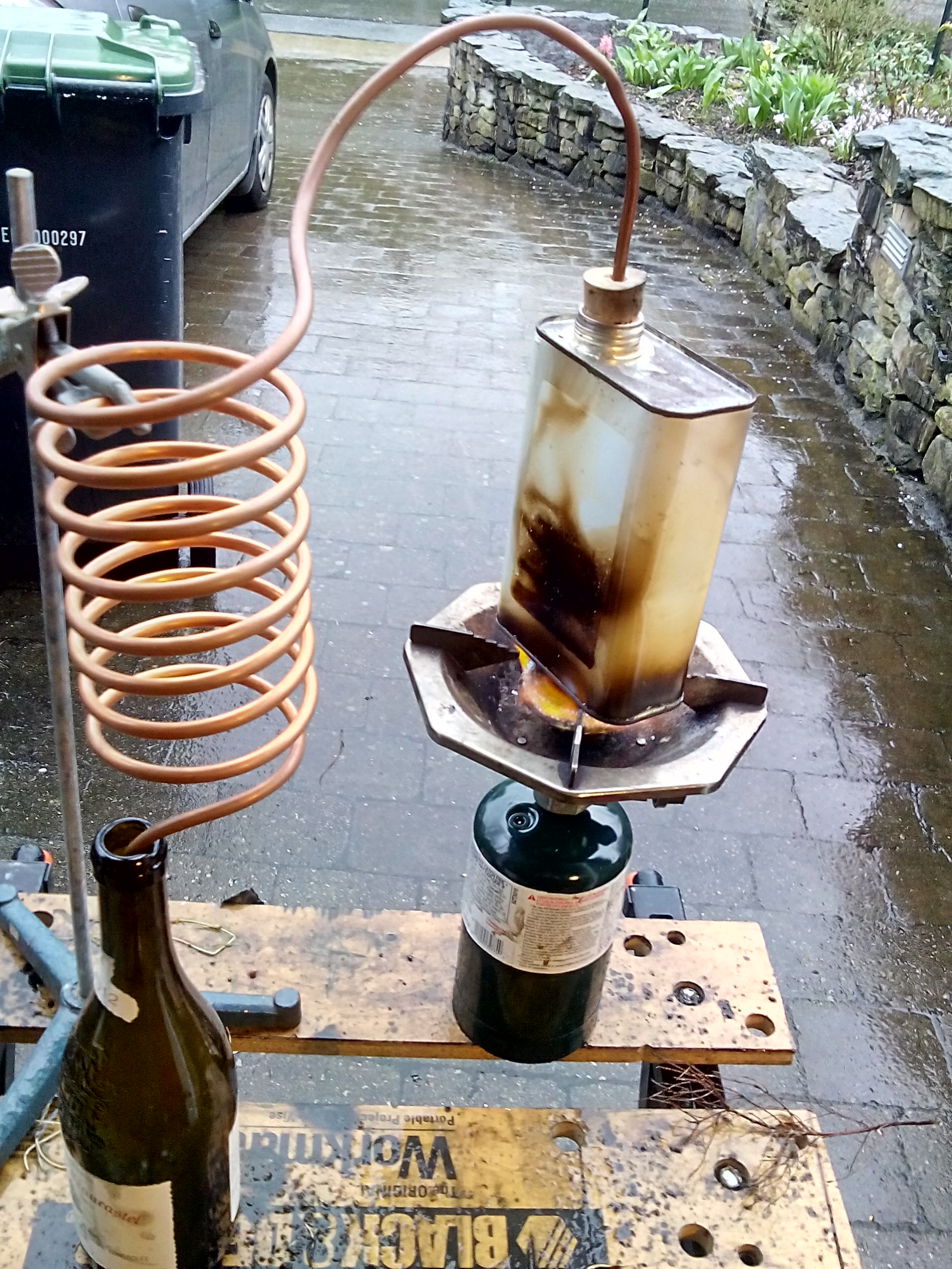

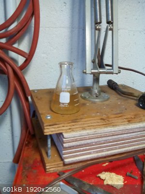

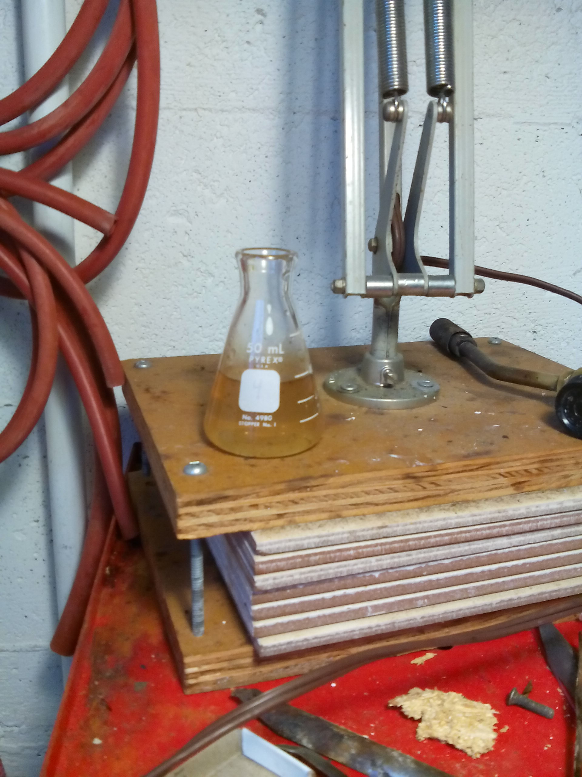

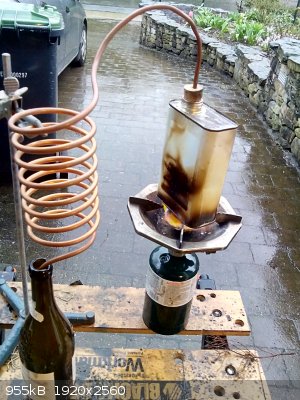

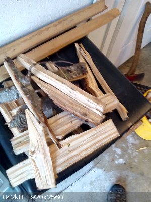

Here are some results (with photos) of my attempts to get Methanol from wood. I cut up an old evergreen stump, put them in an improvised setup, and distilled some liquid. It smells like crap and is mostly water.

I think the wood is usually thoroughly dried (in an oven) before pyrolysis. If you didn't dry the wood, it's no wonder your distillate is mostly water.

It smells like musky burning, almost like a phenol synthesis gone wrong.

The smell is probably due to guaiacol and/or syringol, from lignin pyrolysis:

Wood alcohol was usually made from low turpene hardwoods. Evergreens are a poor choice due to high turnene content. And drying at mid range temperatures is essential to avoid too much water.

[*] posted on 13-3-2016 at 08:09
Yeah I'm drying it out now to try again soon, and I also have a better apparatus this time.
