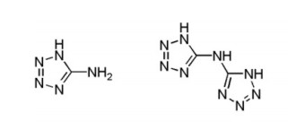

5-aminotetrazole is now a well known and fairly accessible nitrogen rich heterocyclic but the di-substituted amine analogue is less well known.
71 BTA comparison.jpg - 6kB
A comparison between the structures of bis(5-tetrazolyl)amine (Right) and 5-aminotetrazole
There are two principle routes to this compound, one from cyanuric chloride and the other from sodium dicyanamide; other methods are summarised in the reference cited below but are either subtle variations of these method or via the addition of a tetrazolyl group to 5-aminotetrazole using cyanogen bromide and sodium azide. The former method is due to Nedel'ko et al. 2005 (1) and is a four stage synthesis with an overal efficiency of about 20% and proceeds via a rather sensitive bis-azido triazine. While of interest this synthesis is rather low yielding and potentially hazardous.

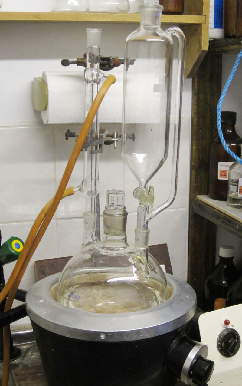

In 3 neck 3L r.b. flask were placed 44.51g of sodium dicyanamide and 65.01g of sodium azide. To these were added 400ml of 95% ethanol and 400ml of water and the flask swirled to disperse the solid which do not dissolve at this stage.
70 BTA synth acid added.jpg - 130kB
Initial reaction mixture after addition of all the hydrochloric acid giving a clear solution.
The flask was place in a heating mantle, a reflux condenser and a large (600ml) dropping funnel added and the flask heated almost to boiling. From the dropping funnel were added 155ml of 30% HCl, diluted with 500ml of water, over a period of 5 hours while maintaining a steady gentle reflux. After the addition the flask was refluxed for a further 43 hours (48 hours in total), cooled a little and poured into a 2 L beaker; a white precipitate beings to form almost immediately so 85ml of 36% HCl were added immediately in one go while the solution was still hot. The solution was stirred and allowed to cool to room temperature then chilled in the fridge until the temperature reached 4°C. A large amount of very fine, pure white, BTA monohydrate separated quickly upon acidification.

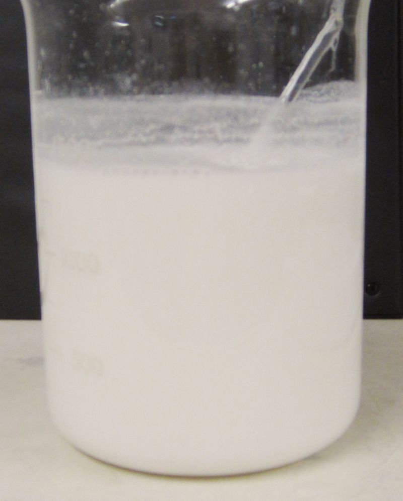

70 BTA synth cooling.jpg - 64kB
Precipitating BTA monohydrate after the addition of the concentrated hydrochloric acid.
When cold the precipitate was recovered by filtration at the pump (Note 1) and washed with a little cold water and then 95 % alcochol and sucked as dry as possible. The precipatate is very fine and filters slowly. The filter cake was broken up on a large watch glass and dried to constant weight on the back of an operating oven (40-45°C) for 24 hours, the yield was 84.02g of crude bis-(5-tetrazolyl)amine monohydrate. This is almost theoretical yield and it is suspected that it is either not fully dried or contaminated with sodium chloride.
