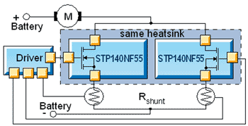

Yeah for the nuts and bolts approach to a high efficiency linear I was first looking at using a variac to control the input to the primary on a large fixed transformer with rectification and huge capacitor filtering to follow , and then a linear post regulator ganged with the variac ....to keep the dissipation to a minimum for the linear regulator which would just clean up the last bit of ripple . Same idea with the SCR but probably a bit spikier using the SCR pre-reg instead of using a variac to keep the sine wave intact .
For about a month Der Alte and I were discussing in U2U's my proposed idea for a post regulator for an ATX supply
using two IRFP3703's as series elements in a negative regulator scheme . I modeled that VCCS module using LT Spice and never was satisfied with even the C-Load LT op amps capability to drive that capacitve load without peaking problems showing up in the spice simulation . I then used an active low pass filter as a buffer and an emitter follower
NPN 2222 as the mosfet driver , limiting the gate drive voltage in the 1.5 to 6 volt range for linear region operation and that works . All the DC analysis tracks perfectly with what I had figured , and it checks out fine , but the small signal AC analysis that LT Spice is generating is pure fiction ......showing impossible results , inverted signals and so much garbage that it is about like I had predicted and expected , the spice simulator isn't sophisticated enough to give it a fair rendering . No escaping actually building the circuit for testing and using a real life oscilloscope on this one .
Multisim might track it better with a large signal AC analysis , but LT Spice is full of shit on small signal AC analysis , simply by looking at the voltage scale and knowing that there isn't enough threshold on a mosfet to have any output , while LT Spice happily bullshits its way along with those small signal AC analysis figures .....like a mosfets gate threshold is at zero instead of 2-3 volts where it is in the real world .
Probes of node readings show voltage and power inversions
and differential voltages when you have the reference set for ground .....so the sim has gone nuts trying to track what it can't .
The spice models for linear region operation of mosfets are pure crap too so that may be part of the simulation problem .
Another simulation anomaly you'll see is in phase opposite voltages on op amps inputs in a closed loop which is another impossibility . What I am seeing with spice sims is it does pretty good with simple known templated stuff but totally lapses and loses it with AC analysis of complex circuits , and spits out "would you believe this?" kinds of results .....while I sit there saying no , not hardly :D
Anyway , what I have been contemplating doing is a known and published configuration with regards to the VCCS ...so I am not just way out in left field , it can be done , though the devil seems to be in the details
image from negative regulator linear application for power mosfets writeup on the following page
http://www.st.com/stonline/products/families/transistors/pow...

Rosco Bodine
Banned
Posts: 6370
Registered: 29-9-2004
Mood: analytical
biggrin.gif posted on 22-10-2007 at 11:18
Well lookee here what I found
Here's an STM scheme for infinite speed control of an automotive heater and air blower , which looks a whole lot like the negative regulator scheme which I have been proposing , not exactly , but very closely similar .
from the following page
http://www.st.com/stonline/press/magazine/prodnews/2ndedi00/...
The "On Dashboard Module" part of this regulator scheme doesn't seem to be fully disclosed in detail , and may be proprietary ....which goes precisely to what I was saying earlier about the devil being in the details :D
But the general idea of what I am trying to do is possible ,
as can be seen here .
[Edited on 22-10-2007 by Rosco Bodine]
