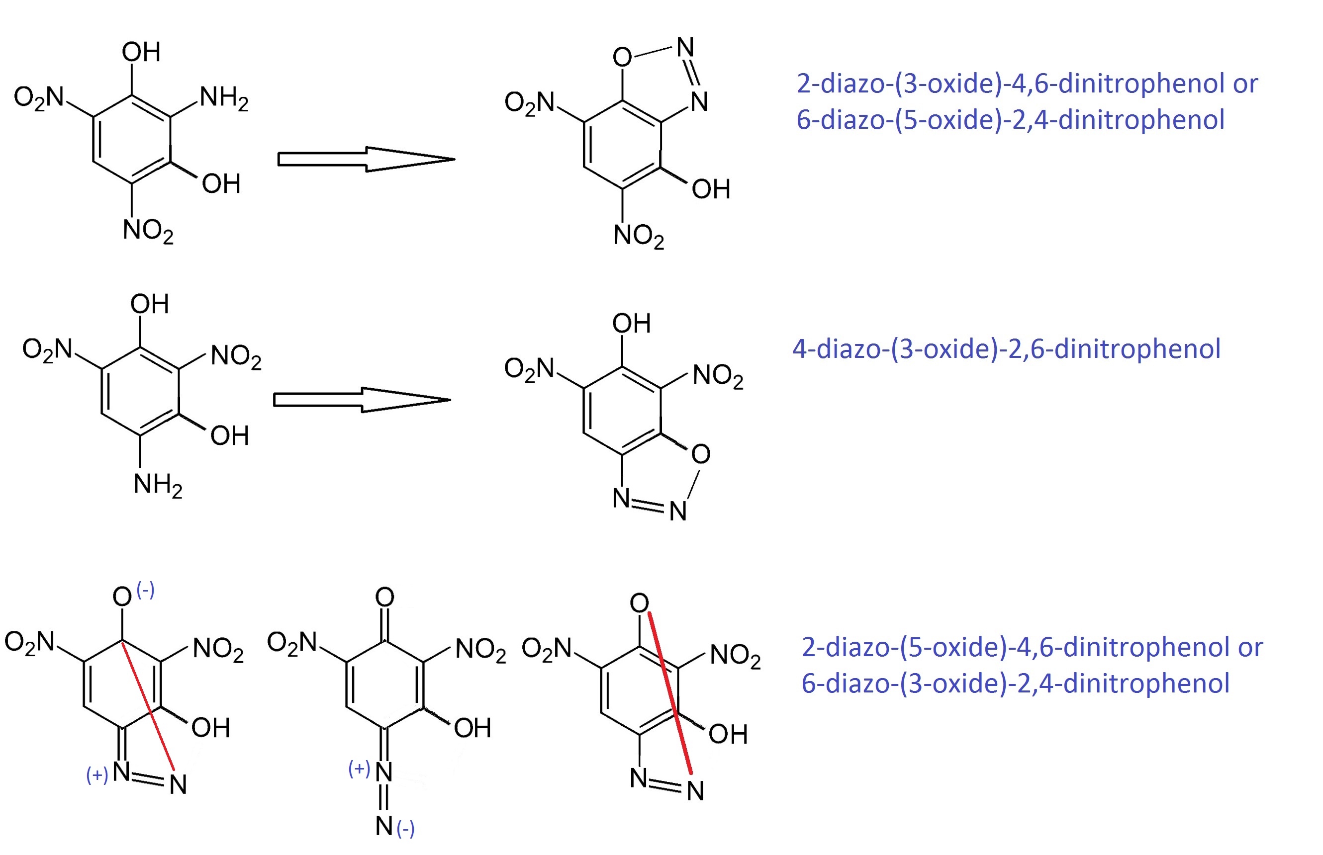

Rosco also believes that for DDNR the diazo-oxide forms straight across the ring as a para structure, not bonding with the hydroxyl that is ortho, adjacent as occurs for o-DDNP, but like the structure of the diazo-oxide found with p-DDNP. The tension across the ring bends the entire ring structure like a hexagonal spring wave washer being bowed by tension across its opposite vertices at para positions 1 and 4, and the diazo-oxide structure is the bowstring.
[Edited on 2/21/2017 by Rosco Bodine]
Simply ask and voilà added :D
The structure of trans-diazo is stil a bit mysterious...in reallity it must display a trans quinonoid structure so that both sides can bend onto the same side of the paper plane while the diazo connects to the opposite side...but connectivity is a bit hard to figure out. Into the book Traité de chimie organique Azoiques-diazoiques,.... they mention that the probable connectivity passes via a direct link between the N2 and the Cs on both sides thus without the oxygen being involved...a bit a cage structure related to DABCO(DiAzaBiCycloOctane) but with the Ns at other places and with unsaturations...anyway this is highly stressed...
DDNRs.jpg - 363kB
That looks good except for the first entry should be 2-diazo-(1-oxide)-4,6-dinitrophenol instead of the 3-oxide you show.
The middle compound is synonymous with what Klapotke called HODDNP
Looking at the last listing, the 6-diazo-(3-oxide)-2,4-dinitrophenol nomenclature would work there for the structure inverted and rotated counter-clockwise 30 degrees.
It is the stressed structure that accounts for the surprising energy as an initiator compared with an ordinary styphnate.
Anyway, the convoluted nomenclature is in part or completely explained by not associating the compound with resorcinol as a derivative.
I think that different researchers working from different precursors and not making the association with resorcinol is why the failure to make attribution to the earlier references about DDNR that trace back to Benedikt and Hubl in 1881.
It could be the NMR data is correct but is referenced to structure nomenclature for phenol rather than resorcinol, then having all the expected resorcinol associated position numbers made into alternate expressions. Also, Klapotke identifies ortho bonding with the adjacent hydroxyl to the diazo as occurs with the usual o-DDNP. But the scenario we have involving p-DDNP is more similar and strongly suggests a diazo-oxide that is the same as DDNR, even though it would seem either structure is possible.

PHILOU, Where did 2-diazo-(3-oxide)-4,5 dinitrophenol / 6-diazo-(5-oxide)-2,6-dinitrophenol come from? I didn't write that. Who thinks that is the structure?

Thanks to Louis for the synonymous expressions. In the context of the alternative synonymous naming for DDNR, the issue with the NMR data for the diazo position is reconciled as not being a problem about the NMR data but the differing nomenclature, recognizing the same NMR data could correspond with a diazo at position 6 or 4 described by different diagrams orientation corresponding to different long names and "parent" compounds. There is still a question about the diazo-oxide configuration, whether it is the hydroxyl oriented ortho or para to the diazo, that becomes an anhydride in forming the diazo-oxide.
The differing nomenclature for the same DDNR compound seems to be the best explanation why all the older prior art references were not included by Klapotke, and why the DDNR is being called a "hydroxyphenol" which is technically correct, but diverts attention away from the prior art for DDNR referenced as a derivative of resorcinol.
Making this still more confounding is that isomers are possible, for the DDNR, although in this particular case I believe the compound [8] identified by Klapotke is the same compound identified in 1881 by Benedikt and Hubl, later by Mendola and others.
I think the uncertainty of which hydroxyl (ortho or para to the diazo) is intact and which hydroxyl becomes the anhydride associated with the diazo has contributed to the confusion.
I think these 2 linked posts were the earliest posts where I was questioning the structure being identified, and saying I thought the hydroxyl and anhydride were transposed
The significance of what I am trying to say is that Klapotke's compound [8] and DDNR are one and the same.
Based on experiments reported by nitro-genes there is a niche reaction condition that allows for (probable) DDNR to be formed from a paracetamol precursor, without having to first further acetylate paracetamol to a diacetyl derivative.
The interesting and bizarre story here is that over a period of 134 years, four or five different researchers have made the exact same compound, (DDNR) by different methods and called it by different names, "reinventing the wheel" as if it were invented for the very first time :D And it seems nitro-genes has added another chapter to the story, not yet fully sorted out.

PHILOU Zrealone
Posts: 2894
Registered: 20-5-2002
Location: Brussel
[*] posted on 21-2-2017 at 19:17
You indeed wrote:
6-diazo-3-hydroxy-2,4-dinitrophenol aka 6-diazo-2,4-dinitroresorcinol
and
4-diazo-2,6-dinitroresorcinol.
Those are ambiguous names as seen in the practice by all of us when trying to understand each others between forum members, but also when trying to understand and correlate the research of Klapote's team and previous early works from the past.(**)
So your wrongly named and ambiguous 6-diazo-3-hydroxy-2,4-dinitrophenol is the same as 6-diazo-3-hydroxy-2,4-dinitrophenoxide (an ortho diazo-oxide derived from 4-amino-1,3-dihydroxy-2,6-dinitrobenzen); while your wrongly and ambiguous 4-diazo-2,6-dinitroresorcinol is in fact refering to 4-diazo-3-hydroxy-2,6-dinitrophenoxide (a para diazo-oxide derived from the very same 4-amino-1,3-dihydroxy-2,6-dinitrobenzen)
As I exposed by drawing:
From trinitroresorcinol (1,3-dihydroxy-2,4,6-trinitrobenzen) by monoreduction of a NO2 group you only get two possible isomeric amino-dinitroresorcinol:
1°) the amino comes from reduction of the nitro trapped between te two NO2
--> 2-amino-1,3-dihydroxy-4,6-dinitrobenzen
2°) the amino comes from reduction of one of the two others NO2 that are next to one OH (in ortho) and in para of the other OH...and those only provide one isomer by degenerescence linked to the symetry of the molecule (the axis being between the two OH)...so reducing the 4 or the 6 nitro will always lead to 4-amino-1,3-dihydroxy-2,6-dinitrobenzen
From 1°) aka 2-amino-1,3-dihydroxy-4,6-dinitrobenzen
by diazotation you will get only one isomeric 2-diazo-oxide because the -N=N-OH may react (anhydrize) with the -OH in position 1 or with the -OH in position 3 what is the same (again degenerescence) also because of the inter-OH molecular symetry...
So in fact:
2-diazo-(1-oxide)-3-hydroxy-4,6-dinitrobenzene
is equal to
2-diazo-3-hydroxy-4,6-dinitrophenoxide (not phenol because the OH in position 1 is not present anymore and phenoxide means implicitely that the oxide is in position 1)
what is equal to
2-diazo-(3-oxide)-4,6-dinitrophenol (the OH in position 1 implicitely)
and if you flip along the free OH axis this is equal to
6-diazo-(5-oxide)-2,4-dinitrophenol (cf supra)
From 2°) aka 4-amino-1,3-dihydroxy-2,6-dinitrobenzen
by diazotation you will get only two isomeric 4-diazo-oxide because the -N=N-OH may react (anhydrize) with the -OH in position 1 (thus in para position vs itself) or with the -OH in position 3 (what is ortho position vs itself)...
So in fact:
para case
4-diazo-(1-oxide)-3-hydroxy-2,6-dinitrobenzene
is equal to
4-diazo-3-hydroxy-2,6-dinitrophenoxide (not phenol because the OH in position 1 is not present anymore and phenoxide means implicitely that the oxide is in position 1)
what is equal to
2-diazo-(5-oxide)-4,6-dinitrophenol (the OH in position 1 implicitely)
6-diazo-(3-oxide)-2,4-dinitrophenol (cf supra)
ortho case
4-diazo-(3-oxide)-1-hydroxy-2,6-dinitrobenzene
is equal to
4-diazo-(3-oxide)-2,6-dinitrophenol
what is equal by flipping along OH axis to
4-diazo-(5-oxide)-2,6-dinitrophenol
what is equal to
2-diazo-(1-oxide)-5-hydroxy-4,6-dinitrobenzene
what is equal to
2-diazo-5-hydroxy-4,6-dinitrophenoxide
what is is equal to
6-diazo-(1-oxide)-3-hydroxy-2,4-dinitrobenzene
or
Yes you start to feel dizzy and suffer from vertigo...your brain is overheating and fuming :D:cool::);):P and this gives you a better view of the problem...
(*) So what you wrote implicitely is exactly what I wrote explicitely...
I deliberately noted the oxide place and number to make things clearer...because this is the main source of confusion...
I really think that everybody here should always do so...to be sure what we speak about.
(**) If there is little ambiguity (***) when dealing with DDNP beause the diazo can only form a single diazo-oxide with the only OH present; when dealing with dihydroxyphenol (resorcinol)...confusion arises and speaking about DDNR becomes a problem.
In common usage for the future we should refer DDNP to be Diazo-Di-Nitro-Phenoxide and not Diazo-Di-Nitro-Phenol because the -OH is inexistant into the molecule...for analogy it is like saying that CH3-O-CH3 is methyl-methanol...while it is an ether (dimethyl-ether).
(***)The tiny ambiguity may come from the various true isomers and from the effective numerotation/nomenclature used...
so a little molecular drawing is never too much.
[Edited on 22-2-2017 by PHILOU Zrealone]

Paracetamol is the starting material for p-DDNP and p-DDNR and each are expected to have enhanced properties over their more commonly known analogous ortho isomers.

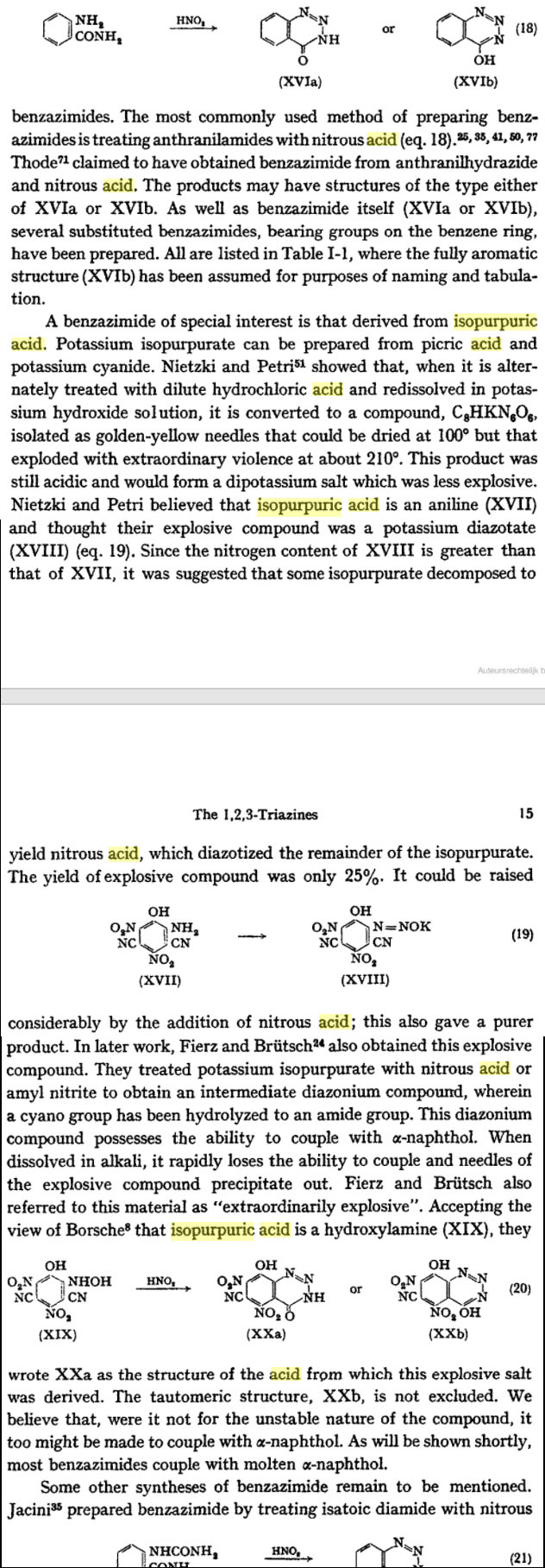

Why the reaction of trinitrophenol and cyanide occurs so readily to form isopurpuric acid is beyond me, but the product upon partial hydrolysis of one of the nitrile groups and diazotization to the benzazimide seems OTC. "explodes violently at 210 deg C" sounded promising in any case :D.
Seems the reaction of nitrophenols with cyanides to purpuric acids was already discussed to some extent in this thread:
https://www.sciencemadness.org/whisper/viewthread.php?tid=10...
Though no mention of a diazogroup or benzazimide, so I therefore decided to post this in the DDNP thread. Technically, the compound contains a diazogroup, two nitro groups and a hydroxyl, so posting this here seemed appropriate.
Haven't seen much on benzazimide derivatives as energetic materials before. Also curious what the reaction of cyanide and TNP would do when no excess of cyanide is used. Interesting reaction, probably occuring via a meisenheimer complex due to basicity and nucleophilic attack by the cyanide ion like in VNS, but if so why can't you directly add an azide group on TNP? The reduction of one of the nitrogroups is maybe helping here, but where did the missing oxygen go, is cyanate maybe acting as the nucleophile here?
Isopurpuric acid and benzazimides - Copy.jpg - 288kB

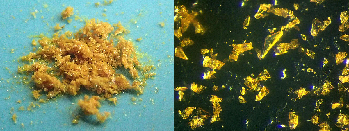

Previously I attempted the further nitration of isopicramic acid using KNO3/SA and obtained a small yield (<10%) of 2,3,6 trinitro 4-diazophenol for which the 3-nitrogroup easily hydrolyzes producing 2,6 dinitro 4-diazo resorcinol. I was curious if using nearly anhydrous mixed acids and very low temperatures to suppress oxidation as much as possible could produce a higher yield.
2 grams of isopicramic acid (0.01 moles) was dissolved in 30 grams freshly distilled azeotropic sulfuric (98.3%) at room temperature. The dissolution itself was not only somewhat exothermic but also released some gasses. the clear orange solution was then put in the -23C freezer and when fully cooled, 1.39 (0.022 moles) grams of ~98% nitric was added, briefly swirled and put back in the freezer. A small sample was taken, crashed on ice and diazotized every day, the first few days, mainly p-DDNP was produced, indicating that nitration at these temperatures is VERY slow. After 5 days in the freezer still large amounts of a light yellow compound were present (p-DDNP, 2,6 dinitrobenzoquinone, maybe the triazene Philou mentioned). Reckoning the nitration would take a month or so or wouldn't proceed at all at these temperatures, I decided to led it further react for 24 hours at 4 deg. C. in the fridge. The colour had then changed to a dark red and small bubbles were visible in the mix. While in the icebath, the mixture was then diluted dropwise with an icecold water/sodium nitrite solution to a total volume of 100 ml. Upon adding ethylacetate for the extraction, a pale yellow compound precipitated at the interphase, which I suspect to be the 2,3,6 trinitro 4-diazophenol itself. (Maybe it would precipitate from the dilute sulfuric as well with some more patience :)). Extractions were continued until all precipitate was extracted. When all ethyl acetate had evaporated, 20 ml of distilled water was added and left to stir at room temperature for 1 hour, the precipitate washed with another 10 ml cold water and dried. Yield was 0.37 grams of a light yellow crystaline solid, presumably 2,6 dinitro 4-diazo resorcinol.
I tried to grow well defined 2,6 dinitro 4-diazo resorcinol crystals from slow evaporation of a MEK solution, but it seems to react with the solvent itself, producing an orange coloured impurity. Similar to DDNP's, the best method of recrystallization seems from 65% nitric since this oxidizes most impurities. 100 mg of crude 2,6 dinitro 4-diazo resorcinol was added to a 20 ml beaker and made into a paste with a few drops of water. Then 65% nitric was added with slight warming untill everying dissolved (2 mls or so). Hot water was added to a total volume of 20 ml and put in the fridge for several hours. The DDNR crystallizes as long bright yellow plates (attachment).
DDNR - Copy.JPG - 319kB
Attachment: 2,6-dinitro-4-diazoresorcinol - Copy.avi (2.8MB)
This file has been downloaded 1243 times
[Edited on 31-10-2017 by nitro-genes]

No, the salts are supposedly extremely sensitive to friction and can explode upon crystallization, so I never made more than a few mg's. Even when a suspension of 2,6 dinitro 4-diazo resorcinol in water is stirred briefly with a neutral solution of KNO3, the potassium salt is already formed too some extend and the resulting product makes DDT in sub-mg amounts, so care should be taken to avoid any contact with metals or salts.
I'm not entirely sure this is 2,6 dinitro 4-diazo resorcinol as well, the product I obtained seems more easily decomposed in hot water and not sure if the reactivity towards MEK is also expected for the 2,6 dinitro 4-diazo resorcinol.

That is...if it really is DDNR...one of the things that strikes me is that the burn video of the pure compound isolated from the nitration of isopicramic shows hardly any sooth, despite the fact that DDNR would only have a marginally better oxygen balance compared to DDNP. The presence of the diazo group can be tested for probably, though another possible hydroxyl, the presence of an extra nitro group originating from a putative tetranitro 4-aminophenol intermediate would be hard to test for, since an ortho dinitro presence would be just as suceptible to nucleophillic replacement f.e as an diazogroup. If you assume however a tetranitro 4-diazophenol would actually exist, the diazogroup itself would likely be liable for decomposition, resulting in a tetranitro -p-hydroquinone, or tetranitro/pentanitrophenol. This seems very unlikely though, since the initial product of the nitration of isopicramic seems to produce NOx when reacted with water and not N2 gas, so this makes it unlikely that the product obtained is derived from a putative tetranitro compound.
I have wondered if it would be possible for the 2,3,6-trinitro 4-aminophenol to rearrange differently, maybe resulting in a furoxan or furazan group. Still wonder if DDNR would be able to form salts like is published, wouldn't this be hard to explain assuming a quinone or zwitter-ionic like structure? It is interesting to notice that the difference in elementary composition between an ortho-diazoquinone and a furazan would be negligible. Klapotke et al have found no furazan/furoxans though when heating 2,3,6 trinitro-4-aminophenol in 65% nitric. Besides, I doubt a furazan/furoxan derivative would behave as energetic in the burn-test-video I previously posted.
All in all the only likely possibility is that the compound is DDNR after all, pfff glad I could convince myself again. :D

Found an article about the synthesis of isopurpuric acid from picric and the benzazimides derived from them by further reaction with nitrous acid. Basically, the synthesis consists of reacting a reasonably dilute solution of picric acid with a large excess of potassium cyanide (seems very dangerous, releasing large amounts of hydrogen cyanide probably) to obtain a supposed 80% yield of the isopurpuric acid. Would be interesting to experiment with sometime, the salts of the resulting benzazimides are described as explosive even in minute amounts.
Attachment: php4gbXmg (466kB)
This file has been downloaded 749 times
