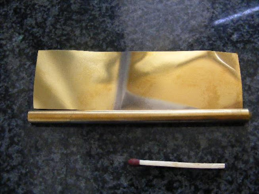

[*] posted on 28-7-2009 at 07:54
Yey, the samples are ready. I hope that Ill start the experiment today or tomorrow.
However a professor from my lab told me some bad news, he said tht he recalls that TiN pits while doing electrolisys in the presence of ClO3 ions so im not too optimistic.
anyway im going to dry this.
These are the two anodes. one is Ti foil coated with TiN and the other one is a Ti rod with TiN coating. the coating is very thin, sub micron.
[Edited on 28-7-2009 by hashashan]

hashashan
Posts: 255
Registered: 10-10-2006
[*] posted on 28-7-2009 at 10:13
He told me that he once did an experiment like this on his own, however he is quite sure he did it with HClO3, and HClO3 is much more agressive then a NaClO3 solution.
an an intermediate layer, well yes; if it wont work as an anode it will be a perfect intermediate layer, much better then the MMO, for me it is easier to get TiN then MnOx or SbOy/SnOx

[*] posted on 29-7-2009 at 00:30
Well, I have some bad news. I fired up an electrolysis yesterday and I got very weired results. The Ti-TiN works like a diode, it does not conduct as an anode.
As a cathode the coating peels off :(
I guess that the only chance is an intermediate layer. Now well have to wait until Ill make a PbO2 coating.

Sorry to hear about your discouraging results.
I just borrowed a TiN coated drill bit from a neighbor and electrolyzed brine with it for about 30 seconds (I didn't want to risk ruining it on him) in a stainless steel cup, and it seemed to work fine; i.e., a few volts gave a constant few hundred mA.
Then I took the bit out and looked at it and I couldn't see any obvious signs of damage...of course 30 seconds isn't long enough to say anything about it except that it seems to have good conduction.
hashashan
Posts: 255
[*] posted on 29-7-2009 at 16:13
very weired,
I had a chat with the professor again and he confirmed my results .. he said that it doesnt conduct as an anode and gets destroyed as cathode(not what he said last time but he is a weired dude)
anyway few volts over hundreds of mA is what I call not conducting :) 5V in a small cell should easily give you several amperes.
I did get some bubbling when using TiN as anode but it was extremely unefficient.
well I guess Ill have to do more experiments, maybe in a more controlled environement,
jpsmith are you sure you used it as an anode and not cathode?
