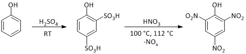

has anyone tried to nitrate salicylic acid?
Bert
Posts: 2822
Registered: 12-3-2004
[*] posted on 14-5-2018 at 13:44
Yes, I have done this.
Several other members have posted on this as well.
I have also used both methyl salicylate and acetylsalicylic acid. Most choose aspirin as the starting material.
