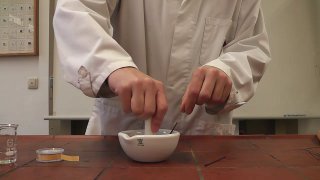

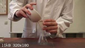

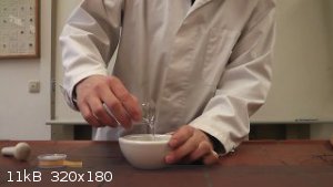

Playing around with sparklers on new year and the day after brought about this experiment.
Material
erlenmeyer flask, mortar, filter paper, funnel, spent sparklers, destilled water
Caution
barium hydroxide is corrosive, wear safety goggles
Experimental
Some freshly spent sparklers are ground in a mortar. Water is added and the resulting slurry is filtered to give a clear colorless solution of barium hydroxide. The solution can be used as is for a gas test of carbon dioxide. If carbon dioxide is present the solution will turn clowdy.
Explanation
Sparklers contain barium nitrate. On burning it decomposes to barium oxide, nitrogen and oxygen.
2 Ba(NO3)2 --> 2 BaO + N2 + 5 O2
Barium oxide remains in the ashes and reacts with water to barium hydroxide. The barium hydroxide can be extracted with water.
BaO + H2O --> Ba(OH)2
Pictures

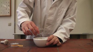

Bild1.jpg - 11kB Bild2.jpg - 11kB Bild3.jpg - 11kB

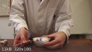

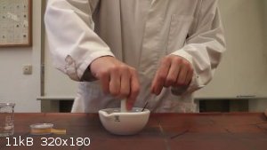

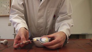

Grindig spent sparklers and adding water: the slurry is strongly alkaline.

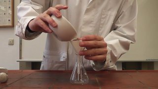

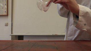

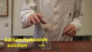

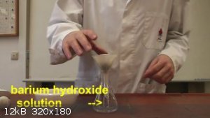

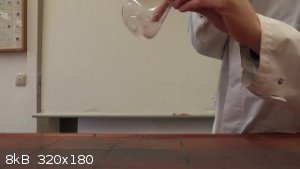

Bild4.jpg - 11kB Bild5.jpg - 12kB
Filtering and the resulting barium hydroxide solution.

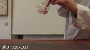

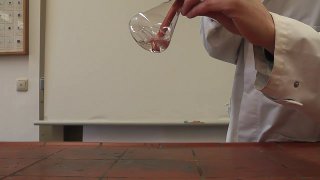

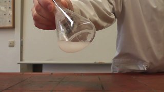

Bild7.jpg - 8kB Bild8.jpg - 8kB Bild9.jpg - 9kB
Gas test for carbon dioxide is positive.
