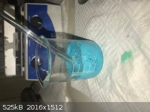

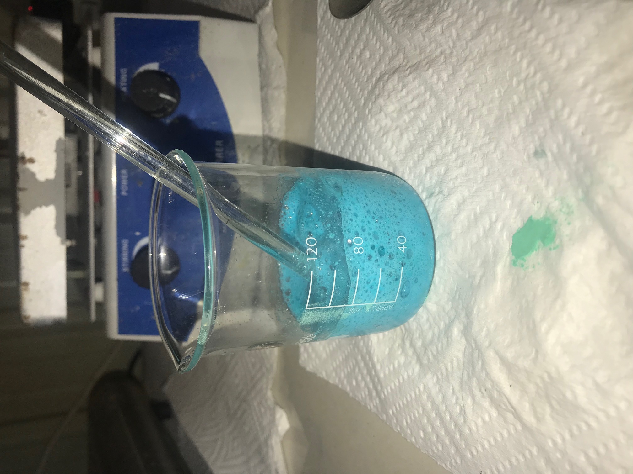

- Bubbles (of CO2) and blue suspension forming. Lumps appear to form that had to broken up with the glass rod.
- Add 30g water to thin the solution and the remaining copper carbonate – the extra water seemed to speed up the reaction. Photo below.

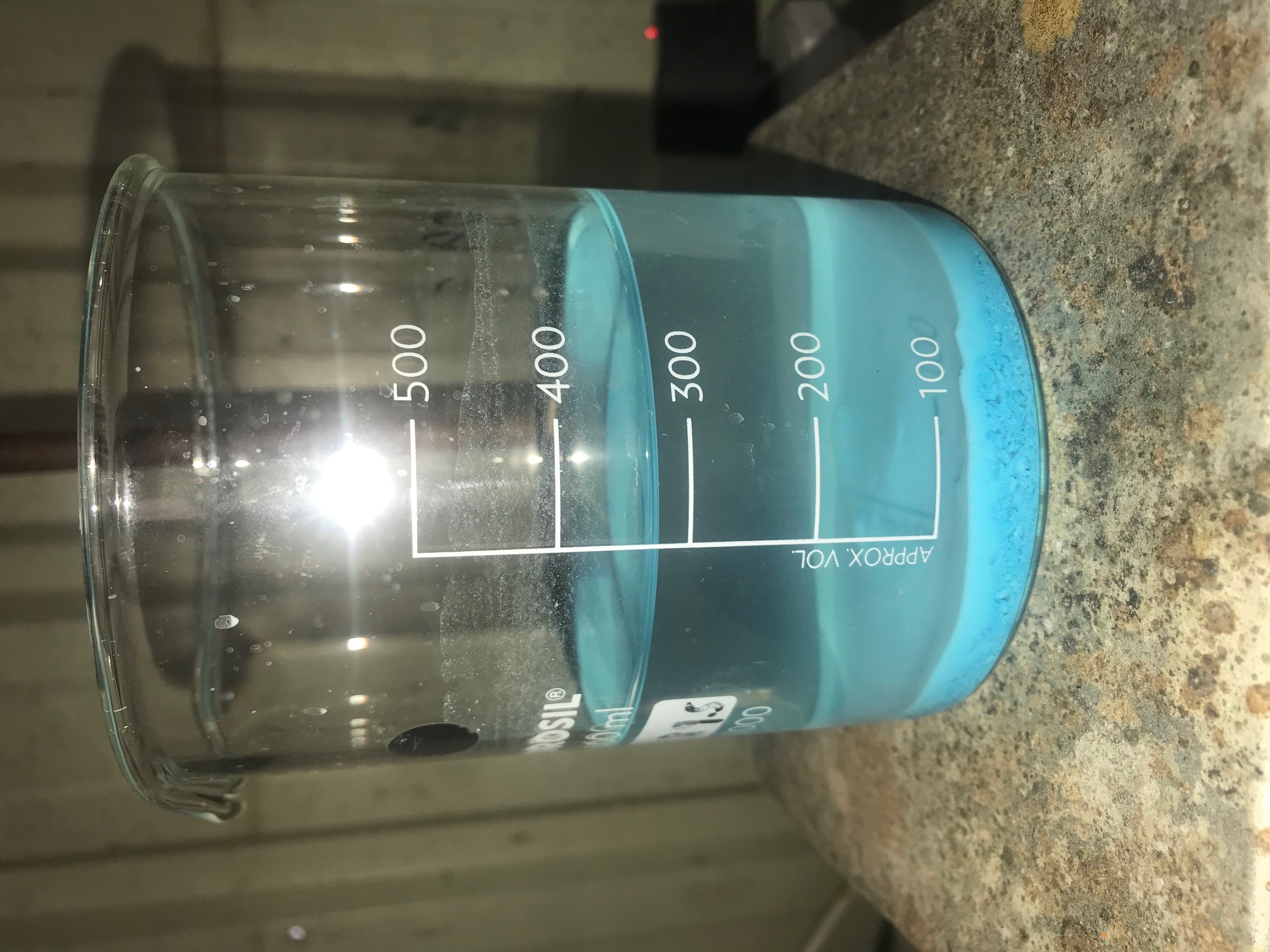

- Transfer to big beaker and wash with 3 portions of 300ml water by stirring, waiting for the ppt to settle, and decanting the wash water. pH between 3-4 after last wash. Photo after final wash below.
2.jpg - 631kB

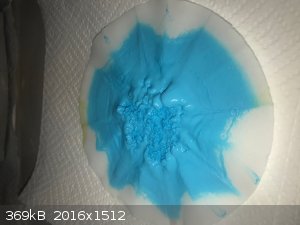

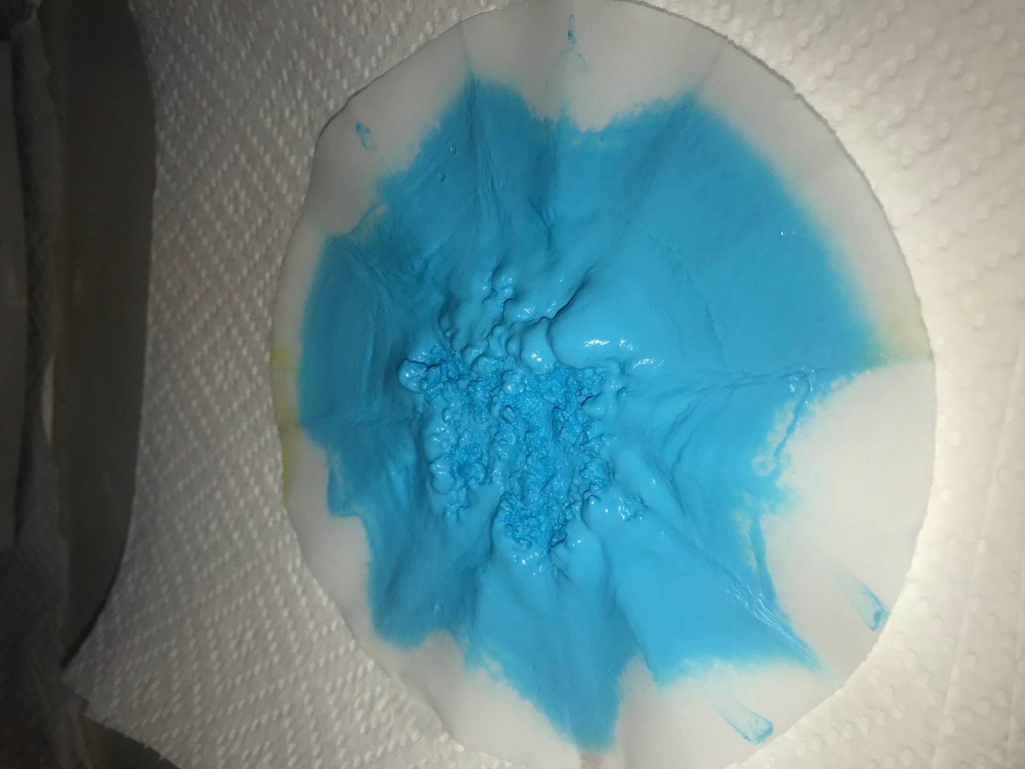

- Gravity filter and wash a few times in the funnel with water. Clear filtrate, Photo of wet ppt below.
3.jpg - 369kB

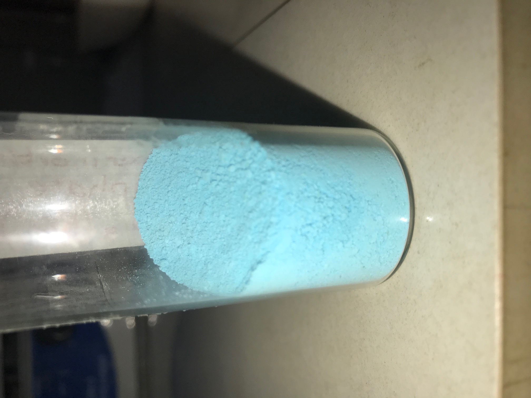

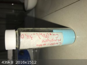

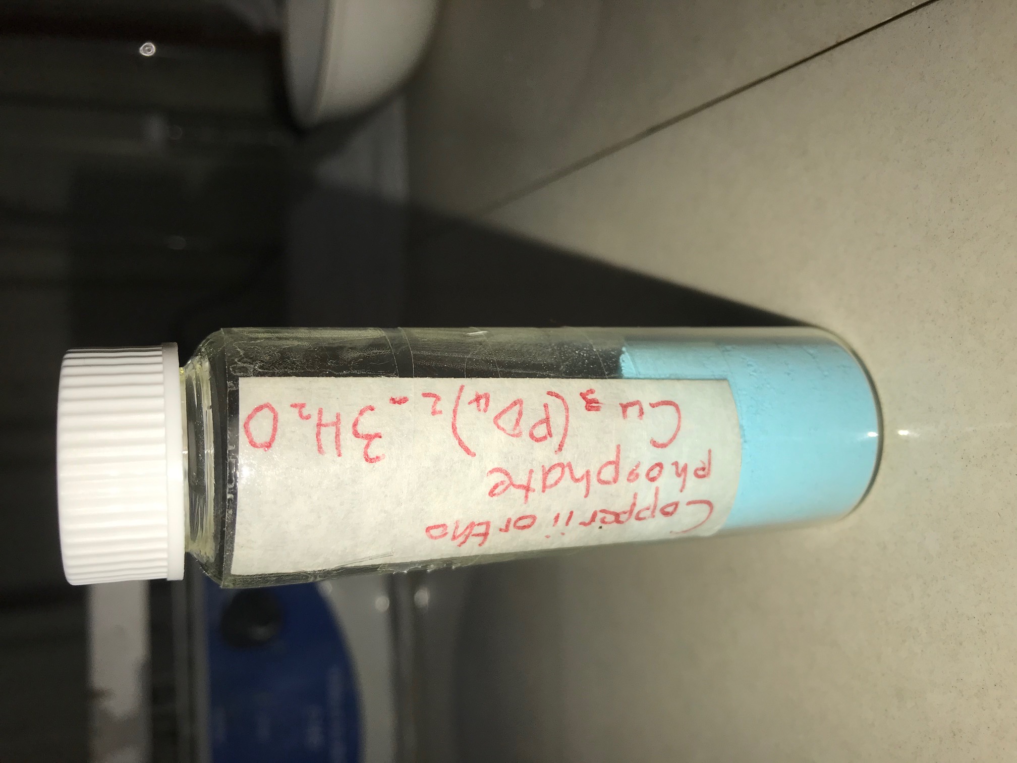

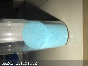

- 2g used for test, 13.7g bottled. Photos of final product below, drying did lighten the color slightly.
4.jpg - 392kB 5.jpg - 439kB
