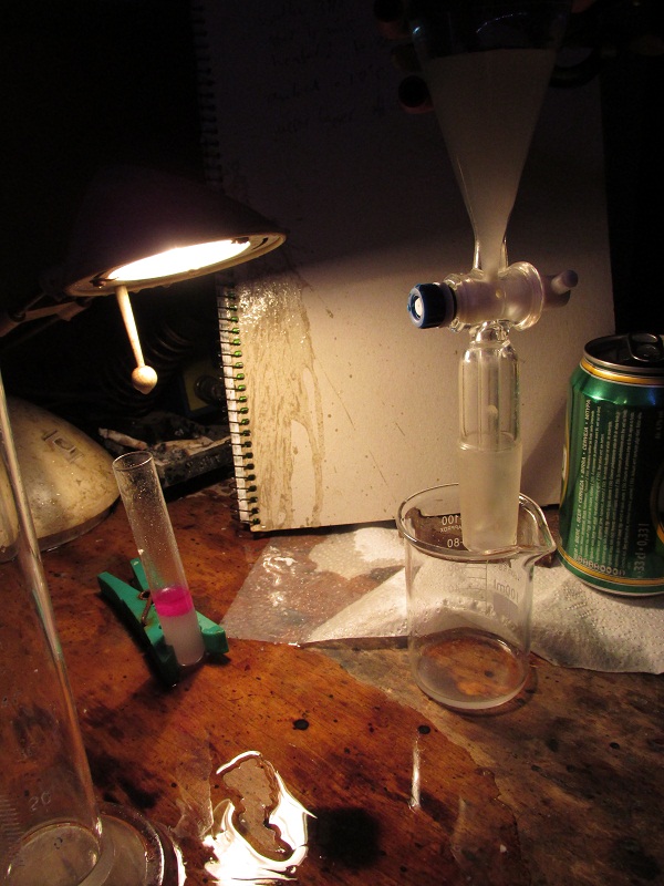

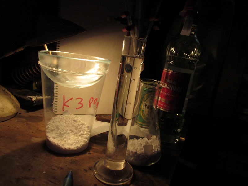

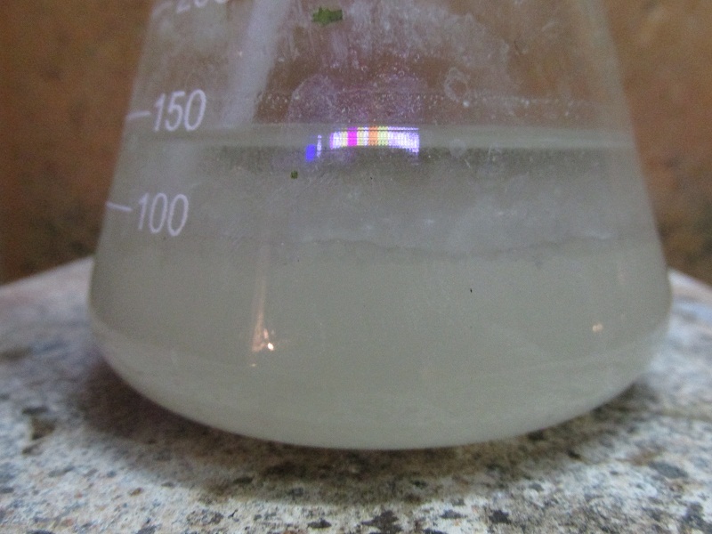

[*] posted on 11-11-2015 at 13:53
deltaH was off on one again while we were discussing this Ethanol separation method on skype.
The notion is that tripotassium phosphate is sufficiently hygroscopic and ethanol-hating that it can rip ALL of the water from the EtOH/Water azeotrope.
Sounded like bollocks to me, however there's One way to find out ...
start.JPG - 130kB
K3PO4 was prepared by reacting 3 mol equivalents of KOH with phosphoric acid.
This is a bitch to get to crystallise and dry, however determined boiling and a couple of hours in an oven @ 130 C worked to yield dry white powder (the hydrated crystal lumps are rock hard, a bit like Al Sulph).
An EtOH refractometer was calibrated with distilled water (DW), then some OTC Vodka was tested to be 37w% EtOH.
The solubility in water of K3PO4 calculates to require ~57g to completely saturate the water in 100ml of this Vodka.

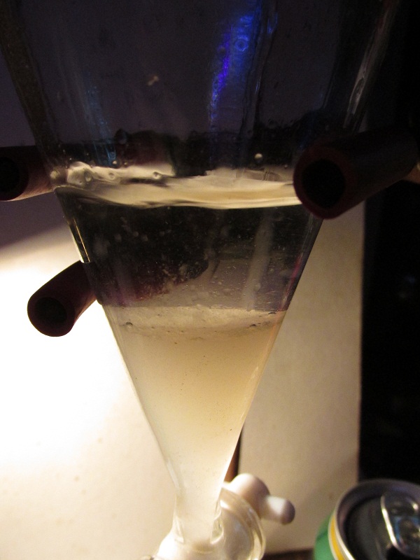

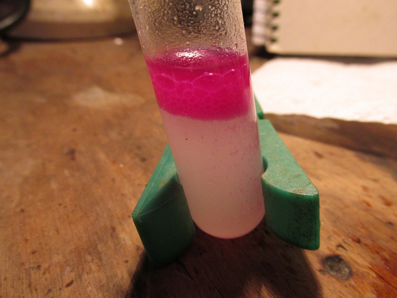

60g of dry tripotassium phosphate was loaded into a 250ml conical flask and 100ml of the Vodka was added, with a stirbar running for 4 minutes.
With stirring switched off, this mixture quickly formed 2 layers - within about 15 seconds.
twophase1.JPG - 142kB
This bi-phasic mixture was put into a 250ml separatory funnel, then quickly dumped back into the conical flask - the undissolved crystals would have blocked the tiny exit hole.
An attempt was made to filter with a standard filter paper, however the rate of flow was stupidly low, and the two phases were seen in the funnel.
Filtering into the sep funnel with a coffee filter was successful.
twophase2.JPG - 124kB
On deltaH's suggestion, some of the crude mixture was placed in a test tube and two drops of phenolpthalein were added.
... the idea being that the indicator would remain in the upper organic ethanol layer.
pink2phase.JPG - 136kB
Seems he was right about that.

A 140mm 24/40 ground glass-jointed funnel was used for the filtering.
I assumed the Seal of the ground glass joints was preventing the first filtration attempt, so raised the funnel using a clothes peg.
When operating the sep funnel valve the entire thing fell off, spilling about half of the product all over the desk area.

A few moments ago 43g of dry K3PO4 was added to 50ml of 4.5% beer.
The resulting mixture resembles more of a Gel than a liquid.
A few small clear droplets were occasionally observed on the top of the mixture, however the turbulence caused by the CO2 'fizz' made observation very difficult.
Likely that this process would not be useful for low EtOH 'mash' concentrations.
