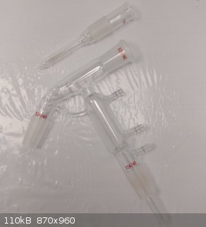

I could not find a shorter stem length thermowell, so I shortened one myself. It was just a shy too long to fit in the short path, but now it fits perfectly.
This short path is perfect for many distillations, especially vacuum with higher bp. I could not effectively monitor the temp prior to this.

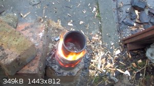

Need is the mother of invention so I have some ideas, especially I haven't much money and no job right now. This is one of these. Mini furnance from tin cans, metal pipe, a piece of garden hose and garbage bag. It works like bellow- by compression of air in garbage bag (using force)- air is moved trough garden hose and metal pipe into mini furnance and increase temperature of charcoal. By this way I melted aluminium and table salt (801 degrees C). Now I'm working with bigger version of this- for melting calcium chloride needed for electrolysis of molten salt.
Here is the video- how it works (translation to english isn't completed, some missing translation on the end):
https://youtu.be/gkhVcoaFBPs
Garbage_bag_hose_pipe.jpg - 230kBMelting_aluminium.jpg - 293kBMelting_aluminium2.jpg - 349kBMoltenNaCl.jpg - 208kBFurnance.jpg - 317kB

Today I tried my new improved furnance that use charcoal as fuel, powered with garbage bag. :D
It melted around 250 g of table salt in less than 10 minutes. However tin cans as inner part of furnance were completely destroyed due to high temperature after a half hour of heating. So I'll try some new tricks and make new furnance.
