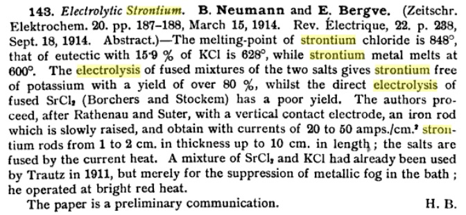

Referring to a previous page, here's the phase diagram:
https://www.sciencemadness.org/whisper/viewthread.php?tid=62...
Here's some more detail on strontium electrolysis:
Science Abstracts.png - 31kB electrolytic strontium.jpg - 116kB (pg. 62)
For whatever reason, it looks like temperatures given are wrong/sloppy in this reference.
