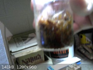

Maja
Posts: 143
Registered: 27-2-2006
ETHYL ACETATE !! IS A KEY !!! You won't believe.... I have found THE WAY to purify it using ETHYL ACETATE !!! Firstly I DID NOT noticed that
p-methoxyphenol has very low melting point ... When I tried to recrystall it from ethyl acetate I just heated it to near boiling point ... And didn't
thought about low melting point... And phenol just melted and too much of it was suspended in solvent... Today I have tried to heat solvent to 40*C
and then dissolve as much as it can take ... So when I was unable to dissolve more of it, I filtered solution and put it into the freezer(-25*C,
before I let it slowly cool to room temperature) after a few hours A LOT OF HUGE , NICE crystals formed with a little reddish tint. I'm sure that I
will remove that reddish color with another recrystallization. URA !

Look ... I have just made a few batches.... To see actual yield on recrystallization ... 2ml for 1g product and other batch with that recrystallized
product... used 0.5gr for 1ml. Now it's just sitting in freezer. Tomorrow will post recovery rates.I can afford low boiling petroleum ether ,but it
cost A LOT OF in my country ... The price is near as much as pyridine. So I will just stick to ethyl acetate. I fully agree with you that vacuum
distillation is the best option... But now I don't have access to vacuum source....
Here is the picture of once recrystallized product :
http://img108.imageshack.us/my.php?image=recrystallrz0.jpg
It is actually much cleaner than it looks like
So I will post results tomorrow ....

Ok, Ok .... Not very good news.... First of all SWIM wants to report about that 1g of that dirty 4-mp did not crystallized ..... If someone will try
this recrystallization, use 1ml for 1gr dirty product ! Otherwise it won't form crystals. Once recrystallized p-mp 0.5g in 1ml ethyl acetate nicely
recrystallized and formed big crystals... but YIELD was VERY LOW.... from 0.5g SWIM managed to get just 0.1g. I can blame small quantities and SWIM is
positive that he can get atleast 0.4g from 0.5g in BIGGER scale... Maybe evaporating 2x volume of solvet.
Friend of mine gave me this photo of p-mp.
Twice recrystallized :
http://img225.imageshack.us/my.php?image=2recrych1.jpg
Friend just thought that he is satisfied with once recrystallized product.Dunno about purity ,but it isn't bad as oily crystals... Thanks...

Solidified gunk from failed distillation attempt
Recrystallization of that gunk, clear but tan crystals
Crude product attained from extraction of the reaction mixture
Huge, clear crystals growing in xylene after only 4 H
