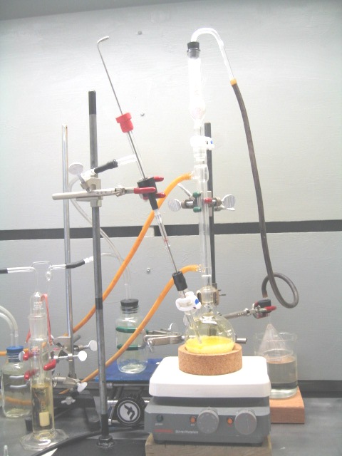

8. Equipment Set-Up
Note: All tapered glass joints that will be exposed to Cl2 are to be lubricated with Krytox grease. This will prevent the formation of the hard, sticky white residue that forms when silicone grease is used.
a. Cl2 Gas Generator and Dryer
1. Set up a ring stand with a 100 ml RBF w/Claisen adapter.
2. Place a 100 ml p-e funnel in the short neck of the Claisen.
3. Using a 2nd ring stand set-up a Cl2 gas dryer with H2SO4 to receive Cl2 from the long neck of the Claisen. Use 3/16” x 5/16” PVC tubing with PVDF/Viton tubing connectors.
4. Install a safety trap downstream from the dryer.
b. Reaction Flask
1. Set up a 3rd ring stand with mag stirrer and the 2-neck 250 ml RBF with chloroform.
2. Prepare a CaCl2 guard tube with 19/22 end and tubing adaptor.
3. Install the reflux condenser with guard tube in the center neck of the RBF with the chloroform.
4. Connect the T-shaped 3-way glass adapter with hose barbs to the sparge tube using one of the straight run barbs and PVC tubing.
5. Place an inverted rubber septum on the other straight-run barb and insert the 3/32” weld rod in the straight-run, piercing the septum.
6. Connect the branch leg of the T-connector to the dried Cl2 supply.
7. Using a 4th ring stand install the sparge tube in the side neck of the reaction flask complete with T-shaped 3-way adapter, inverted septum, and 3/32” ss cleaning rod..
c. HCl Gas Absorbtion Trap
1. Prepare 400 ml of 10% NaOH in a 600 ml beaker.
2. Connect the reflux condenser guard tube via ¼”rubber hose to an inverted funnel in the beaker of 10% NaOH.
9. Procedure
Purge the entire gas train and reaction vessel with an inert gas.
1. Charge the 100 ml RBF with the 25.8g of powdered TCCA.
2. Makeup 20% HCl by adding 30 ml of water to 43 ml of muriatic acid. Pour this into the p-e funnel (valve closed!).
3. Place the 2g of dried phosphorus in the RBF with the chloroform, along with a magnet stir bar. Turn the stirrer on high to dissolve the phosphorus.
4. Turn on the cooling water to the reflux condenser.
5. Begin the slow introduction of Cl2 into the reaction vessel using the sparge tube.
6. Closely monitor the reaction to maintain a steady boil. Monitor the outlet of the sparge tube to assure that it is not being plugged with PCl5 solids. Use the ss cleaning rod as necessary to push any solids out of the tube.
7. Continue the gassing with Cl2 until the product solution has turned yellow, indicating that all the P has reacted and the Cl2 is now dissolving in the chloroform.

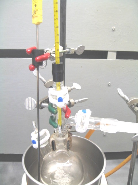

PCl5 apparatus.JPG - 73kB
PCl5 apparatus

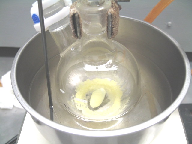

PCl5 in chloroform.JPG - 65kB
PCl5 in chloroform

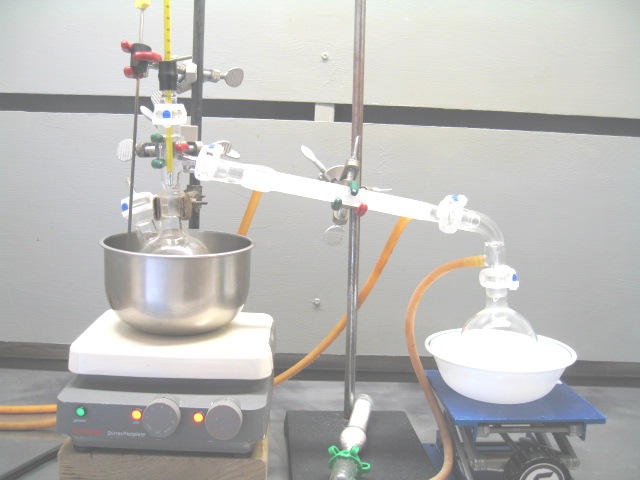

10. Distilling off the Chloroform/Carbon Tetrachloride from the PCl5 solids
1. Prepare the reaction flask for distillation. Heating is to be done with a hot water or hot oil bath.
2. Distill until nothing more passes over. Note how much higher boiling CCl4 comes over (bp = 76.7°C).
3. Stefan then opened the flask briefly (atmospheric humidity) and crushed the PCl5 solids with a spatula. Then the solids were heated some more to bring over more solvent.

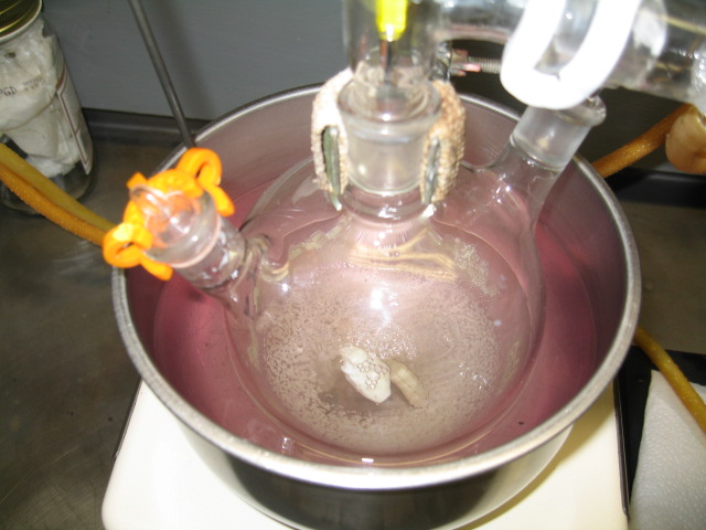

solvent removal from PCl5.JPG - 68kB
Solvent removal from PCl5
PCl5 precipitating during solvent removal.JPG - 71kB

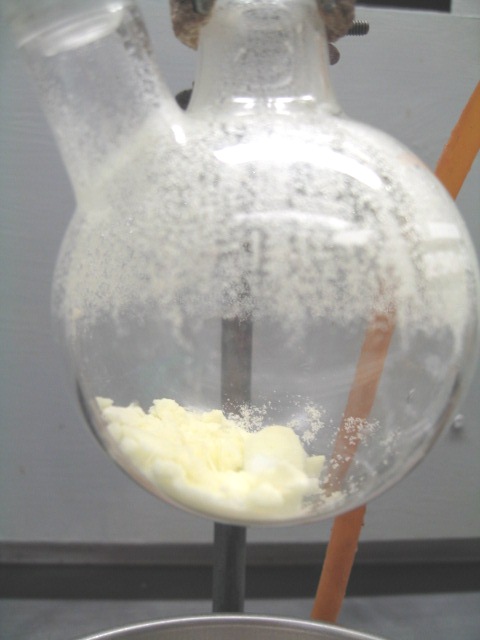

PCl5 (with stirbar) nearly dried.JPG - 63kB
PCl5 (w/stirbar) nearly dried

PCl5 vacuum dried.JPG - 56kB
PCl5 vacuum dried

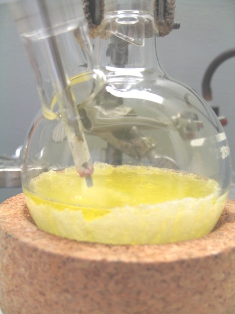

[*] posted on 3-10-2015 at 16:53
Today I finished the conversion of my meager supply of phosphorus to PCl5. 6.3g of P was charged. I used 200 ml of chloroform as solvent in a 500 ml rbf reaction vessel. Yield was 92%. I attribute the losses to: impure P, reaction of dissolved P with O2 in the vapor space, and mechanical losses.
Here's a picture of the PCl5 precipitating as chloroform is being removed by distillation:
1precipitating PCl5.jpg - 94kB
precipitating PCl5

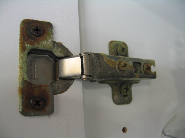

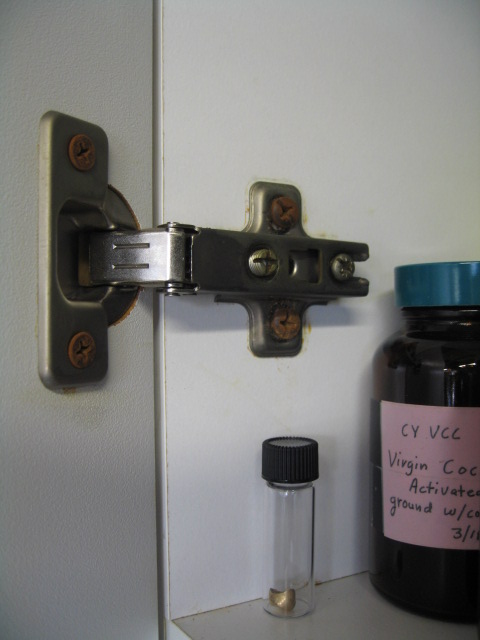

I've had my PCl5 from the 1st batch stored in a widemouth 100ml Quorpak bottle with a ptfe liner in a cabinet. Apparently it has reacted some with ambient humidity and the resulting HCl has corroded the ss hinges as shown here:
corroded ss hinge.jpg - 66kB
corroded hinge
For comparison here is a non-corroded hinge in my main chemical storage closet:
non-corroded hinge.jpg - 70kB
non-corroded hinge
I know - woelen warned me. :( I just finished triple dipping the bottle top in melted paraffin wax. I hope that seals it.
